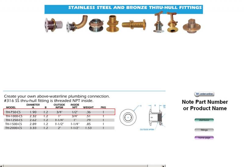

Here's Something ..........................
.................... which may fit your needs.
These are SS thru-hull fittings which have an internal NPT thread. Ideal if you need a quick 90 deg. turn using a brass street ell. Watch your ID's carefully to ensure you have sufficient flow area. If necessary to increase the size, it's a simple matter to use a hole saw to increase the size of hole in your hull.

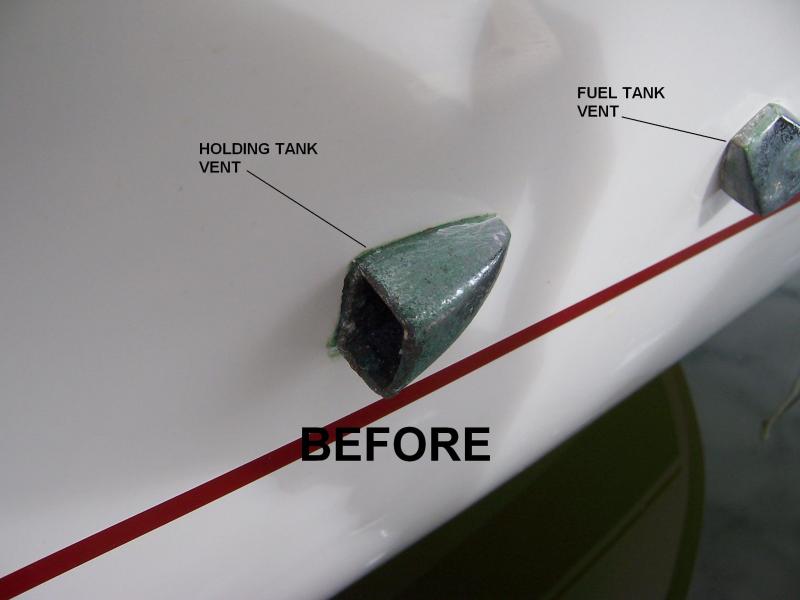

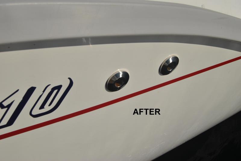

All my original above water thru-hull fittings were chromed brass and they were one holy mess after about five years. I've since replaced all of the brass above water fittings with these SS Groco ones from Defender. Vent lines have a large, high internal loop to prevent sea water ingress.
