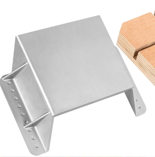

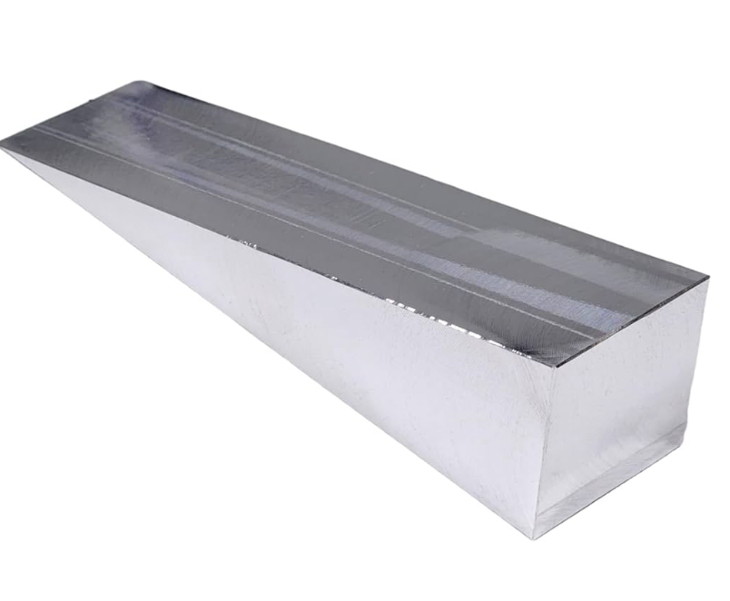

What’s stronger and more solid if a mount, Wedges and have motor jack plate mounting bolts threw wedges and transon, or have built an aluminum angle plate similar to picture below where it would be mounted to transon and then jack plate bolted into it?
Will have either one fabricated, pictures are just so everyone has an idea of what I’m thinking.

That design appears to have been designed and built for a shaft-drive 11 hp diesel. The transom was not engineered for the torque of a cantilevered OB engine. Managing the engine controls would be quite difficult, also.
Your post seems to assume that an OB motor should be on that transom. At about 7500# (plus) in sailing condition, that is not a boat really suitable for an OB aux.

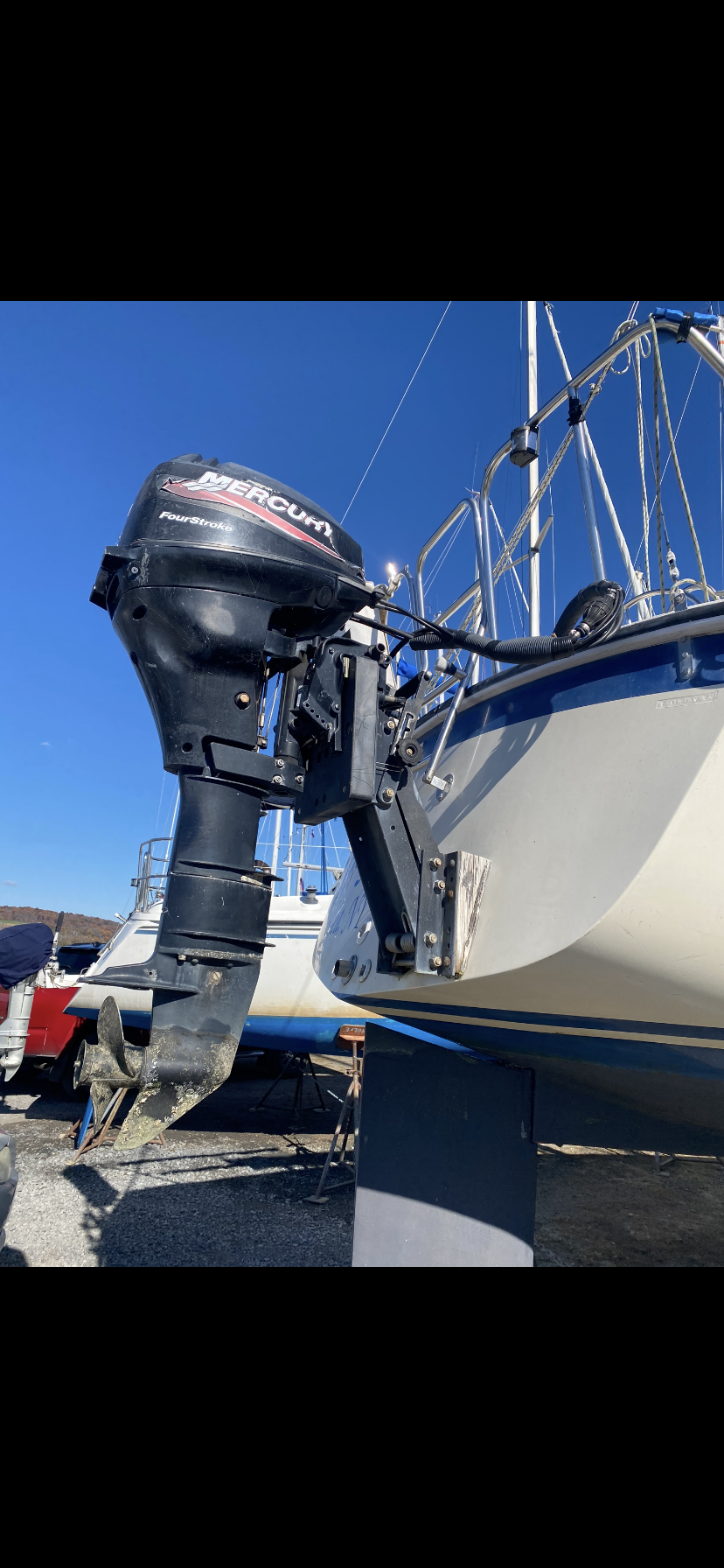

Yes, that’s correct. Since 2004 that boat gas run on the set up in the picture, it’s a 15hp Mercury, the Yamaha 9.9 hp high thrust will push boat just has easy, the new bracket from bobs is actually a kicker jack with 16” vertical travel commonly used for trolling on bigger power boats, anyway I’m just trying to figure out if wedges or something like in the picture. Old jack was a manual panther with wedges made out Of 2x4, has lasted 20 years, new jack is hydraulic but lighter motor

This new jack has 16” travel, throttle and gear controls are at padestal, boat has outboard since 2094 but set up was on wood wedges made out of 2x4, replacing the panther with bobs it’s just so instead of pulling motor up by hand I will do it with the push of a bottom.

Assuming your O'Day 28 is similar to my 25...
That wedge is a huge help in getting the motor low enough into the water while allowing it to be tilted without hitting the transom. I did not have it on mine and I was unable to get it out of the water. It's too low and heavy for a spring loaded mount to be useful. I have also considered a jack plate.
In order for my outboard to have adequate control, I had to get the motor as close as possible to the waterline. When motoring, the wood on the mount would catch quite a bit of water as the stern squated.
