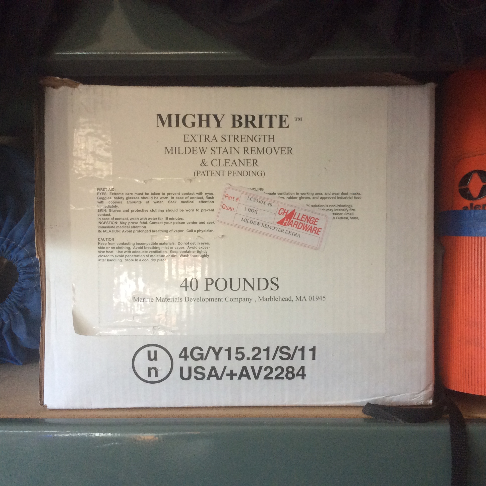

This is what I use to clean sails. It's called CS-530, and it's sold in 40 pound boxes by Challenge Sailcloth through their distributor network. They do not sell it directly to the public. I'm a distributor. If anybody wants to buy a whole box, I can order it for you, but I'm not in the business of selling it for profit or of cleaning sails. It's about $200 per box, plus shipping.
You might order a box and then have a sail cleaning party. (^;
It works really well to remove mildew, blood and other organic stains, but not rust (metalic stains) or grease. It will not harm dacron, nylon spinnakers, acrylic (sunbrella like), and laminates. It doesn't damage adhesives in the laminate nor the exotic fibers.
Nothing will make a horribly yellowed or stained dacron sail look like new, but CS-530 does a good job of making most dirty sails look whiter.
It's available only in 40 pound boxes, which is enough to clean quite a few dacron sails, and almost as many laminate sails. It takes about 12 pounds to clean 3 dacron, nylon, etc sails from a 35 foot boat. It takes about double that concentration for laminates. You can reuse the solution a couple of times. You can use it in an inflatable kiddy pool, bath tube, galvanized tube, etc. It takes a couple of hours to clean dacron sails, and overnight for laminates.

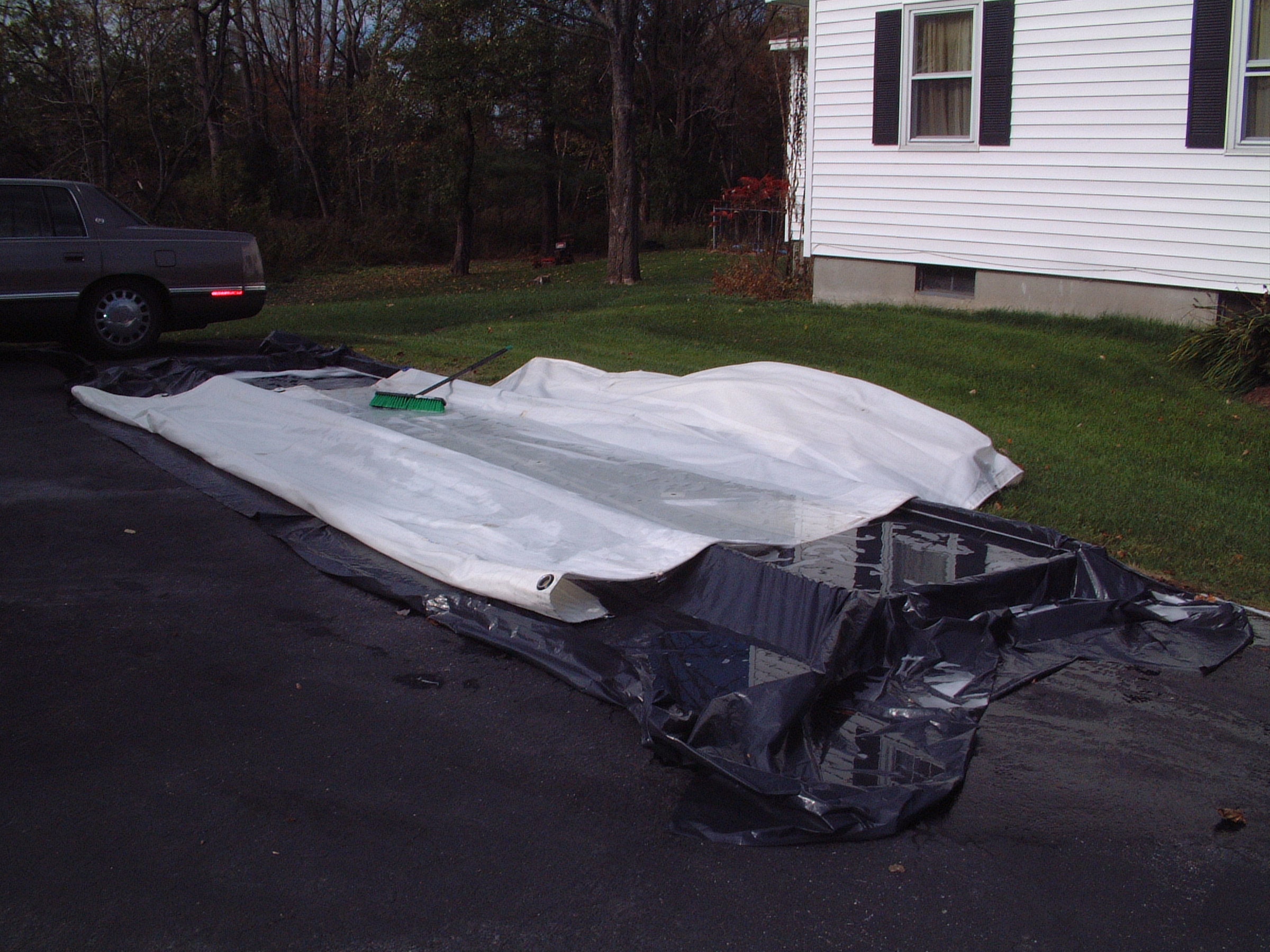

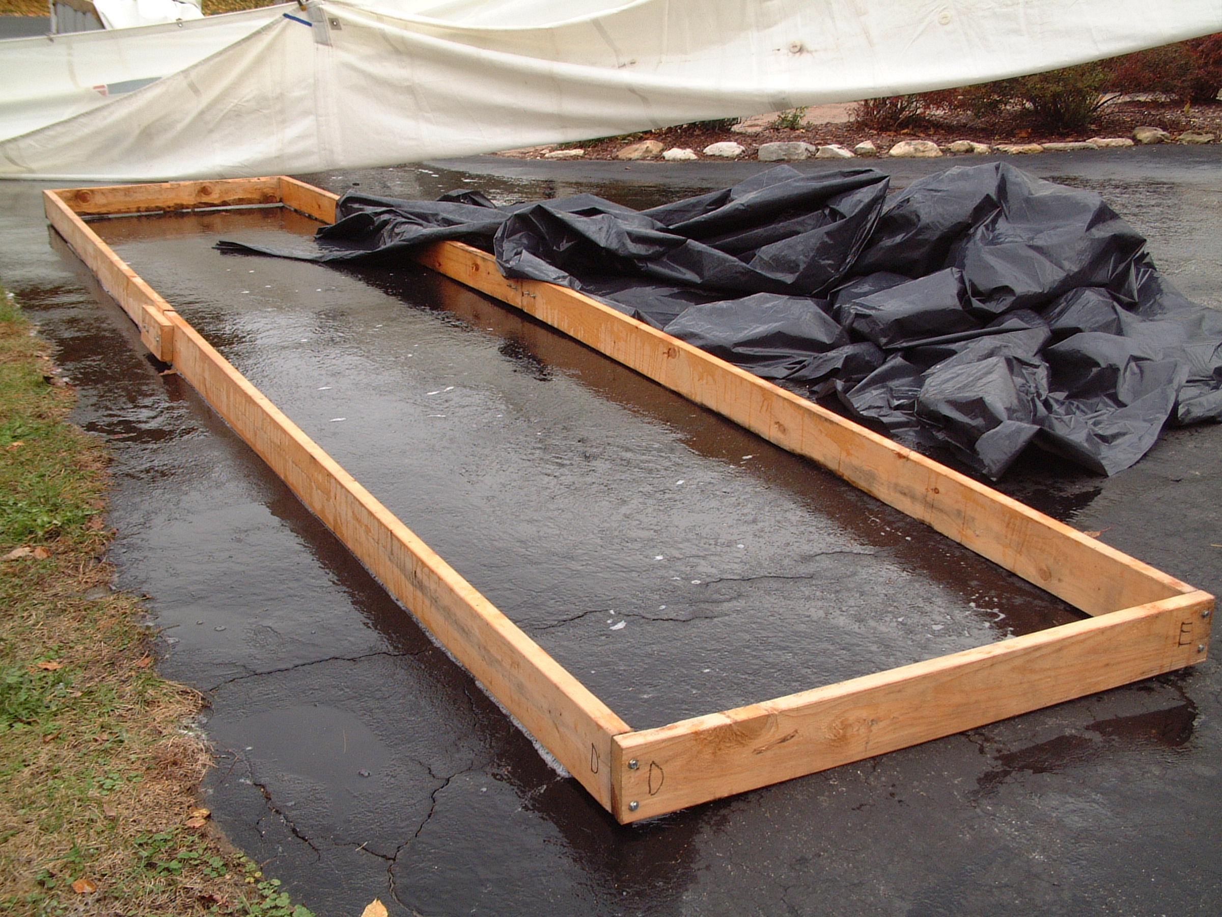

This may not be the best way, but here is what I have done in the past:
I bought five 8-foot 2x4's and built a frame that is 16' by 4'. I place it on a relatively level spot on the edge of my driveway and lay a piece of plastic sheeting into it.I fill with water and add a few squirts of Joy dish-washing liquid. I lay out the flaked sail along the trough and unfold a section at a time and put it into the water. I scrub gently with a long-handled soft brush and then pull the clean section out onto the lawn.I flip the sail over and repeat on the other side. Then I drag the sail onto the lawn, spread it out and rinse with a hose on both sides. Let dry and then fold. I do need to blow off a few grass clippings.
