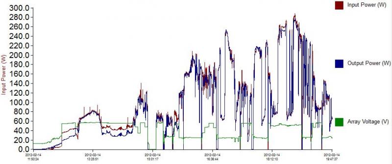

Today we oriented the boat so that the stern faced North which causes shading by wind generator and radar radome. The day was partly cloudy which really confused the results as clouds passed in front of the sun. In the graph you an see when it's in parallel or series by looking at the array voltage. Also the transitions are indicated by the power dropping to zero. Can anyone make sense of it?
Pete
23,140
Pete, great information, but without knowing when you changed from parallel to series, how can we help?

On average it appears parallel is yielding more power, and your controller is efficient.
Thanks. I tend to agree. I need to repeat the test under clear sky since the partly cloudy condition really obscured things.

It looks as if today parallel beat series in terms of current to the bank. Of course this is impossible to confirm without more data gathering sich as Ah's returned during series & parallel time frames. From my experience it all depends on the type of shade, coverage and where you panel maker placed the bypass diodes etc. etc..
Keep testing and you'll eventually find what performs best on your installation. I've not yet found the ultimate answer for the series/parallel conundrum. Tomorrow series could win, just the way solar rolls sometimes..

Thanks. Yes, I agree. I'll keep testing and hopefully get a clear sky day before long to better distinguish the differences. Did you happen to notice the voltage steps near the center of time line while in series mode? Apparently strings were cutting in and out leading to several different discrete steps; interesting to see it in real life!
