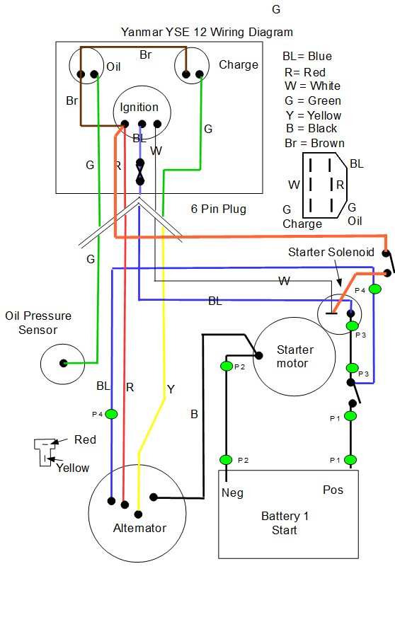

Hi Jviss
Re your original question.
What do you all think is the best tool for drawing boat schematics? Something free or cheap, maybe? Any basic drawing program will do the job.
I use the Open Office drawing. It is free
Not sophisticated but does the job.
I did this drawing "as fitted".
Gary

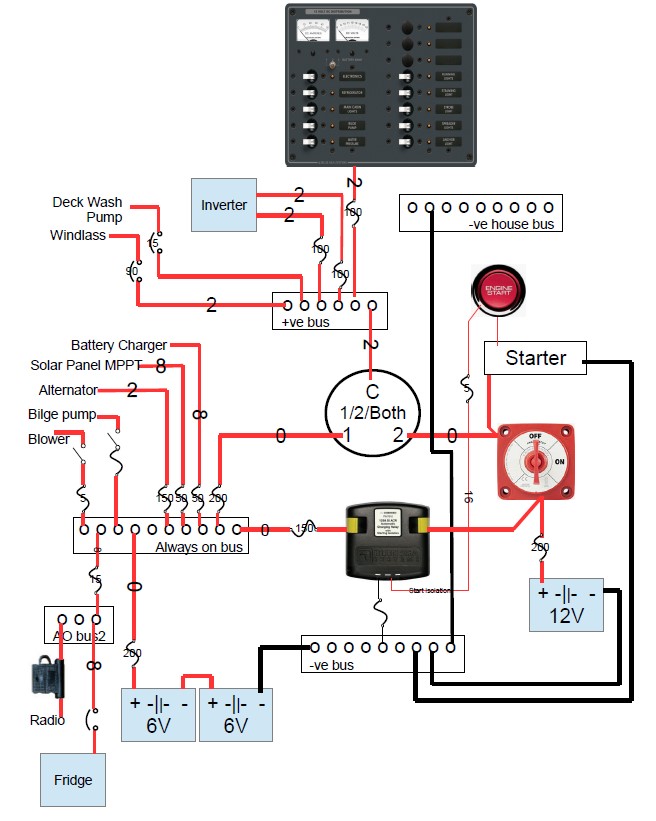

I second Open Office Draw for basic wiring diagrams. I made this one of my DC power system using Draw:

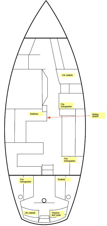

You can also use is for plan views, I traced the outline of my boat from a brochure using lines and arcs, and made layers for plumbing, engine, safety...:

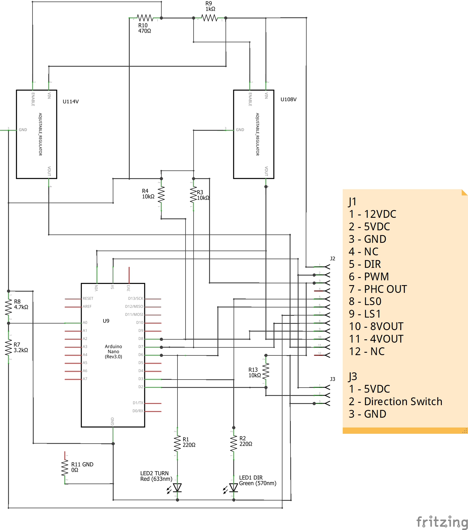

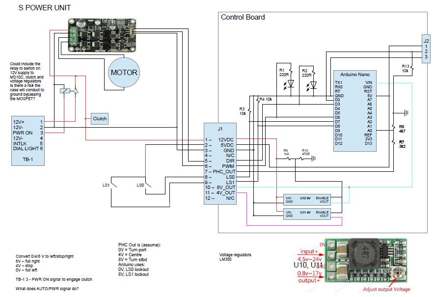

I also used Draw to lay out the rebuild of my autopilot power unit control board that failed:

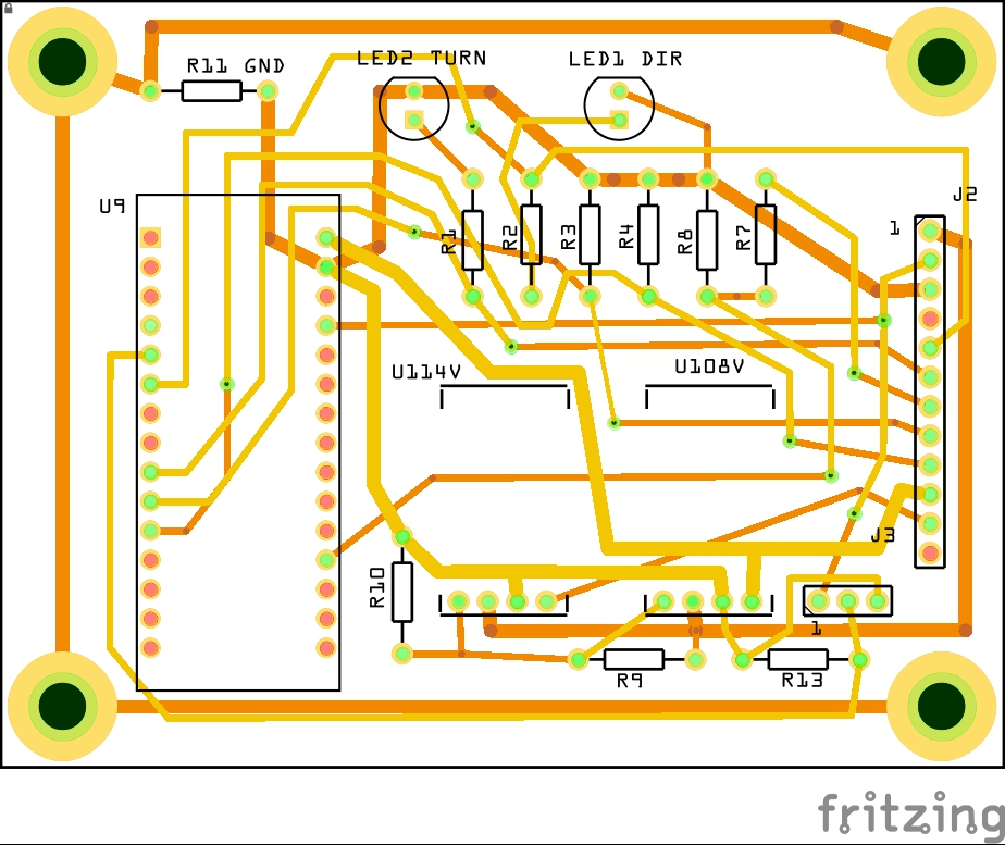

I then used Fritzing (a free circuit design program) to create the schematic and board layout for the control board:
