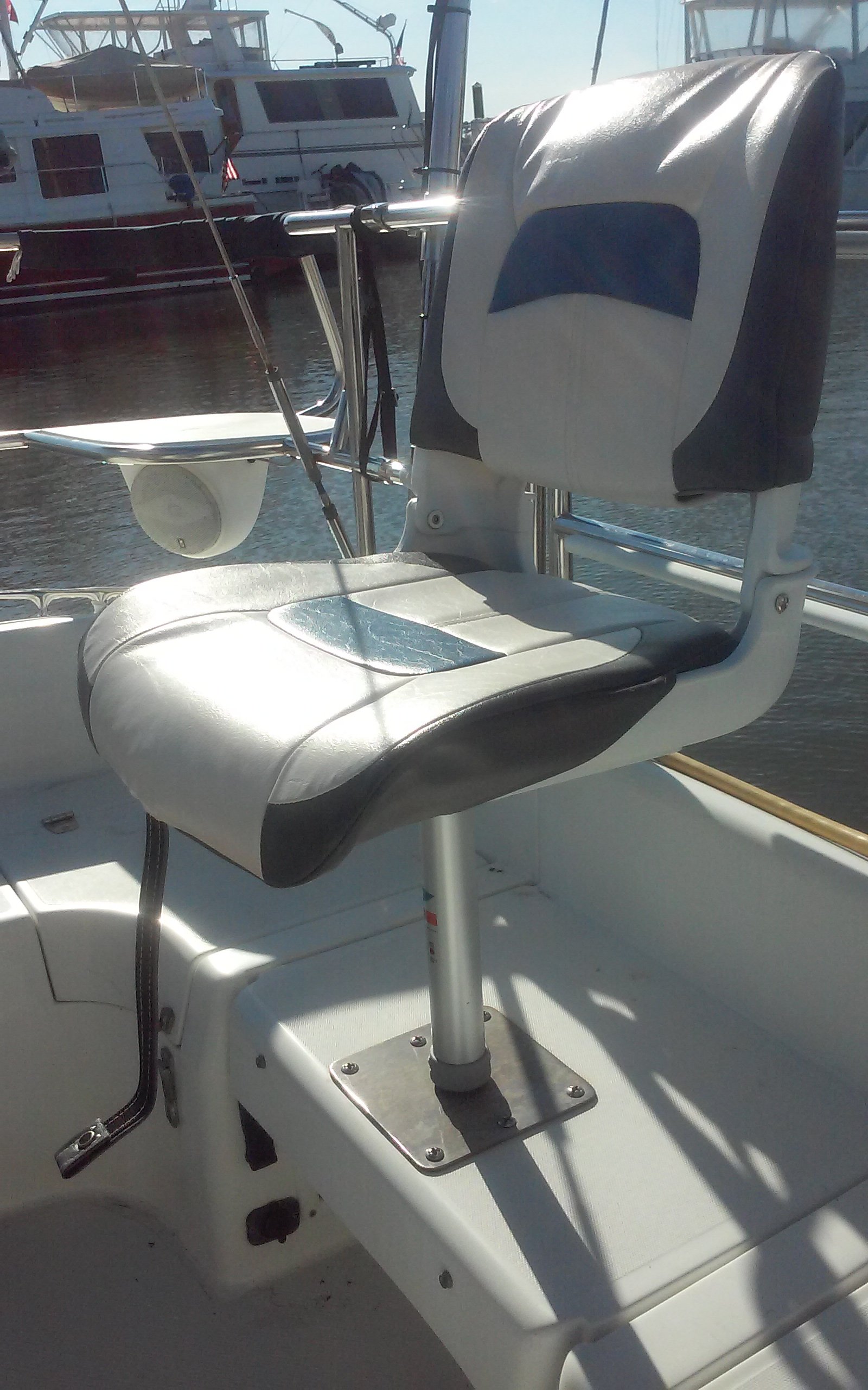

Any chance of some photos of the Helm seats you put in. I'm looking at doing the same.

Picture is attached. Went with the "high end" seat and Outdoor World Marine hardware from Bass Pro. Used a starboard backing plate for the base but not really sure that was necessay because the fiberglass is pretty thick and strong there. Biggest trick to get the right height for the post so that your able to see while seated. They have adjustable posts but i went with a screw-in nonadjustable and it took me two tries to get the correct height. Total cost was $125. Well worth it - love the seat!

Nice looking seat, but I'm really curious - where (or on what) do you put your feet?

Thanks Cat 310 #1 looks good. I'm going try and set mine up so I can remove it so I can get access to the ladder and transom.
SFS ....... CAT 310 uses Harley cruising pedals ......... lol.

SFS - I am 6 ft tall so my feet touch the base below the chair. But I usually swing from one side to the other and rest my dogs on the seats on either side while leaning back in the chair. Key is to mount the seat as far forward as possible so you can swivel it without hitting the stern rail. Mine does this fine. But I do remove the chair when using the stern ladder to access the dinghy.

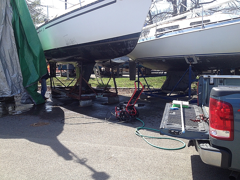

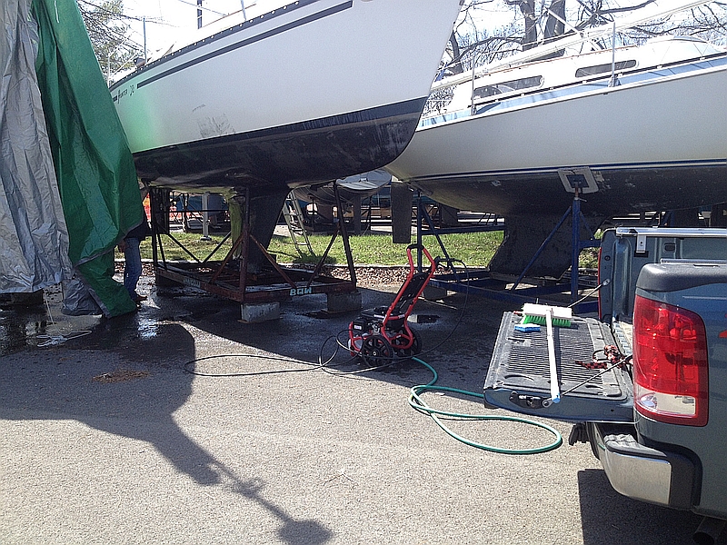

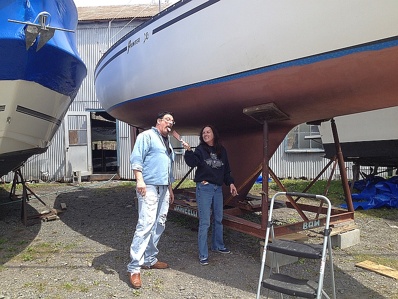

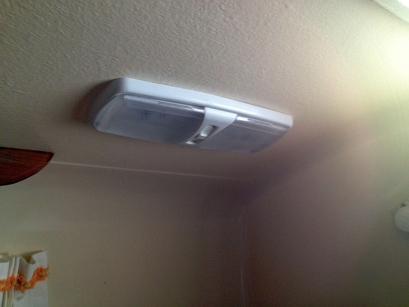

We only had a few simple projects like replacing all the running rigging, and some decorative work. My favorite and most rewarding projects were install all new LED cabin light fixtures, clean the hull, and VC-17M the hull.
Lot's more planned for new season in 2017, like upgrades to nav lights, mast wiring, port-light replacements, and anti-skid topside paint.
