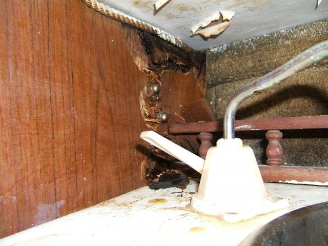

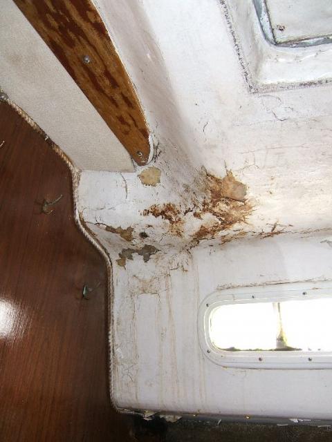

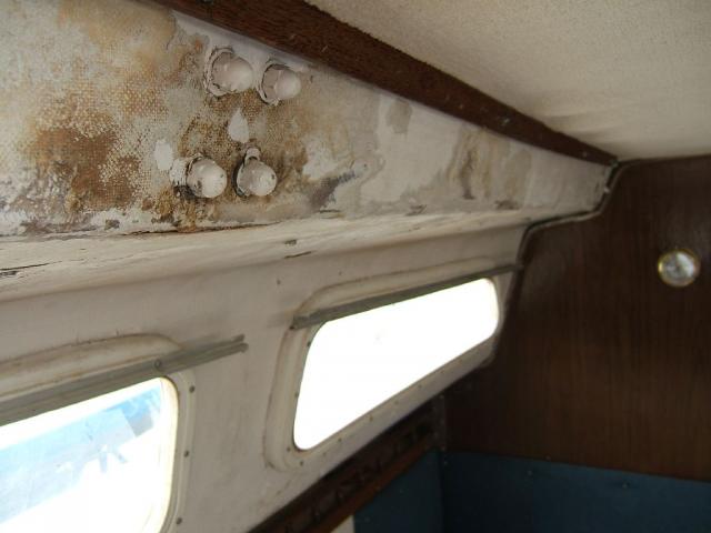

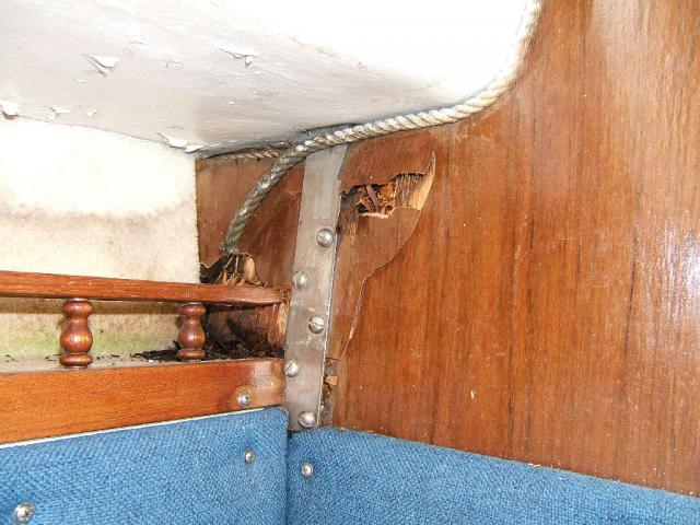

NO MATTER WHAT BOAT YOU HAD BOUGHT- there was work that was gonna be needed to be done. The soft core around the chainplates is common, and easy to fix. Don't be afraid even if you've never worked with epoxy and glass before- the worst thing that can happen is you screw it up, and a good grinding and sanding will erase that mistake! Just make sure you get to solid wood before filling. There are alot of posts in the archives that describe it well, even with pics.

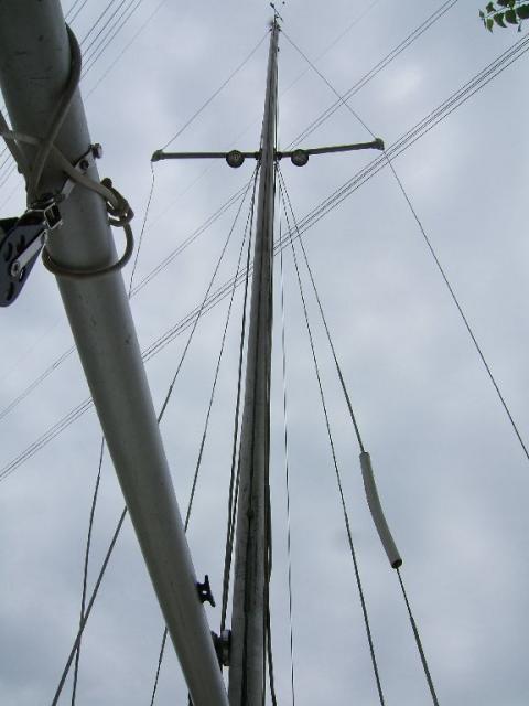

Putting a sleeve over the dent in the mast is not an option- it is an absolute necessity. It won't be expensive, unless you don't do it. replacing a failed mast IS costly, and that's before we talk about damage to the rest of the boat and it's occupants!
