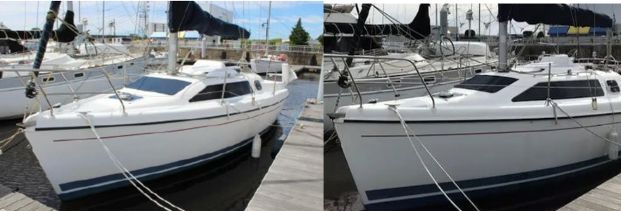

If you do an internet search on "Hunter 280 sailboat vent images" you will find a 1999 (left) and 1996 (right) Hunter 280 and others with a solar vent installed in the forward hatch.

Thanks. I’ve come to the same conclusion--install one on the fore hatch. Lewmar makes a pretty nice one that can be retro-fitted for Bomar hatches (which Hunter used for the 280s).
