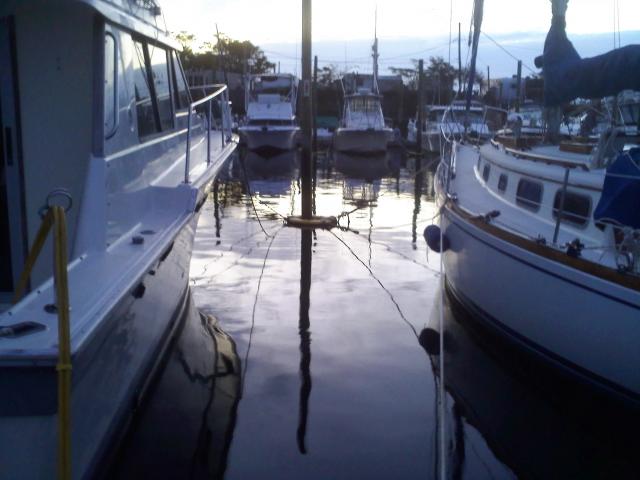

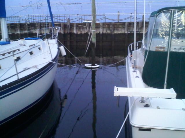

Much Simpler version
The product I was referring to was much simpler. Please excuse the blury picture but wanted to show that even a power boater can share :D
Seriously - it was called the Charlie-O-Ring and they stopped making them last year. I've had it on my boat for over ten years.
