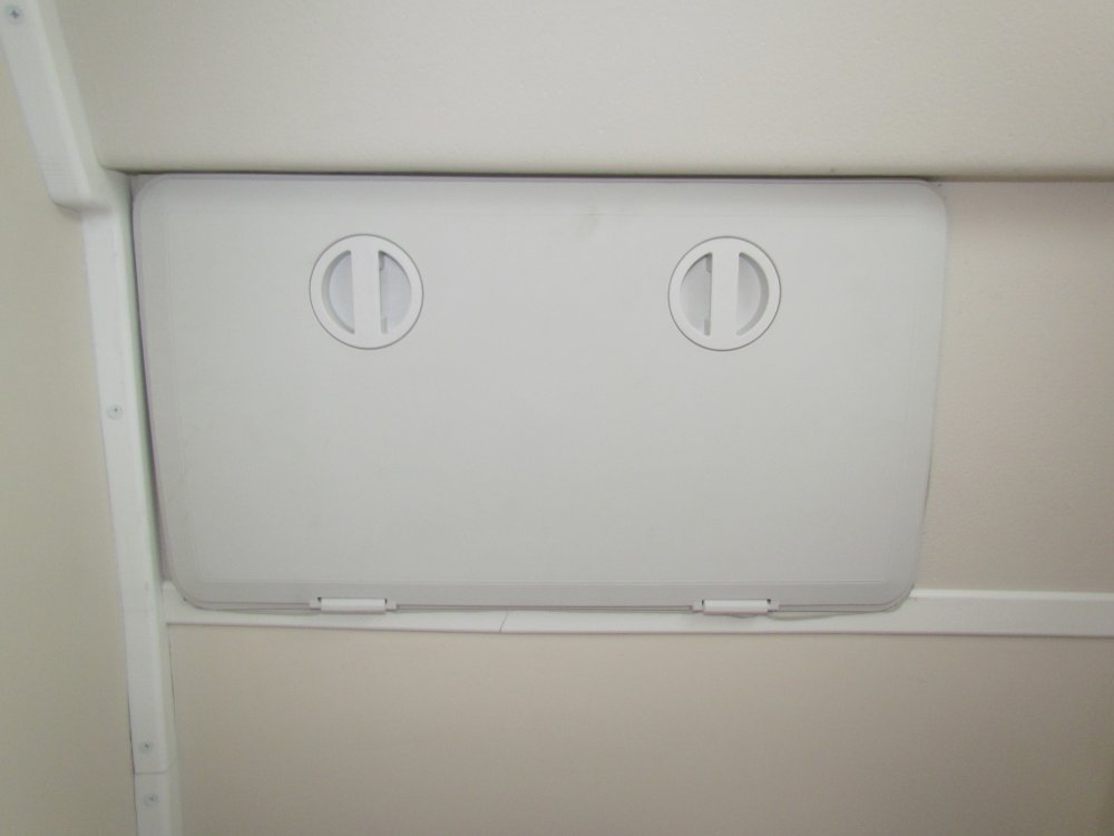

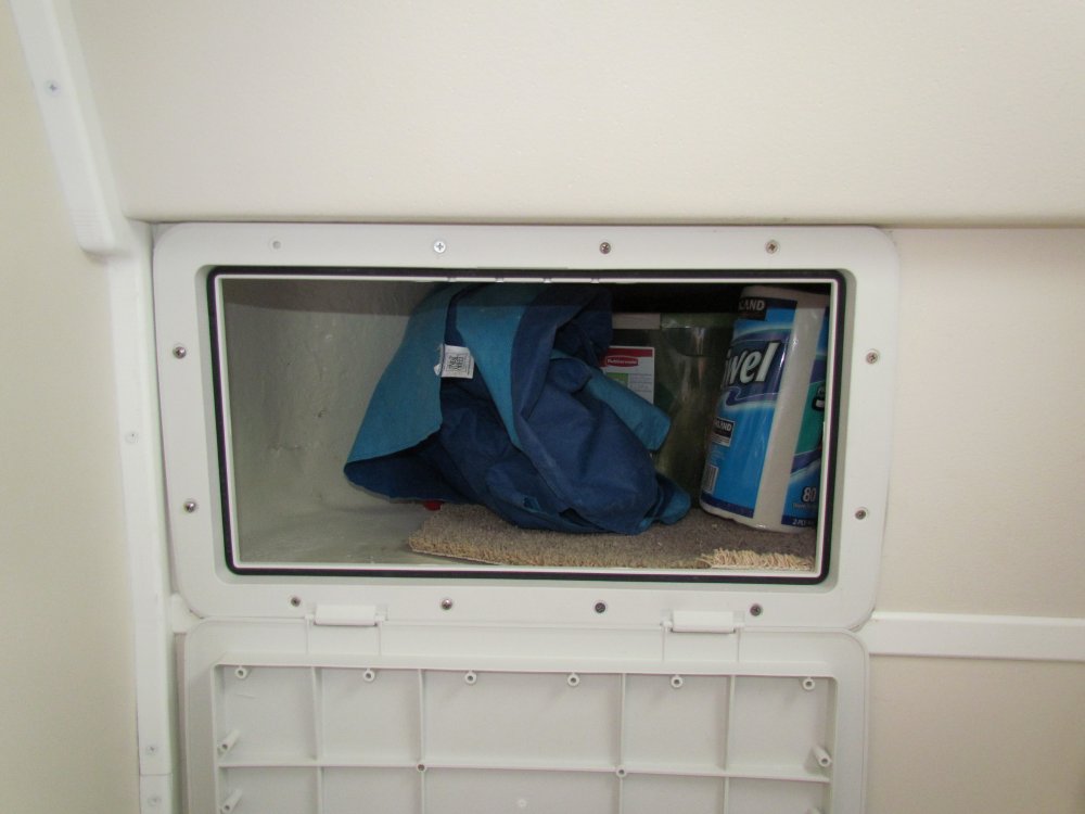

I know we are still in sailing season but I wanted to throw this topic out!
At this point we have done more than one Best Modification!

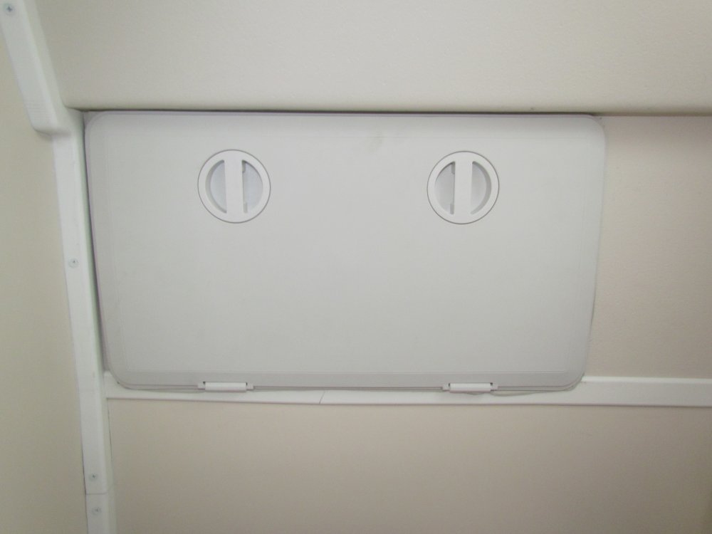

1st would be the Access Hatch from the head into the port side lazarette
2nd would be putting a spring hold open latch onto the dry storage hatch in the galley
3rd would be the voltmeter showing state of battery charge.

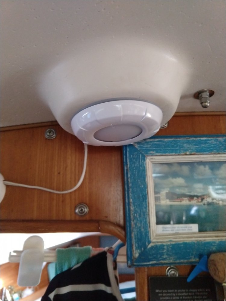

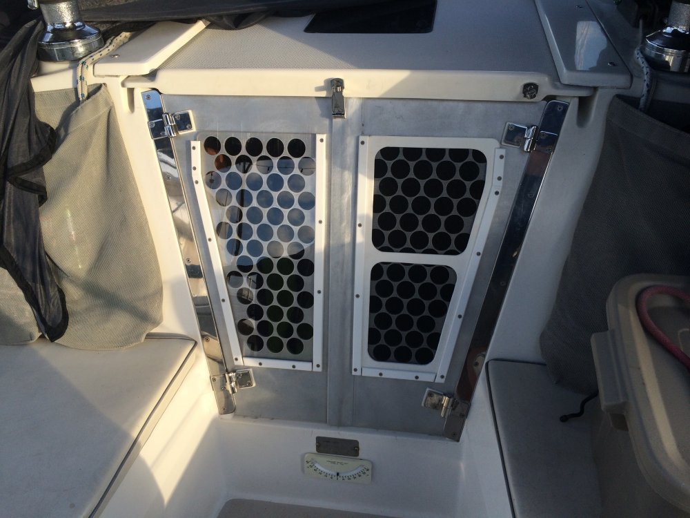

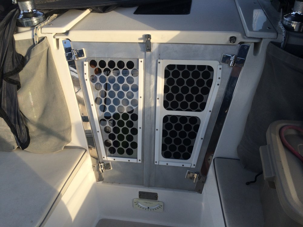

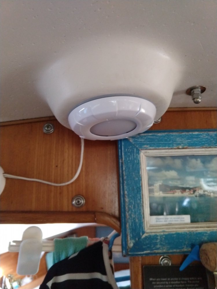

In terms of day to day usage two items come up. First removing the factory table and building a new table along the bulkhead with draws for food storage. I don't have a great picture of it but you can see it in the picture i uploaded. Next would be our aluminum companion way doors with both plexi and screen inserts. Makes it so much easier to get in and out. I copied the Zarcor doors but did them out of 1/4-inch aluminum so they would be slight and strong. An honorable mention would go to the new lights. Much better than the Catalina stock fish eyes. These are LED in both white and blue and dimmable.

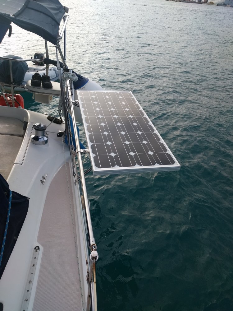

From a live-ability prospective, solar hands down. We run lots of power and almost never worry about charging our bank. We have 500 watts and may even slightly increase this soon. The watermaker really helps with this too.

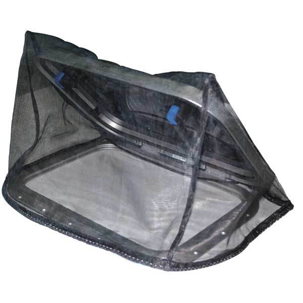

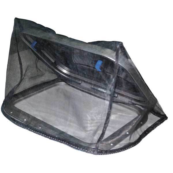

Not a modification, but an addition.
As simple as the V-Berth Hatch screen. The PO put sticky Velcro on the inside and simply used a square of door screen needless to say, it started peeling and turning yellow/brown and was nasty. This design goes on deck and allows you to pop your head out of the hatch to see what's going on around the boat. Easy on, easy off. Basically a screen with fishing weights sewn into the bottom edge. Picked it up online for $5, and it came with a carrying case!

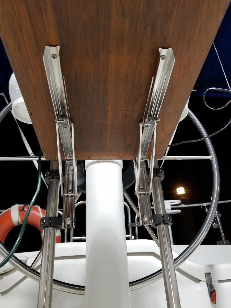

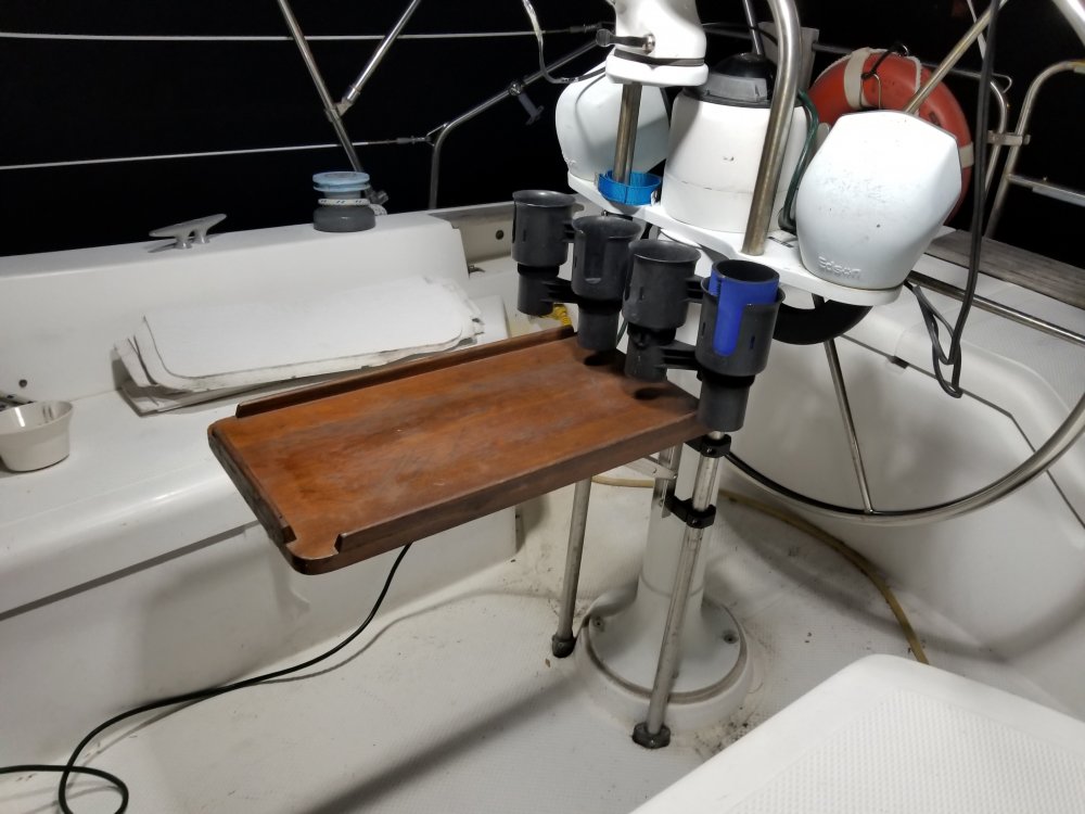

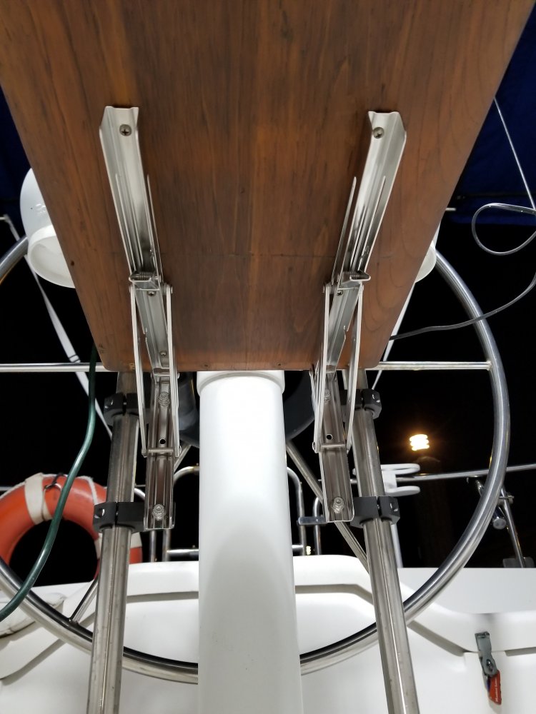

New cockpit table hinges

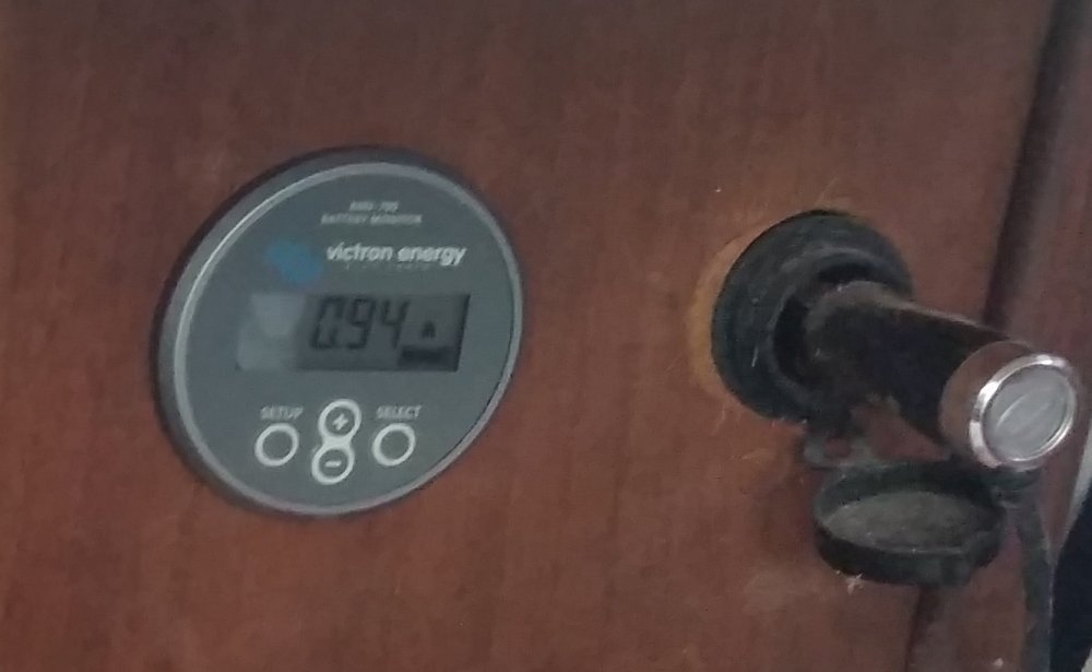

Victron Battery Monitor

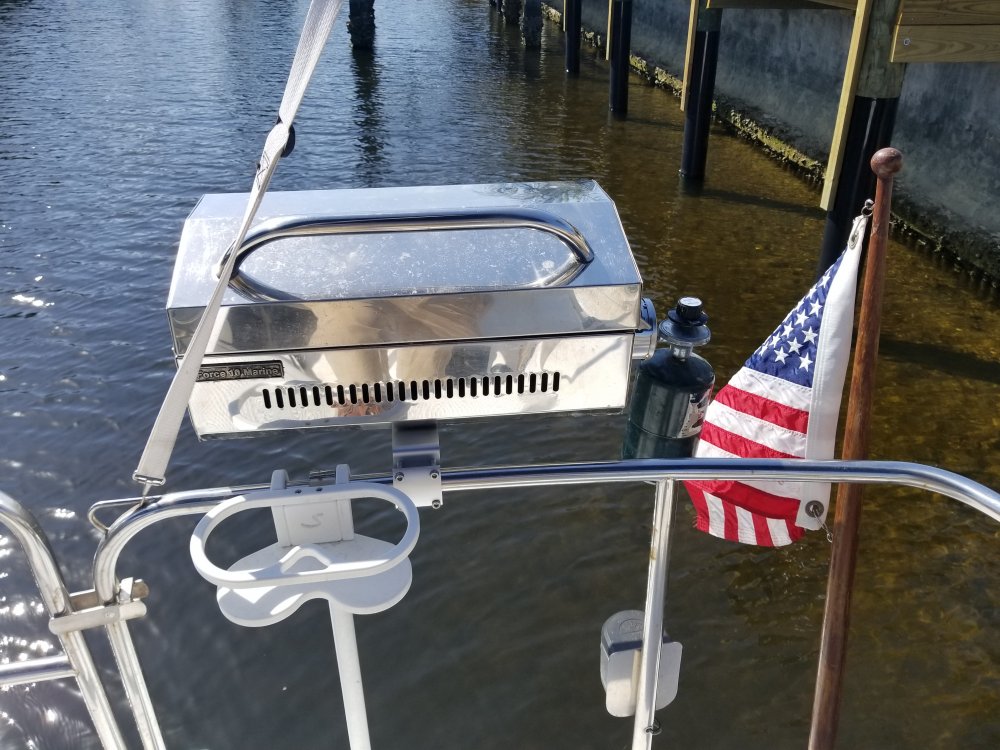

Barbecue

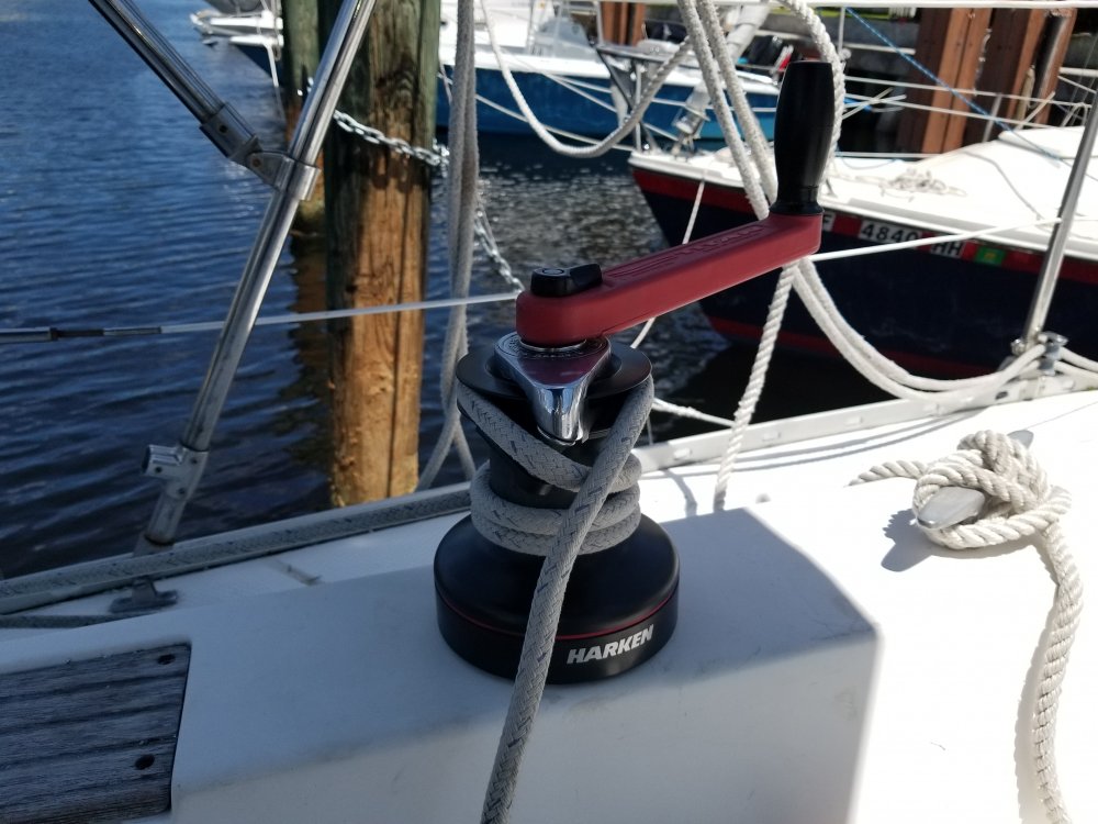

New Self Tailing Winches

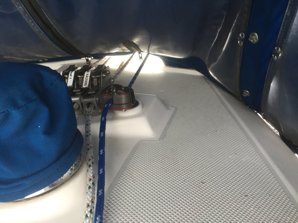

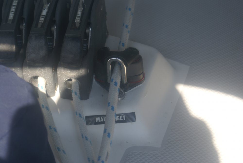

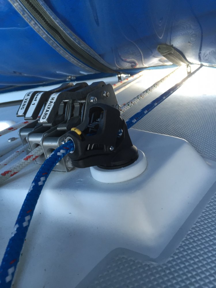

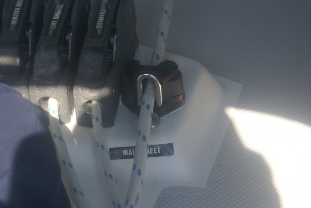

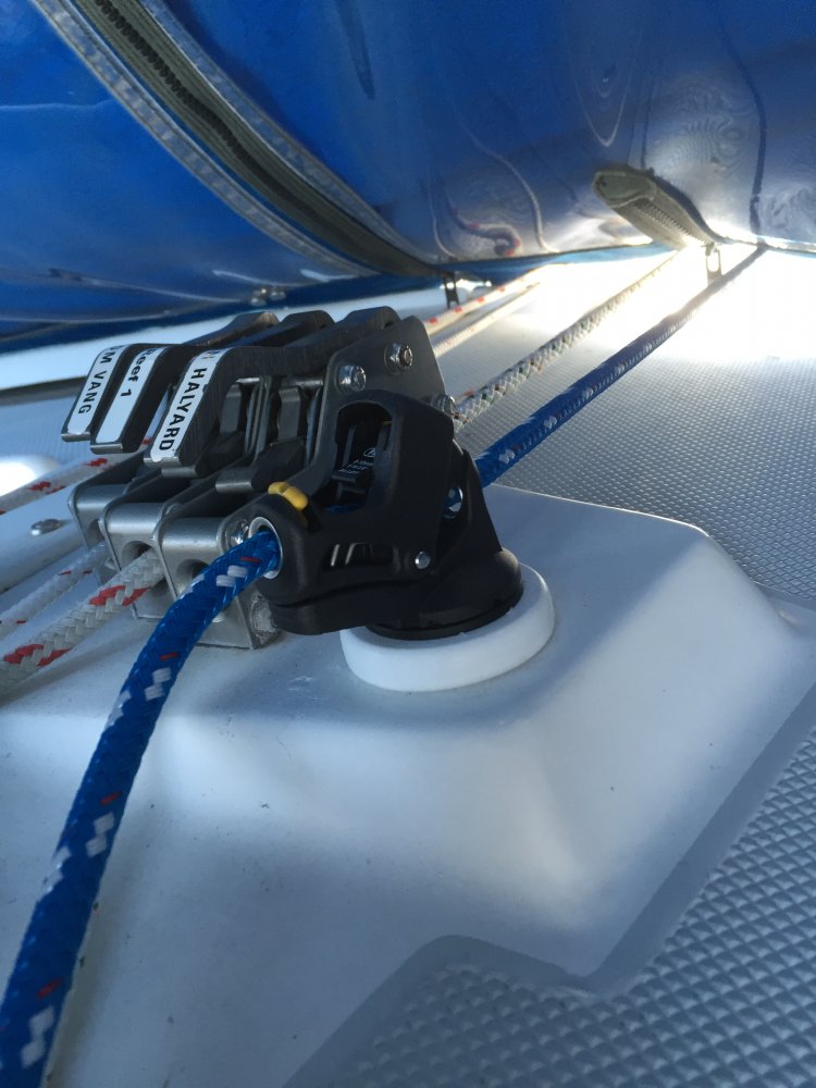

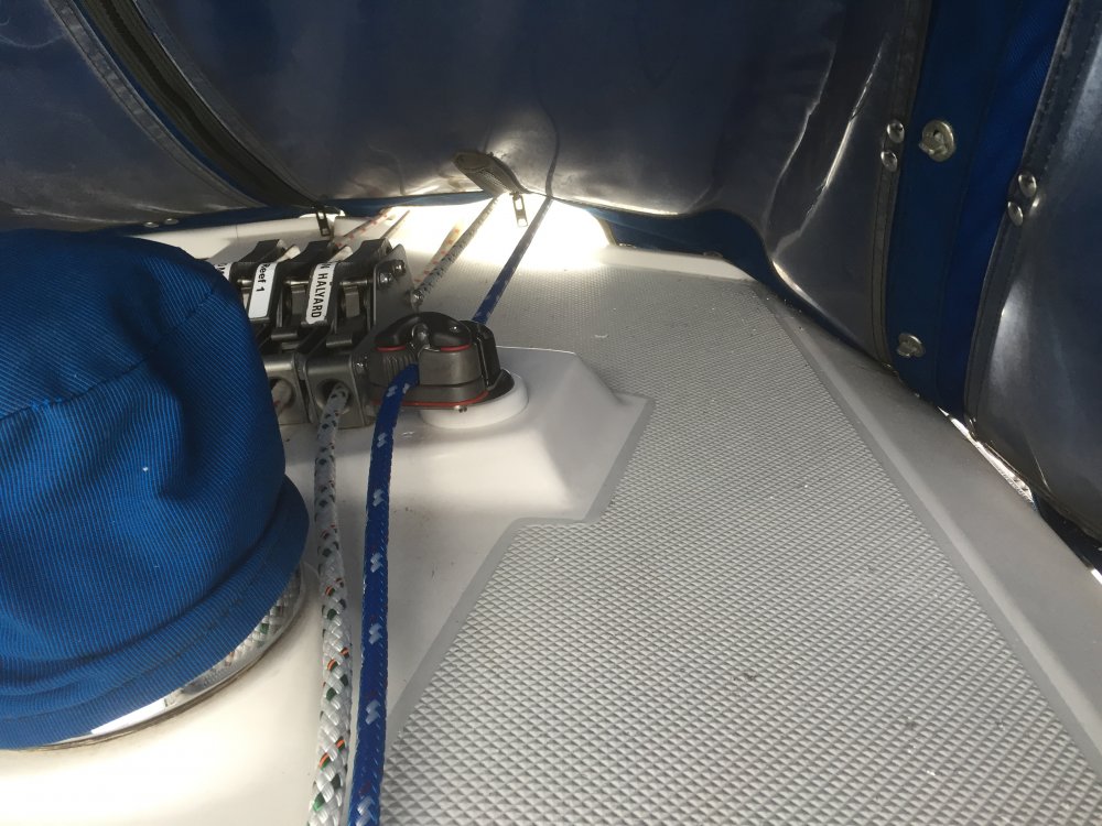

We started with a Harken swivel cam cleat, but switched to a Spinlock cleat for our mainsheet. Easier to release than the Harken. There was an aluminum plate to drill and tap into. Very easy. Actually, my rigger did it, but he said it would have been easy for me to do.
We also had him lead the traveler control lines under the dodger to Harken swivel cam cleats. No more reaching under the dodger to adjust the traveler. One of the best sail handling mods we've done on this boat.
24,593
@marchem Rob that looks like a great modification. Any issue of chafe on the underside of the dodger. Seems like a great place to sew on a length of leather on the bottom of the dodger.

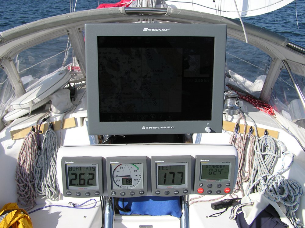

Most useful modifications for me:
- Replaced sanitation hoses with PVC tubing + fresh water flush (no smell, period)
- Permanent electric heater installation with external thermostat (convenience)
- Moved chart plotter/radar under the dodger (best location)

Haven't noticed any issues. The lead for the mainsheet is pretty much the same as with the original (crappy) clam cleat. The traveler control lines lead from the organizer on the traveler, so they don't have an issue either. I wish I had a picture of how that works. I'll try to take one this weekend.

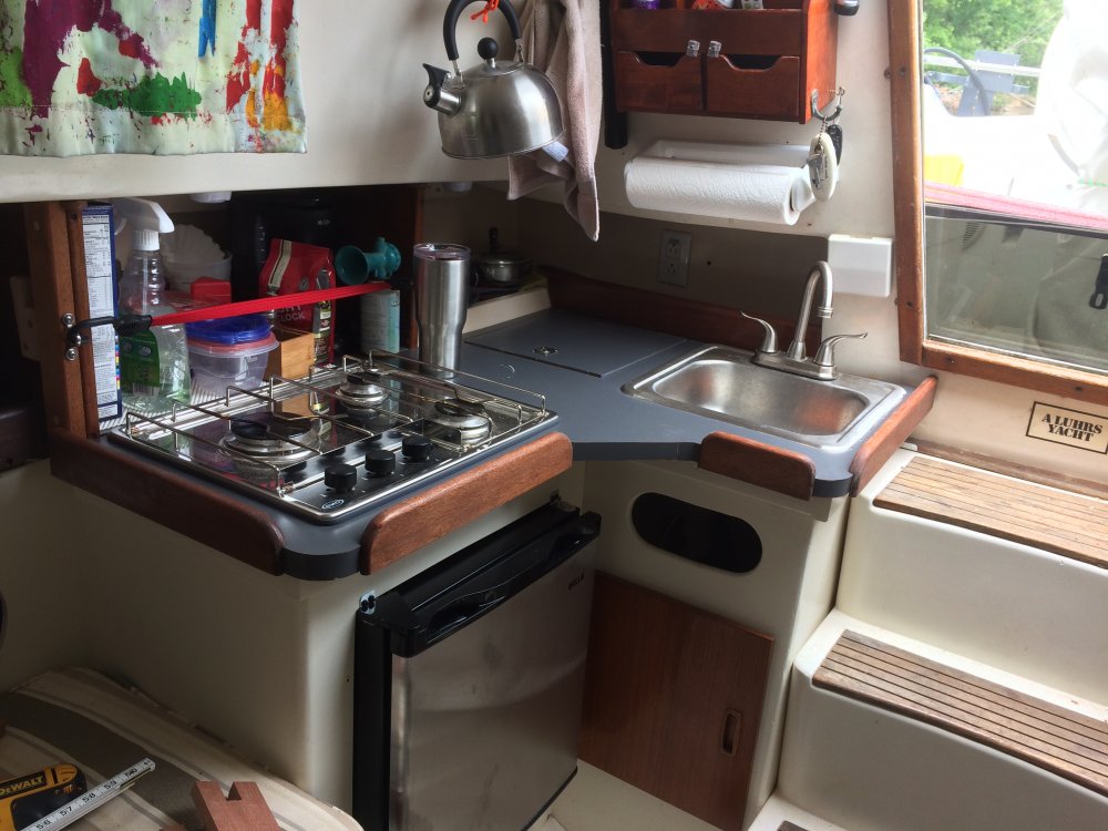

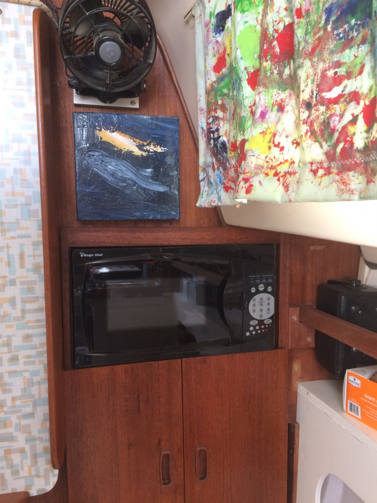

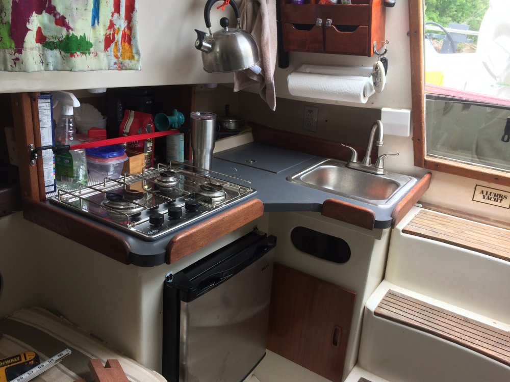

Over the last 3 yrs:
2 Solar panels and controller
8 Golf car batteries
2 60A chargers (yes, overkill)

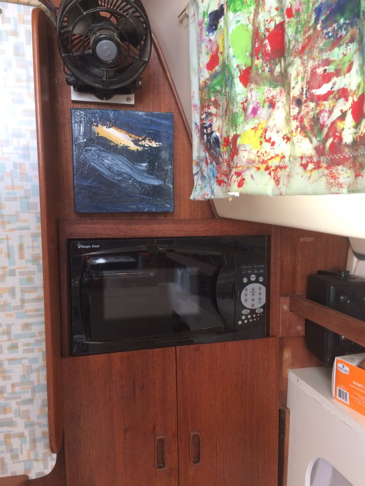

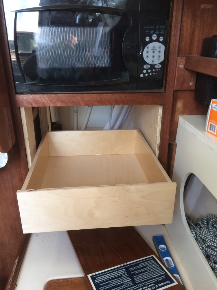

microwave and drawers install
traveler, autopilot, mfd, propane stove and system, 1.6 cu ft refrigerator, 1800W pure sine wave inverter, air conditioner, new wind sensor, speed/depth/temp transducer, all new sanitation hoses upgrading to 1" vent lines, bow roller, replaced all lighting with led, installed TV antenna and 18"tv, new ac/dc distribution panel and wiring to all devices,and a lot of other things I'm sure I've forgotten.
Currently milling and finishing new shelf fiddles
Whew!! I'm tired...
