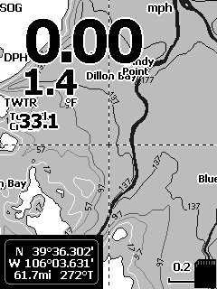

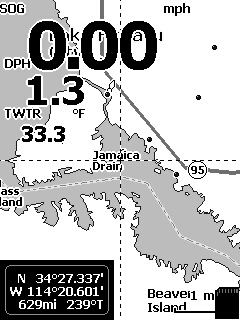

A couple things on the Lowrance.. these have an anchor alarm and one thing I tried recently was to see what the current draw on mine was when I turned down the display brightness. When I’m on the map screen with full brightness, the smaller ones like I have (Mark 4 and Elite 4) draw about 160 ma. If I’m using this for an anchor alarm, it would be inside the boat cabin and I would turn the display brightness way down. When I did this, I measured about 110 ma. So leaving this on all night would draw about 1 amp hour. I suspect you would not get that low with the larger model but possibly close.
Also, these models have a micro SD card slot. If you try to buy one at about any store, you can only find micro SDHC cards and they do not work - it must be just a micro SD (no HC). The micro SD card only goes up to 2 G and I was only able to find them online - ordered two for about $8. The main reason I got the card was to save screen shots and on mine, the screen shot came in a little lower resolution than I wanted but overall adequate. Attached are a couple screen shots. On mine, you just press two buttons in sequence to get the screen shot.
