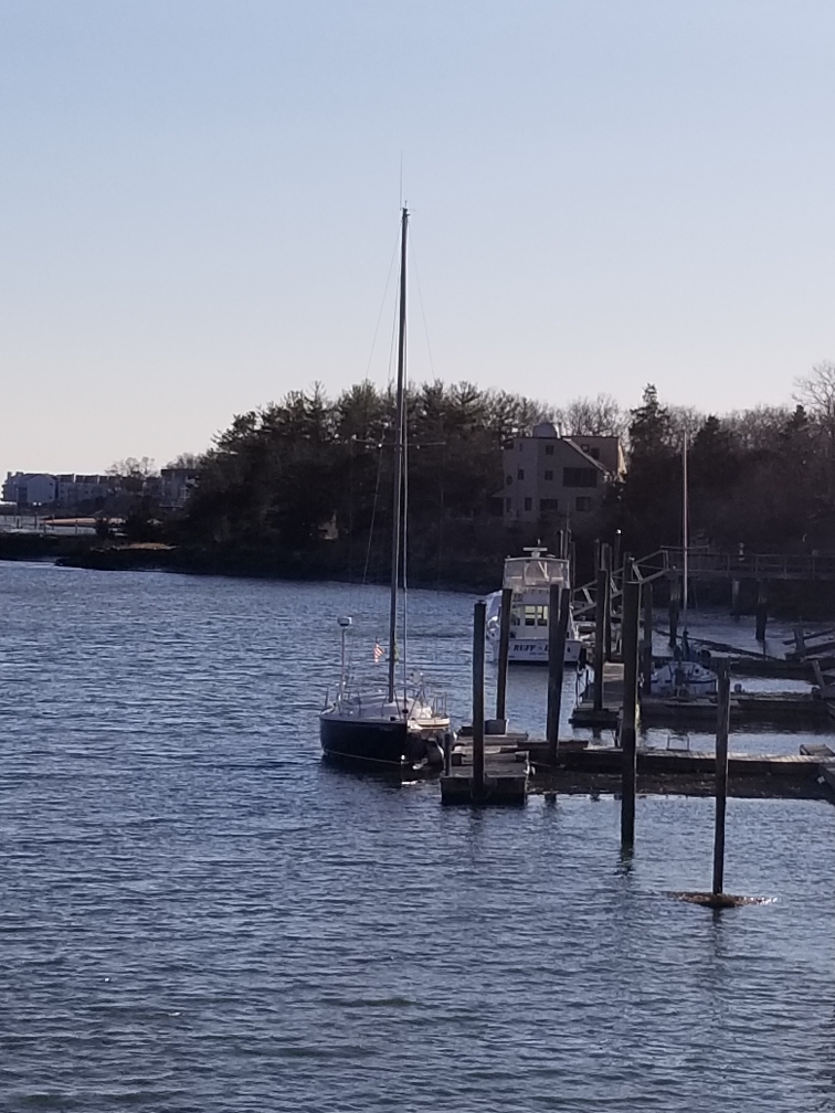

Wish everyone a fantastic season and best of health. i'm a novice sailor that recently became aware that the previous owner of Luchi a lifelong sailor and rigger has no clue what the dimensions on the 150% genoa are. i don't know and wonder if i could replace the now shredded genoa with a 36ft. luff 135% genoa. i sail on Long Island Sound and wind is almost always there, for me. Because i don't have sailing friends i have always sailed alone and prefer a jib i can work my self. Luchi is a 1976 Catalina 30 tall rig. i was somewhat intimidated by that when i first saw it but the sailor convinced me that i could sail without help. Now i need a jib so i can get my skills up. Are furler tracks universal? It's also my first furler experience, i hoisted the sails on the O'day 25, my first boat. Are the beads for furling genoas/jibs the same size? If it is on a Harken furler can it be used on a Seafurl? i apologise for not using nautical terms properly, thank you

Thank you, i am looking at a jib for 475$. The seller does list it under genoa but no %. i figured my novice self can handle a 115% on the LIS. i don't think i know what you mean by 'backwinded', i apologise, only sail alone and am not nautical term savvy. Yea, the O'day 25 was a great boat, learned to sail on it.

Hello, thanks for your replies. What i meant is the bead in the luff tape that goes into the furler track , the previous owner referred to it as bead. It's my first furler and it's a Seafurl 810. The mast is not centered properly and don't know if i did something or i didn't notice it when bought.

Yes, it needs tuning, the PO told me to rock the halyard. i am disappointed with myself for giving him the benefit of the doubt and believed him when he said it only needed maintenance, ready to sail. The shore power outlet on deck is burnt and the Seafurl is missing a part (rope splitter) which he accidentally lost to the depths when showing me how to install genoa on the furler. Fortunately i met a couple of sailors that invited me aboard to go sailing. The marina doesn't permit fueling at the dock, first time for me, every marina i've stayed in permits it. Frustrating because the price at a fuel dock is almost twice as much. When i lived on the O'day life was affordable, this joint is making it expensive. Thanks for the replies.
