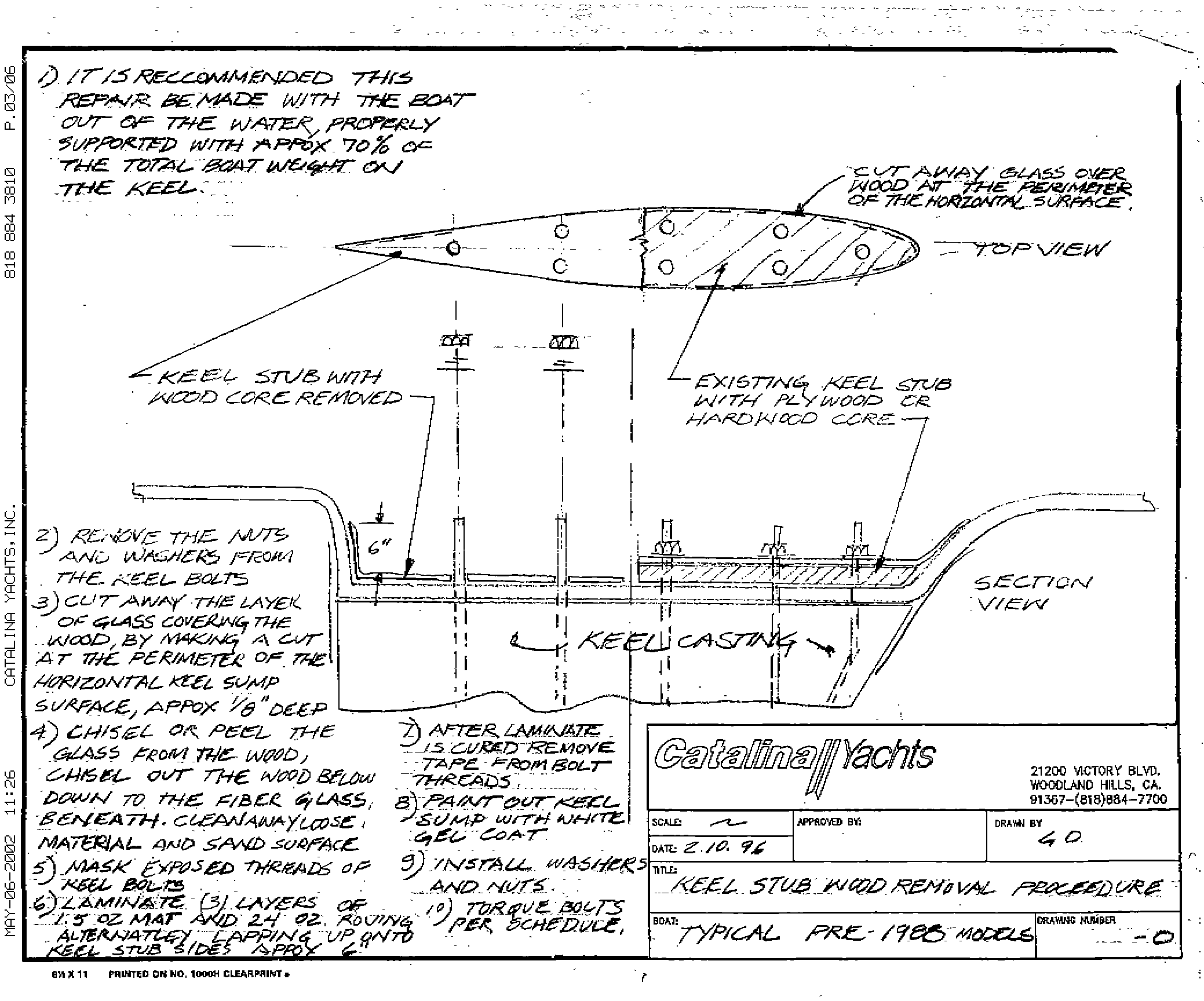

Hi, it's time to buy the materials for my keel core repair. I need epoxy resin, 24oz roving and 1.5oz chopped.
I find a quite a range of costs on-line, depending on brands/sources.
Is there a suggested brand and source that is recommended ? Is there any advantage to more expensive materials and if so, what is it ? My work is structural.
Thank you !

I'm replacing the wood core from my keel stub, and have to lay glass on the base of the keel stub and up the sides.
After much consideration, my final plan is 5 layers 1708 (45 degree biaxial 17oz with 3/4 oz mat backer ) to give flexibility to go up the sides of the bilge, and then I'm going to put in 5 layers of 1808 ( 90 degree biaxial with 3/4 oz backer) just over the base. Probably way overkill, but while I'm at it I'd rather be sure. As it will be cool, I'm going with fast hardener for the epoxy, but will do some trials before in the garage before starting work on the boat.
Only question left is how to lay it. I'm thinking to do the 5 layers of 1708 at one time, let that set up and then clean the blush, sand a little and go to the the 1808.
Or, should I do all 10 at once ?
(The cloth will all be cut ahead of time, including the holes for the keel bolts.)
Thanks for the advice...
