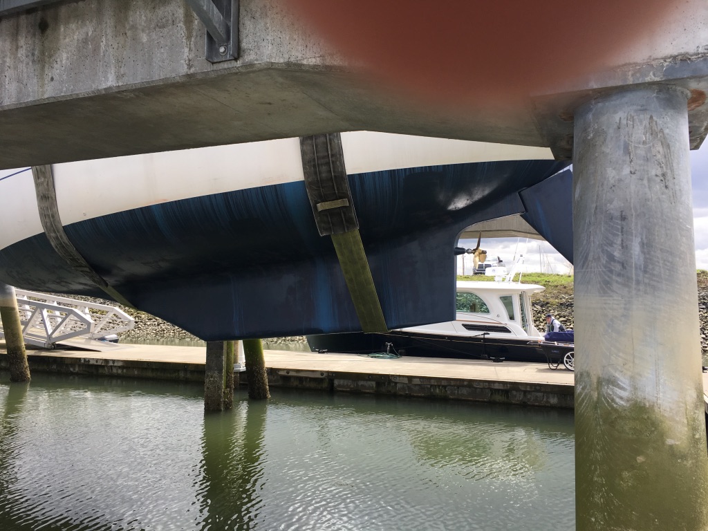

I used Petitt Trinidad Dark blue in March 2018. Here she is in the slings being splashed.
My boat sits in the tidal brackish waters of the Everett Marina Basin24/7/365. The marina is influenced by the tidal waters of Posession Sound and the fresh river water of the Snohomish River.

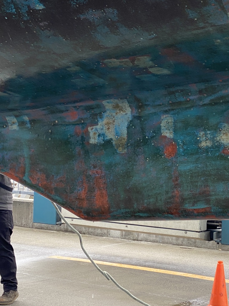

Here is what her bottom paint looked like when I had her hauled 04 FEB 2023.
I have the bottom cleaned by a diver every 4-5 months.
Hadley had her bottom cleaned, blisters addressed with resin and barrier coat, Sanded and painted with 2 coats of Petitt Trinidad, this time in black.
She was splashed 5 April 2023. I am hoping to get similar performance results.

Fst - what's your take on how gracefully Trinidad wears over time with maintenance cleaning? From @jssailem's pictures, it looks like the paint wore away very evenly in a way that sanding for the next coat would be really reasonable. Some sources state that hard bottom paints require a lot of work when it comes time to remove them, but I'm suspecting that this only applies to cheap paints. @jssailem mentioned that the yard took everything back to bare fiberglass for blister repair, but assuming the blisters weren't there, would a light sand and recoat work?
24,926
@American_Mainsail ,
“@jssailem mentioned that the yard took everything back to bare fiberglass for blister repair,”
Is not quite right.
My underlaid color was red. Red was applied in 2014 before I bought the boat. In 2018 the red was sanded using 80grit. 2 coats of Blue Pettit Trinidad were applied.
That is what you see in the image from 2023. Wear shows on the leading edges. Yes I believe the wear was fairly even.
In 2023 the boat was sanded to expose the red layer. Again noticeable blister were sanded to under lying hull glass.The blister was covered with thickened epoxy to fill the area exposed. The hull was washed, Sanded to fair the hull. 2 coats of barrier coat paint applied to the areas of blister repair and allowed to harden. The boat hull was again washed, sanded to provide a suitable surface for bottom paint. Then 2 coats of Pettit Trinidad was applied. The leading edges of keel and rudder were given a third coat from the left over of the 2 gallons of paint.
