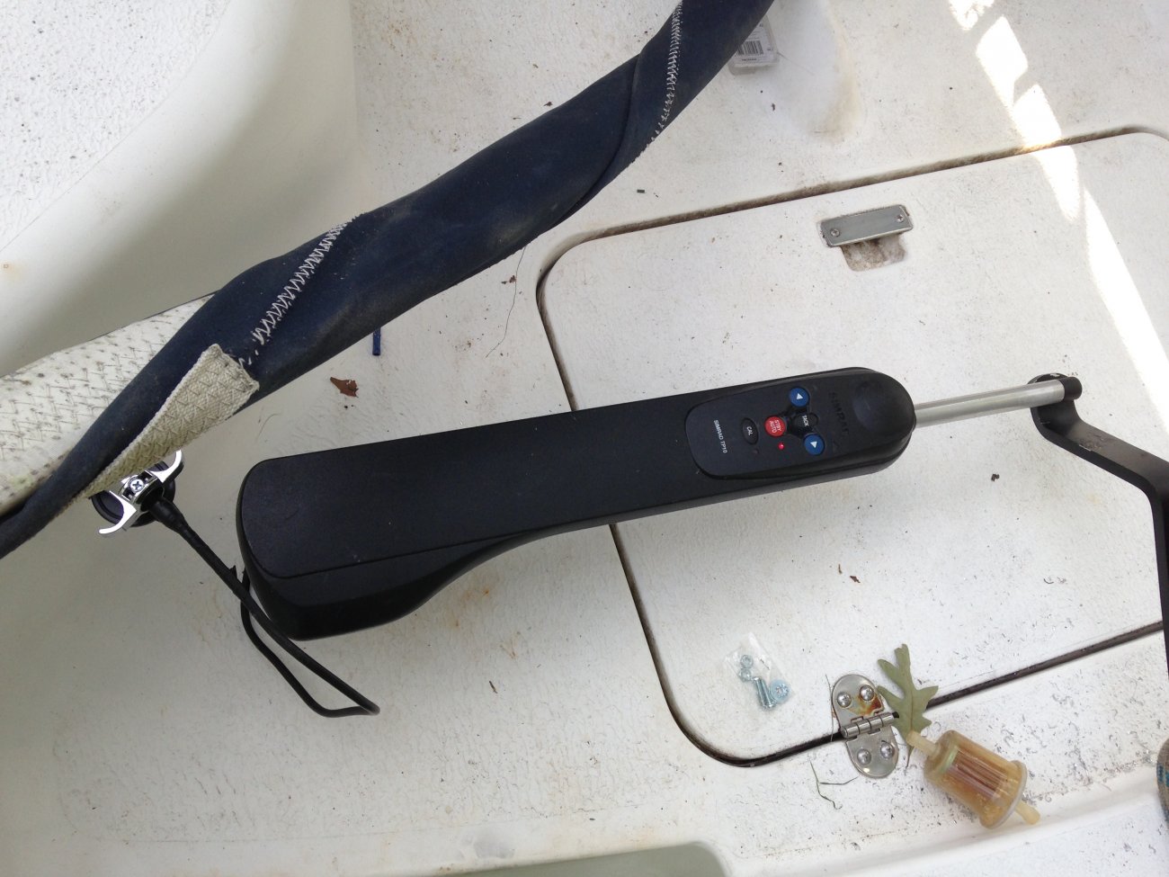

I got a TP10 off of eBay for about $100 and put it on my Hunter 26. It was not a hard job. Here is a pic of the installed unit. It is very simple and intuitive to use.
Keep your eye on eBay and you can find a used tiller pilot for a good price.

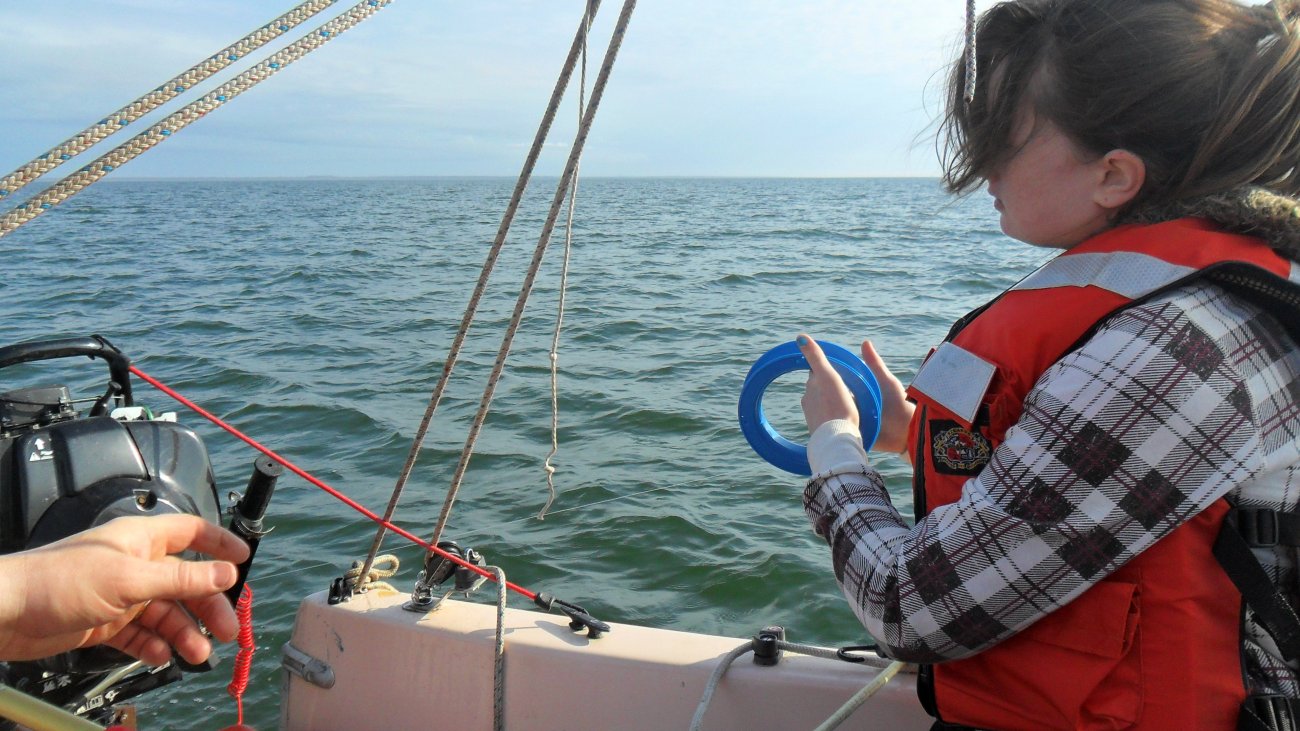

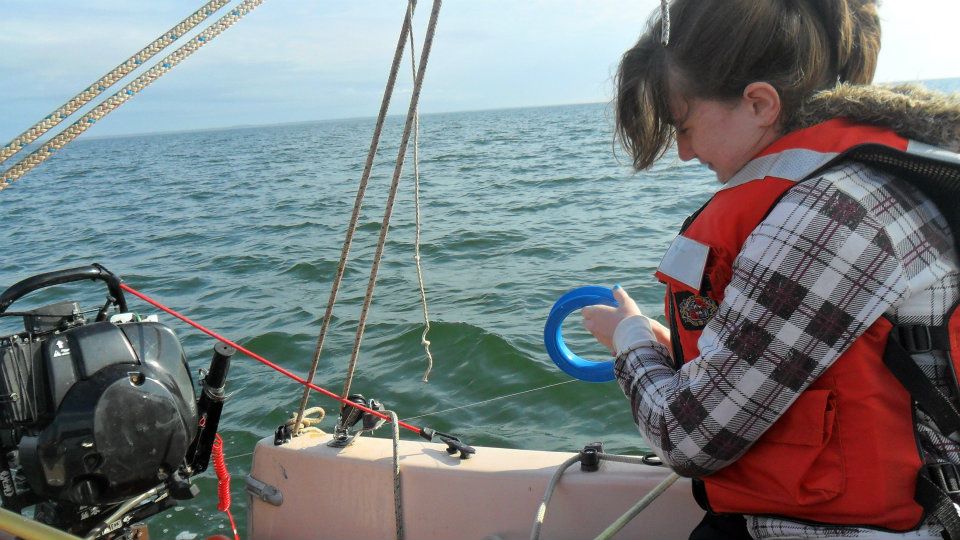

@letlmt have you ever played with sheet to tiller self steering? I have used it on a MacGregor 22 and sailed a 5 hour course across the Pamlico sound without touching the tiller. My daughters and I spent the time fishing and reading. Here is a pic (sort of). Actually all you can see in the pic is my daughter NOT holding the tiller but you can see part of the counter balance line that leads from the leeward rail back to the tiller.
If you have a spare block lying about, some bungees and some light line, it costs nothing to set one up. If you are interested, do the google thing for (sheet to tiller self steering). You will find all kinds of diagrams and video clips. It is very easy and kind of fun to play with.
