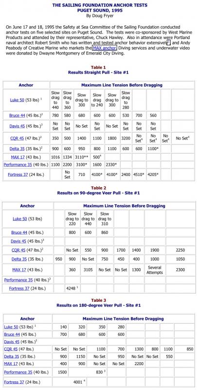

We have exhibited at the US Sailboat show in Annapolis for the past 15 years or so and this has given us a great opportunity to talk firsthand with sailors who regularly anchor in the local area.
First and foremost, sizing up to a larger anchor than a manufacturer's standard recommendation for your boat is wise, since the soft mud bottoms in the Chesapeake Bay insure that the holding power will be dramatically reduced for ANY type of anchor.
Further still, the thunderstorms which come howling through the Bay with 30-40 knot winds insure that your anchor and technique are going to be challenged, so be sure to also have as much scope out as possible to keep a good horizontal pull on your anchor.
Regarding our anchor's performance during a wind or tidal shift, we contend that a well-buried Fortress anchor, with its massive twin fluke surface area, is not more likely to break free than another anchor type in this situation.
That said, although the Fortress anchor is sharpened and tapered for deep penetration capability into a sea bottom, many sailboats simply do not have the engine power to "power set" and back down hard enough to deeply bury the larger Fortress, which will help insure that it will not break free in a veering situation.
This issue is obviously more evident in a harder bottom type (hard clay), but less in a softer bottom (soft mud).
Evidence of a Fortress anchor's ability to handle a wind shift once properly buried can be found in the Sailing Foundation's anchor tests (summary attached) in which they conducted straight, 90 degree, and 180 degree pulls. Once the much lighter Fortress was buried at over 4,000+ lbs of load, it did not break free in the 90 degree and 180 degree pulls when subjected to additional 4,000+ lb. loads.
And so no matter the anchor, be sure to "power set" it as hard as possible if you intend to stay put for an extended period of time, and if it breaks free afterwards, then good....better then than during the middle of the night when that thunderstorm comes crashing through.
