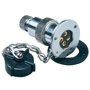

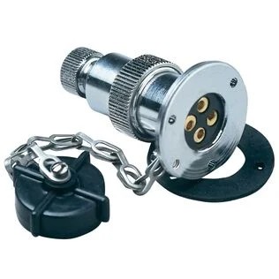

There is a rubber washer included that you can place on the deck then screw down the lower part with female pins. The rubber washer makes the base water proof. It is visible in the image above. When you unplug the male part, then use the cap that is secured with a chain to cover the deck portion opening to prevent water intrusion The male portion with polarized pins fits only one way is screwed on from the top and it too is water proof. This male and female 4 pin plug is made out of metal.
I use this plug to connect a wired remote switch to control the windlass motor from the cockpit.
Appreciate the break down. I think that will work well. One thing, can you explain what the "female pins" are?

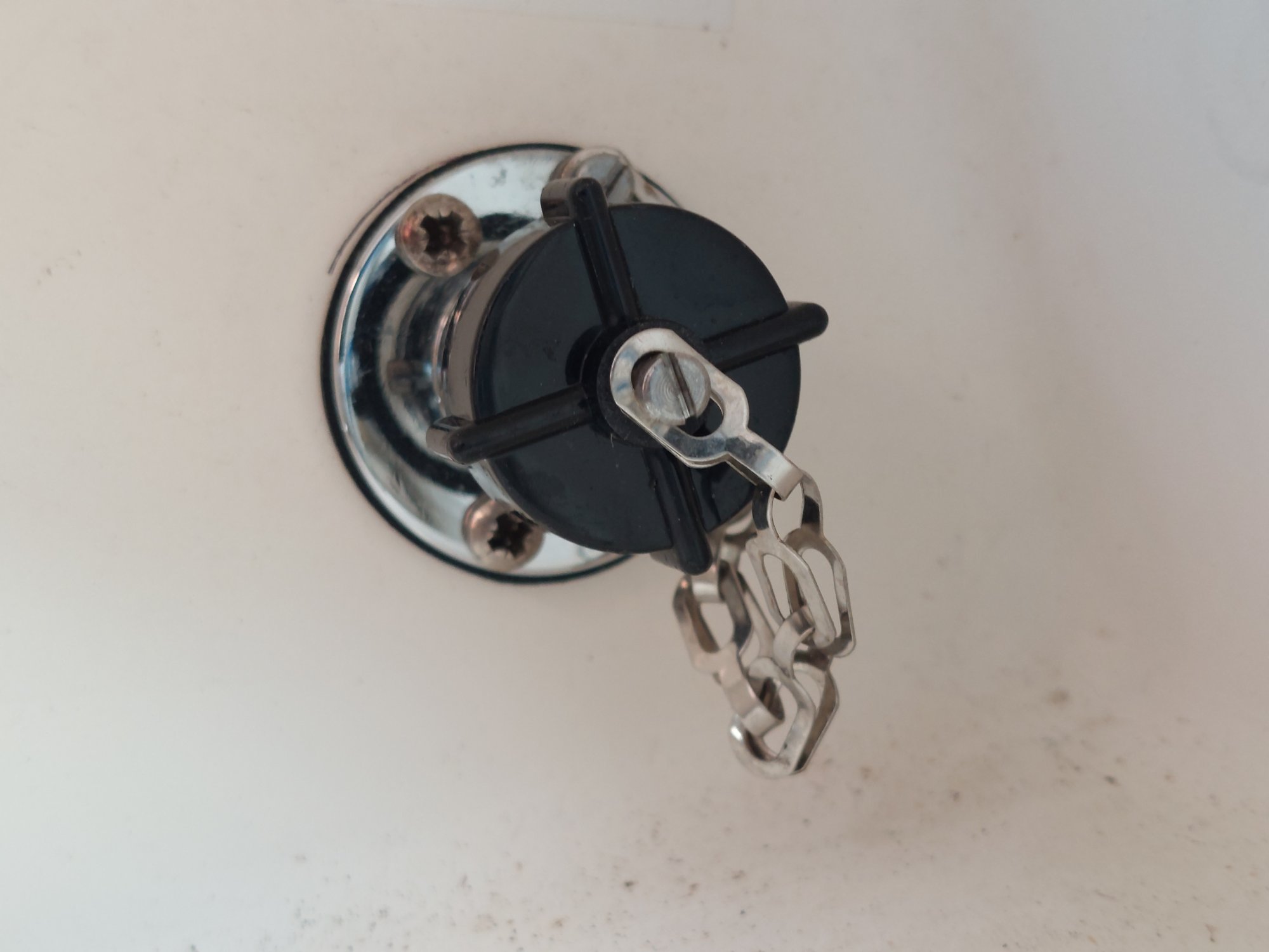

How do you like it. [Wish west marine would have more photos on their products.] Hard to tell from just one photos on there.
Do you epoxy the walls of the hole for it to seal the deck?
You should always seal the hole in your deck with epoxy if it is cored with balsa. Every rubber gasket/goop will eventually leak.
I stongly dislike that Sea Dog and the Sea Dog look alike connector, and yet that is what I currently use. The tiny screws are a pain, strip easily, tends to leak, and corrode quickly (and I'm in fresh water). I have an aircraft type connector, but it is more difficult to install and I keep putting it off.
Looking forward to anyone who has a better alternative.

The female pins are actually receivers for the male pins - but you knew that!
I figured so much...just haven't seen those on these connectors before so trying to picture them on this setup. Sorry I guess I'm very detail oriented when it comes to stuff like this.
Yeah, it was the 3 or 4 deck screws that worry me the most. Feel like there has to be a better way to secure these connectors.
I fill the whole area with epoxy out past the screw holes. I don't cut it all out, but use the bent nail trick to remove the core.
