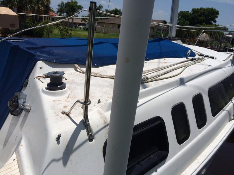

Ouch! Opa spent the summer in south west Florida on canal lift.
Didn't really notice Washintonian Palm. Berries dropped and dried, baked on.
Anybody have any experience cleaning this mess.

Try acetone. I have cleaned up all kinds of stuff on my gelcoat with no damage to the gelcoat.

A solution of oxalic acid (wood bleach). This is available at big box home improvement stores. This is the active ingredient in boat hull waterline stain cleaner.

Tried a solution West Marine had that's active ingredient was oxalis acid.
Didn't work. Will find a stronger solution (Home Depot) see if that's better.
Than Mary Kate, Acetone. Hope something works.

I have been able to take all stains off with acetone. Good luck and let us know what worked best.

Time or a bleach will remove that.. if you use a chlorine base bleach, be very careful to rinse thoroughly and don't get any on stainless parts, like swedged fittings. A strong hydrogen peroxide will take it out as well. (Baquasil or equivalent shock from swimming pool store. Read the warnings before playing with it)

As a last resort you can use toilet bowl cleaner, but don't let it sit long on the gelcoat. Squirt, wipe, wash < 1min. Wash thoroughly with soapy water, and depending on where you are using it you may want/have to re-wax after.

This old post was most helpful. My foredeck was bombed with berries while I was away for several weeks. I’m also on the SW Florida Gulf Coast. Tried several stain cleaners and finally Tilex Mold & Mildew (with lots of scrubbing) got it off.
Thanks for the dialog.

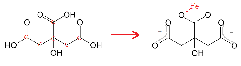

The acid in lemon (citric) and vinegar (acetic) are both chemically similar to oxalic acid. Magic eraser uses melamine. It is a base that neutralizes the acid and also acts as a mild abrasive. Baking soda is also a mild base that acts as a mild ebrasive. So a follow up treatment with magic eraser and/or backing soda is a good idea to "kill" the acid once you think it is done doing its job. If you have rust stains, both citric and oxalic will do a good job. They are both capable of "chelating" the iron +3 ion in rust and thus making the "rust" water soluble. Acetic acid is better for hard water scale than the other two but is not as effective on rust stains. Similarly all three acids are effective at breaking down tannins... which are responsible for most of the brown scum stains you get in your gel coat. My personal experience has been that water scum stains are best addressed with oxalic acid but all three work to some extent.
For the nurds on here... I posted the structures of the three acids below. The points in the structures represent carbon atoms and I colored them in for the first structure. I also made a representation of citric acid losing its acidic protons and then chelating an iron ion.
Citric:
Oxalic:
Acetic:
