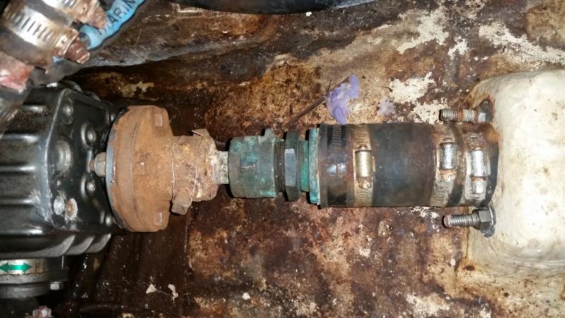

thanks Woody. How hard is it to pull the shaft out?
Is the boat out of the water or in the water? If it is in, can you get it lifted out and put on a hard stand?
If it is a bent shaft, it can / will tear up your packing and this could lead to an ugly leak. Water could come in faster than you can pump it out.
Other things that cause vibrations, fouled prop with a piece of line or trash, like an old Walmart bag. Also a broken or cracked or nicked prop, too big a shaft zink, and there are other things. Also if the strut is excessively worn, stern bearing or shaft log is excessively worn. Not to mention worn shaft.
Good news, all these parts are available from Hunter. (Hunter owners parts). Stern bearing, shaft, shaft log, strut and bronze prop. But you need to get the boat on a hard stand and inspect it. Or, hire an experienced marine surveyor to look at it with you. You can hire them by the hour to look with you.
Nope, most of the time, none if it is too hard to change on a stand on the land.
