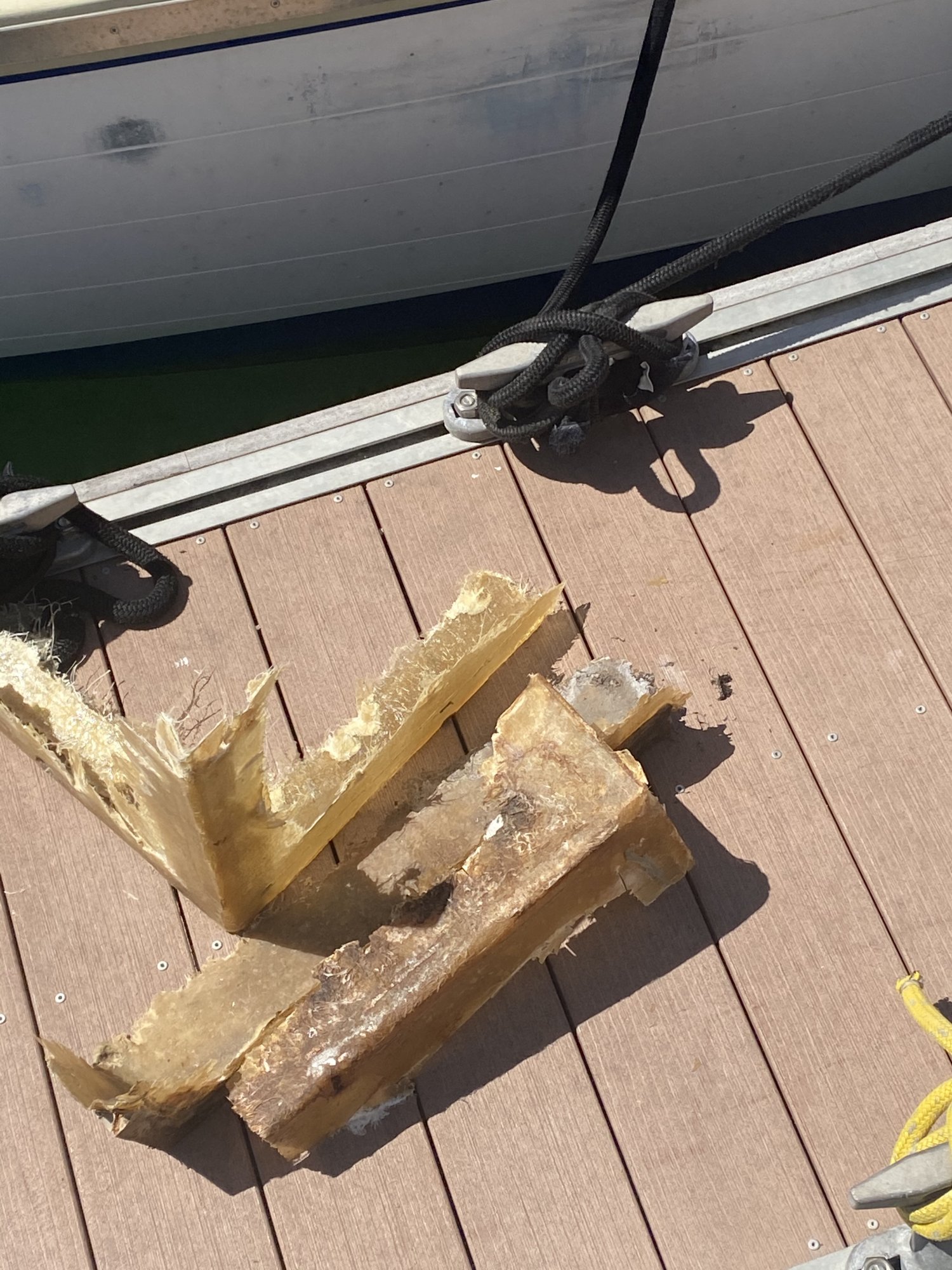

Just wanted again to say thanks and give an update. dlochner you are right across the board. Mat fiberglas was used and whatever resin was used it was very brittle. second no prep was done to the wood, which had a varnish finish and most of the fiberglass was not adhering.
We have removed all the old fiberglass, we sanded all surfaces, and laid the first joint compound in the corners. Tomorrow we plan on finishing the joint compound and starting to fiberglass it back together. I am thinking about adding a 2X4 or something like it as a support longitudinal across the top so that the center will basically be wedged between the outer tabs. It's kinda hard to explain but I have been taking pics and videos and I feel once completed it will be much stronger that original.
