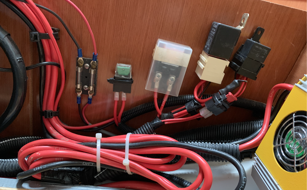

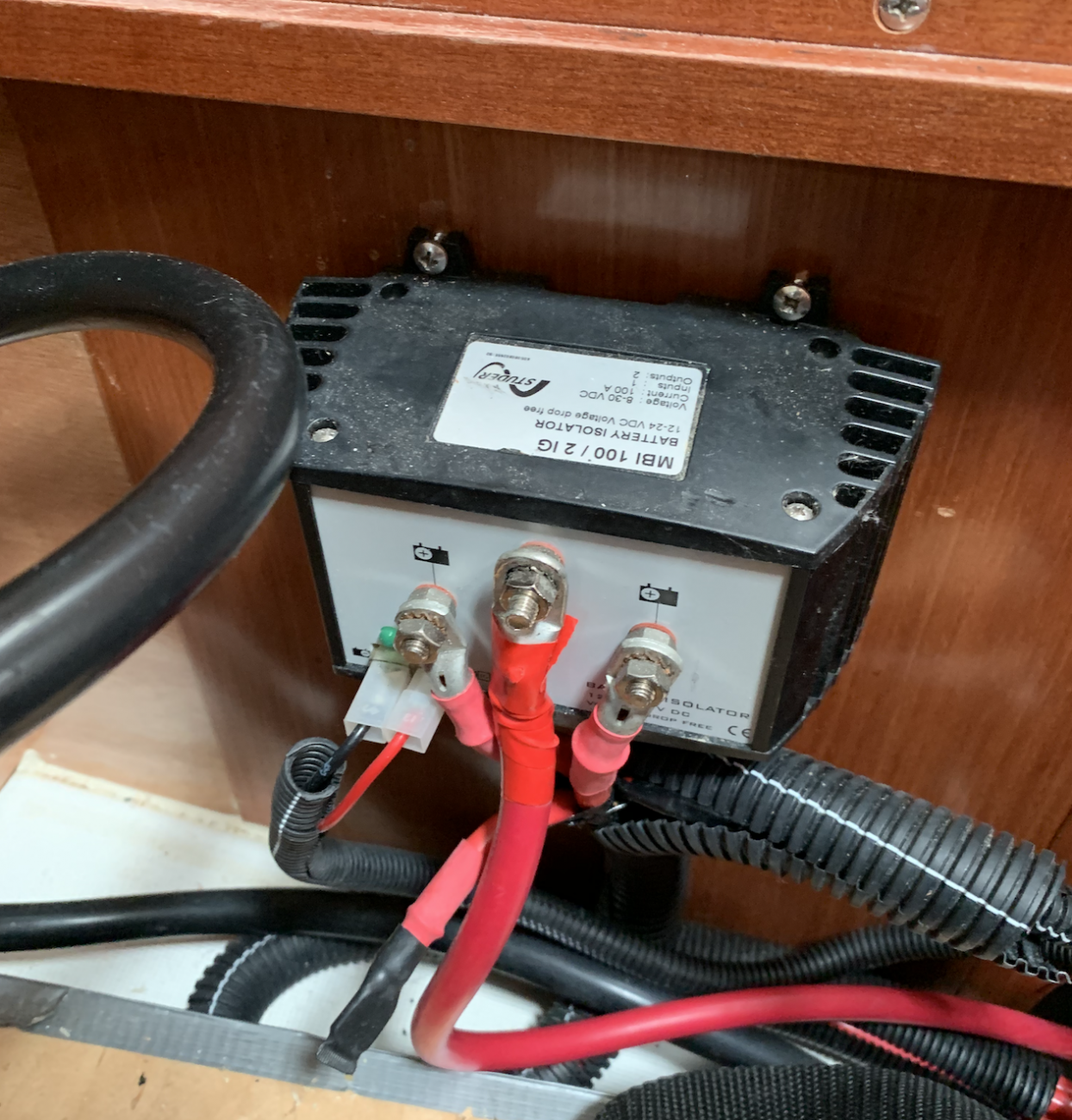

I am wondering if anyone has an idea of what the different relays and fuses are in the house battery compartment? (see picture) from left to right 1). 2 inline glass fuses, 2. 20 amp fuse, 40 amp fuse, 12v 50 amp 5 pin rekey, 12v 25 amp 5 pin relay. What I'm really having problem is that my house battery are not charging when engine running, I have tested battery isolator and found that getting good current from alternator, good output to engine battery, but no out put to house battery, green light on on isolator . I am also not sure of the two small wires connected to the isolator. But have found that they are somehow connected to ignition. I also found that when I turn off battery disconnect to engine when running to only charge house batteries , the relay on the right of the photo ( 12v 25 amp) starts to hum. I am thinking that that might be the problem as the relay might be faulty and somehow connected to the isolator and/or ignition!
Any help appreciated?
