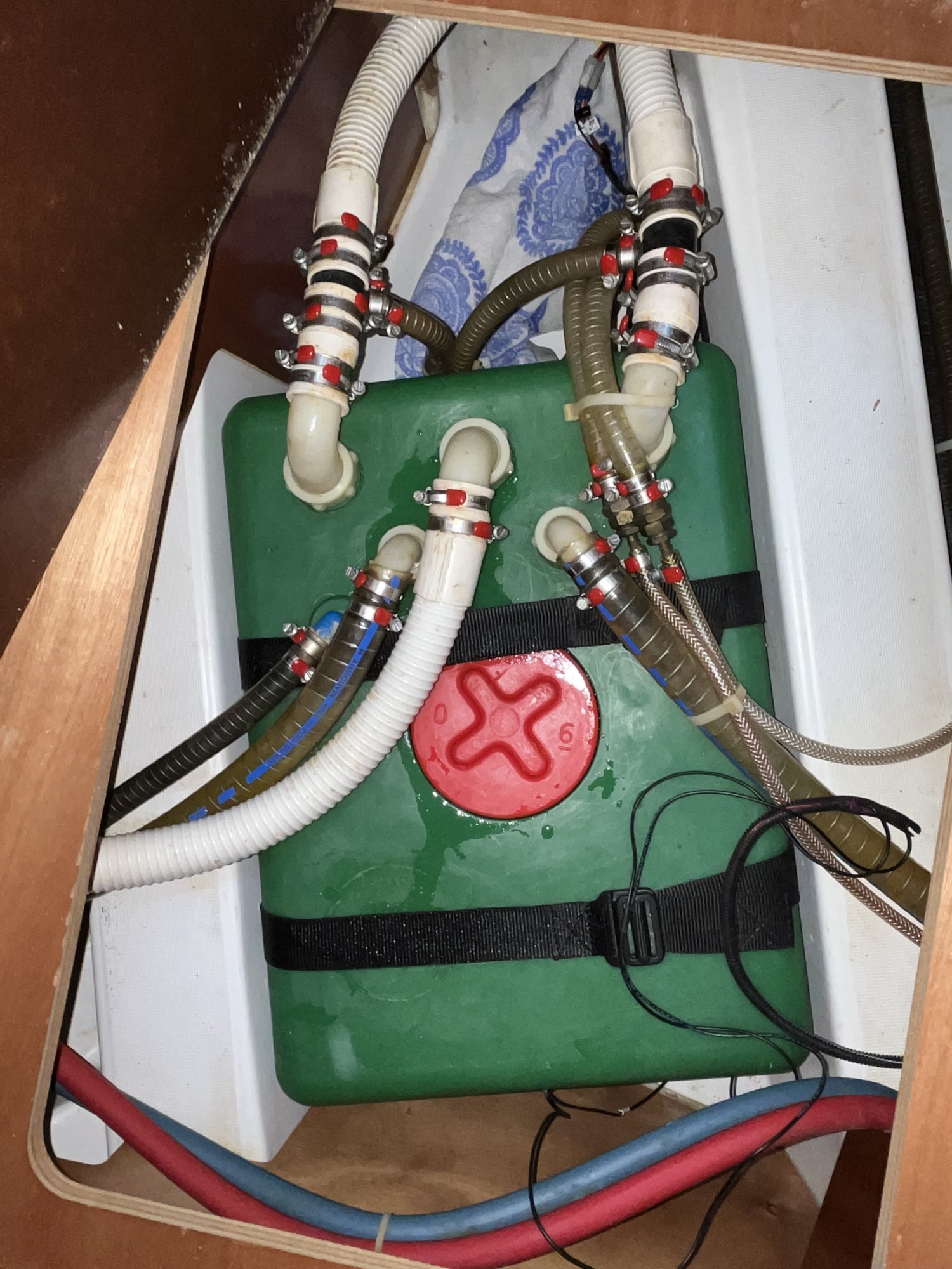

The current system in question is a grey water holding tank system which receives water from the sinks, showers, and somewhere else to be determined; it looks like some type of a small sump from the forward bilge.
The system supposedly will drain the tank when powering on the 12 v system, it also has an internal float switch which should drain the tank. It stopped emptying the tank, I replaced the float switch and Scheiber circuit board, there is power at the board but i can’t get the pump to pump out the grey water tank. The pump does work, a Whale gusher. Hopefully there are Beneteau owners with a similar system who may be able shed some light on the system’s operation. I see no override switch on the breaker board nor in either of the heads nor any type of manual override.

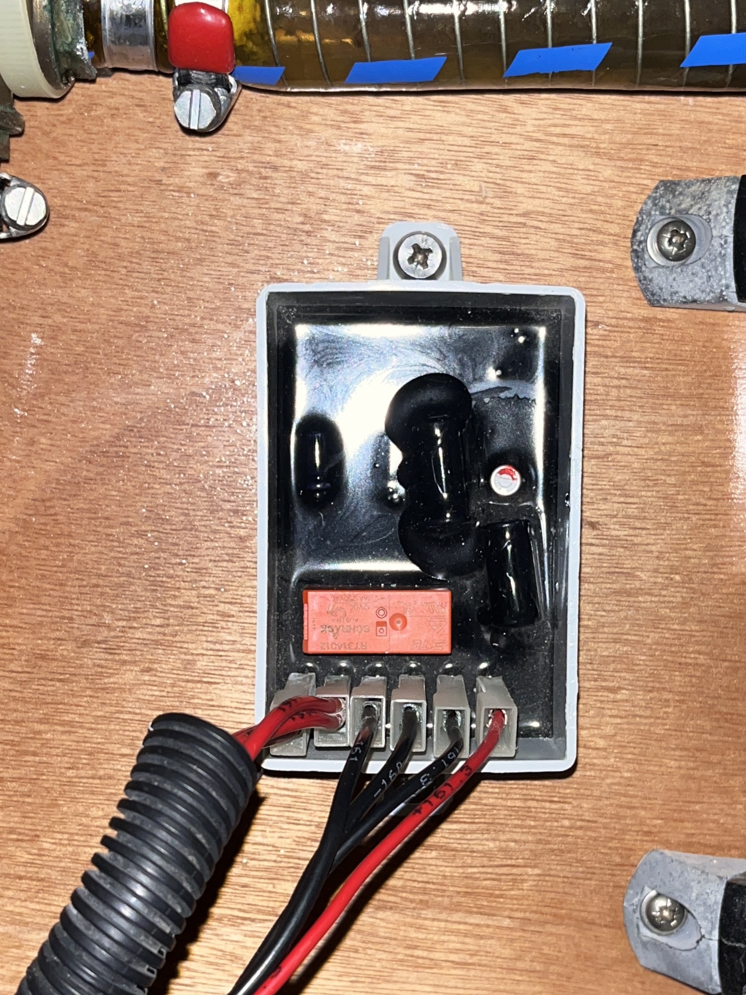

here's my update, first thanks for the referral to the jeanneau site, unfortunately I can't access the site, they don't know my email though they do send me emails to reset my password. Still trying to access the site.
with "a picture is worth 1,000 words" please see the attached, the pump does work via the manual shower switch in each head but the auto function does not. I had my a/c guy look at the system as he was familiar with Beneteau, not sure if the leads were incorrectly plugged back.
Also waiting for Beneteau France to get back to me. As some may know when the boat circuit switch is turned on the auto grey water pump should work pumping the tank for 3 minutes or also work when the float switch closes the circuit. Beneteau says there are 5 drains into the grey water tank, galley sink, port shower & sink, starboard shower and sink for 5. Per the photo I have 6 and I'm still looking for #6. My issue is while we're away #6 is slowly filling the tank with fresh water, fresh being non salt, it looks very clear & no odor and given enough time the water will back up into the showers. Perhaps the a/c condensate is going into the tank though my other mechanic said no, I'll check it next week but still open to fixing the auto drain system.
Many thanks for reading this and open to any and all comments.

Update, yes the mystery water line into the grey water tank is the main salon a/c condensate line which is doing a good job filling the grey water tank. In addition to trying to win lotto I’m trying to find a marine mechanic in the Jacksonville FL area familiar with the Beneteau grey water system, in particular the wiring of the Scheiber pump controller board as noted in my earlier post, also looking for a Beneteau or Jeanneau owner who could share the wiring schematic of their boat re the pump board. Beneteau Fr is v e r y slow in responding to my inquiry. At this point in time separate thru hulls for each sink etc isn’t an option.
