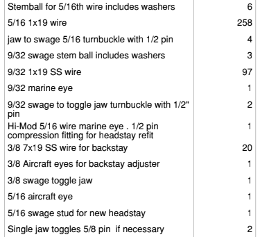

Would anyone have a guide to tuning the rig for a Beneteau First 38? We have the original mast, but replaced the standing rigging in 2017. We have a friend who knows the procedure and has the Loos Gauge, but he wanted to know if we had a tuning guide. We know the wire used, but not the "type".
