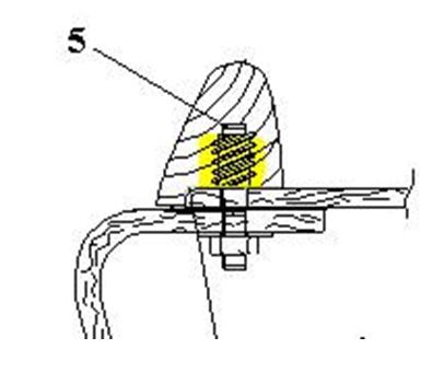

Will, I have changed the forward toe rail on 36.7 before, it has been fairly easy.
Unfasten the nuts from below and lift the rail. Breaking the silicone bond was the tough part, but not terrible (I’ve used scarpers).
Which rails, and how many did you get? I can take one off your hands, as Beneteau just told me that 36.7 toe rails are no longer available.
