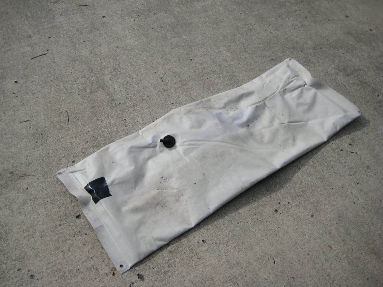

Where can I find a replacement flexible tank for my First 305 ? The original bladder outlet fitting has broken. It fits under the port settee and is approx. 22" x 56". That's about the max size to fit there. I'd previously added a triangular bladder under the V-berth for extra capacity. I've checked Vetus, Plastimo and Imtra. No luck. Ward at Beneteau USA doesn't know the original manufacturer.

Ronco Plastics Ronco Plastics marine Tanks is highly likely to have a rigid plastic tank that'll fit your space...They make TOP quality thick-walled water and waste tanks for a very reasonable price and have more than 400 shapes and sizes, over 100 of which are non-rectangular, and they install fittings in the sizes and locations specified by the customer when they make the tank.
