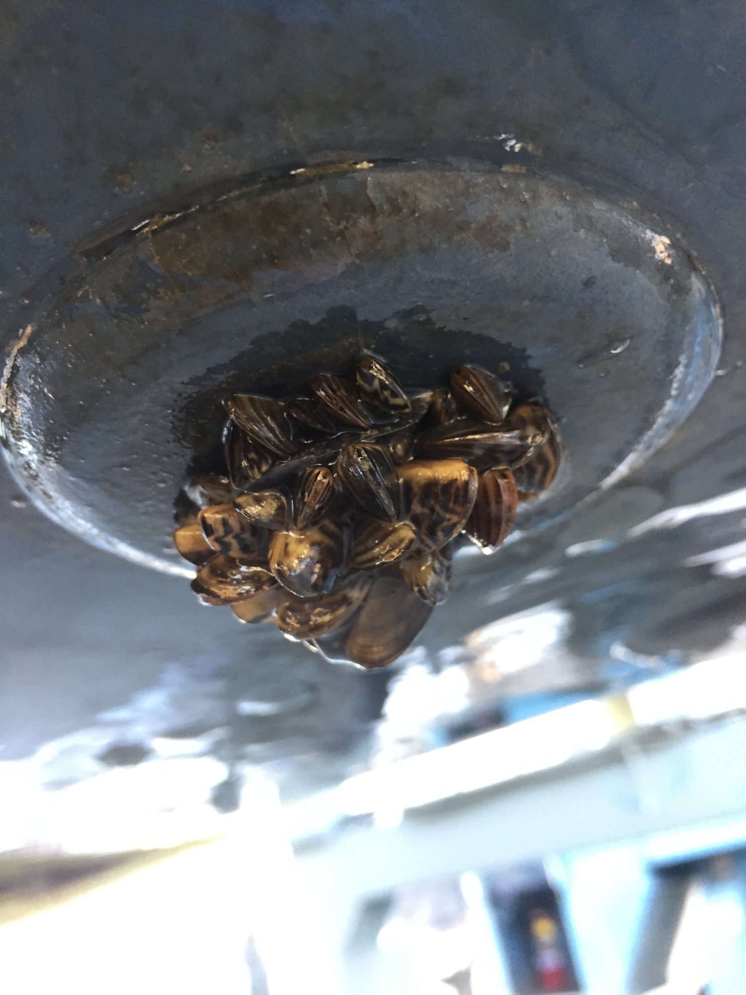

mshimota,
Here on the western end of Lake Erie we need bottom paint to avoid huge growths of algae and Zebra mussels. The water gets warm in the summer, especially in the rivers where the docks are, and the water is well fertilized by municipal discharges and agricultural runoff. Please see the attached picture of what grew on my unpainted sonar transducer one year. VC-17m works well for racing and cruising, and is easy to reapply each year, but it still needs a light scrubbing before a light air race. Keeping the algae under control also reduces the amount of mussels and other hard growth. Keeping the bottom clean can mean as much as a half knot, which is a lot when the boat is only moving 2-3 knots.
PS. Interlux has stopped manufacturing VC-17m this year and maybe next, and promises to return in a year or two. I suspect the Ingarol additive (green growth biocide) is causing regulatory heartburn again, although Interlux recently made the paint without the additive for a while.
