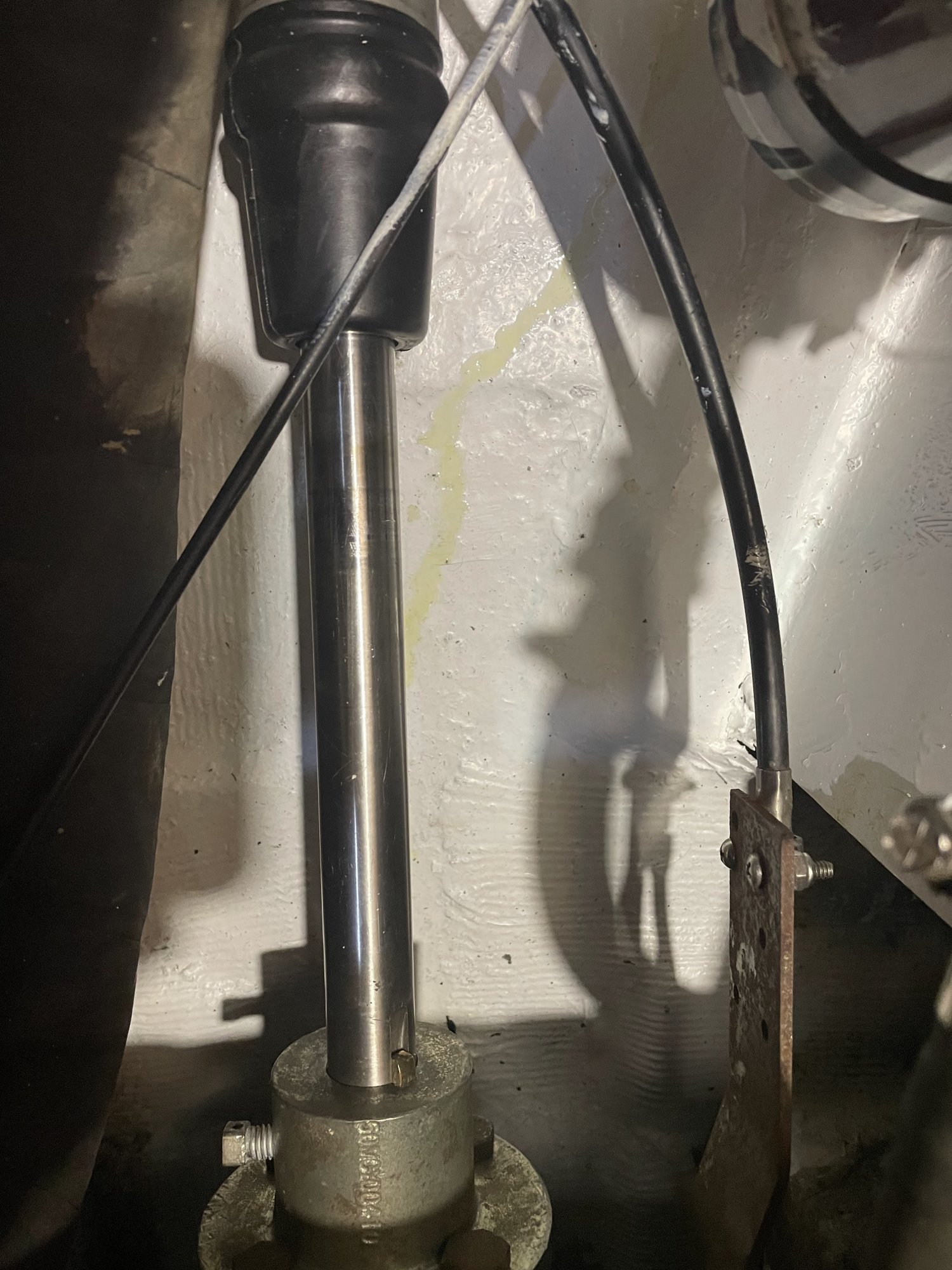

Hello, I recently purchased a 2002 Beneteau 473 and one of the required items I have to repair from the survey was replacement of the Dripless. I unfortunately live across the US from where the vessel is currently on the hard and would like to get one coming before flying back to the vessel to splash it. I know I have a 30 mm prop shaft but I can't find any information on the size of the stern tube. I am hoping someone here knows what the measurement is for the 473 that I need to order. It has a Volvo Penta TMD22-P if that make any difference I'm not sure if it does. Thanks in advance.

As @Davidasailor26 said, they only make one for a 30mm shaft. The clamp for the shaft log end is pretty robust and can be adjusted to fit.
So, if you have a Volvo Penta shaft seal, and a 30mm shaft, only 1 choice it seems.

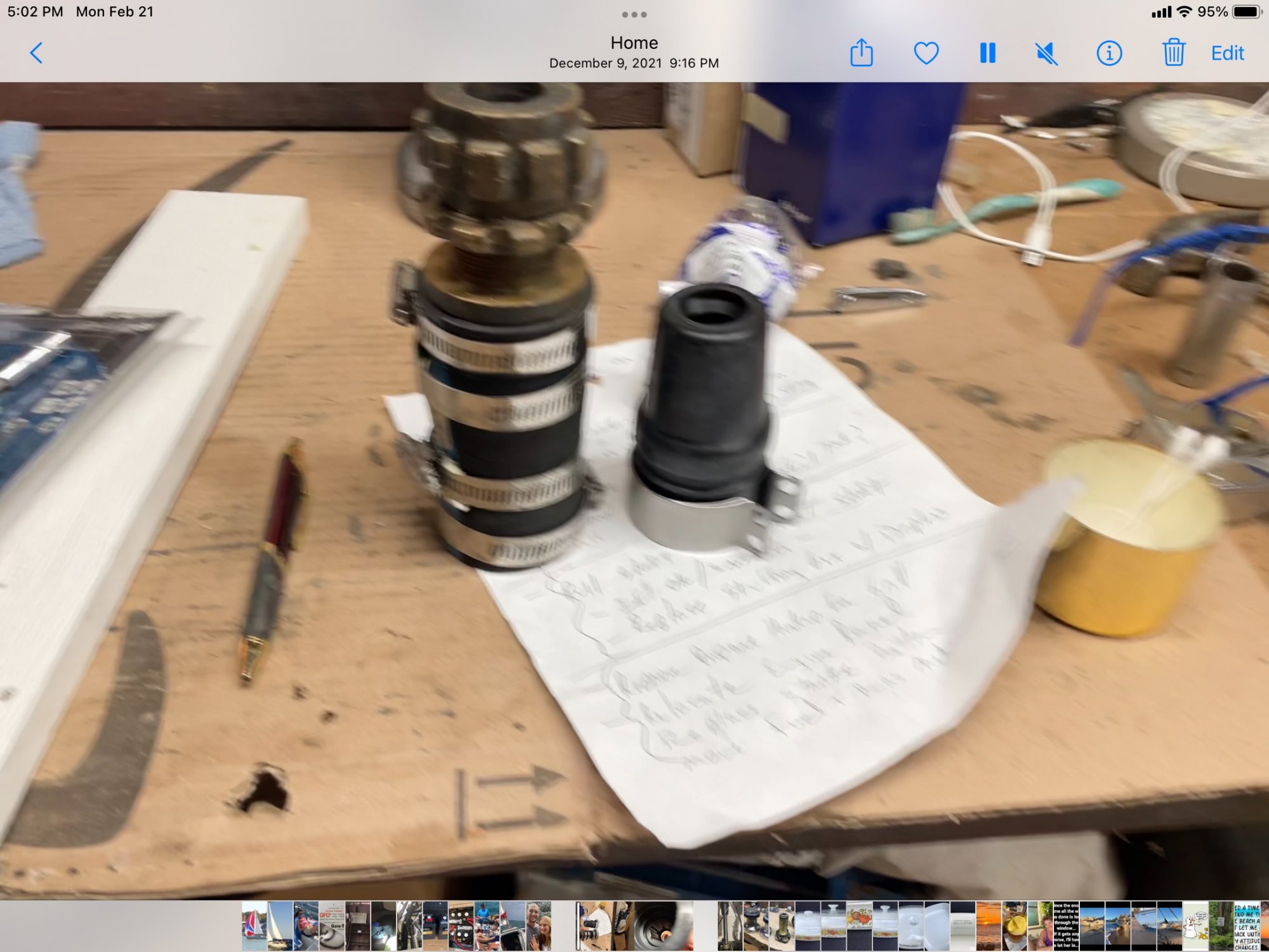

I just upgraded from a traditional stuffing box to a Volvo Penta shaft seal.
Just launched my boat this week, so no real time on the seal yet…but she isn’t leaking in the slip:cool:
And you can see how more compact it is vs my old one…
Installed on the shaft…

Your boat, your choice. But I will say I was surprised at the thickness of the Volvo seal rubber.
Seems quite substantial to me.
This, and the fact that I am cheap (or frugal), led me to chose the Volvo over the more sophisticated PSS with (I expect) thinner bellows.
