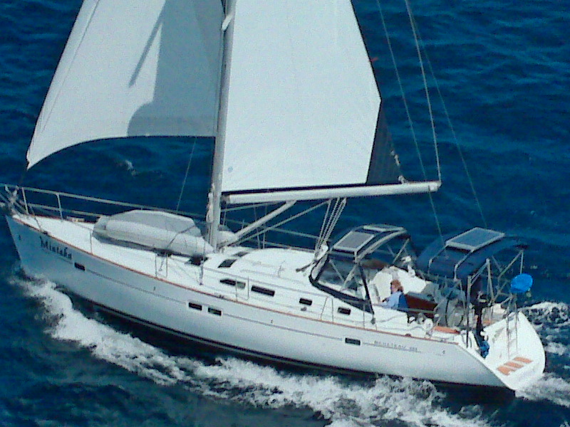

Attaching picture of my 423 underway. Best of luck with your decision!

Dinghy tie-downs on foredeck of 423
Bob846,
I am trying to figure out how best to lash down a dinghy on the foredeck, so your photo was of interest to me. I have two fold-down padeyes at the front of the cabin top (just in front of the large forepeak hatch) but no other convenient tie-down point back around the mast. Did you add tie-down points/anchors for the aft end of your dinghy?

The boat picture was taken by a helicopter. The service is called boatpix.com and they randomly fly over and take pictures. You go online and put in your information including boat name, date, and time you think they came by. They send you the pictures and you keep what you want and send back the rest. They are expensive at $250/picture, but I figure this is a one shot.
I have not sailed the 423 in really heavy seas or weather. However, it is a pretty forgiving boat and very responsive. My winds typically are 15-25 knots with swell and wind waves in the 2-5 foot range. She likes to be sailed level and I try and keep the degree of heel below 20 degrees. I have the deep keel model and even when over canvassed, have not rounded up yet. Check the yahoo group's website and others are sailing this boat all over world in some pretty wicked stuff.
I never tow the dinghy offshore and really don't like the davits. I have the 10 foot Achilles with the inflatible floor. When not in seasonal use, it is rolled up and stowed in the starboard lazerette. I use the two jackline padeyes to secure the bow of the dinghy and installed two additional padeyes near the mast for the stern of the dinghy. I fashioned a 4 point bridle to lift the dinghy and use the spinnaker halyard run back to the one of the cabintop mounted winches. After on deck, it is easy to flip the dinghy over and secure to the padeyes.
