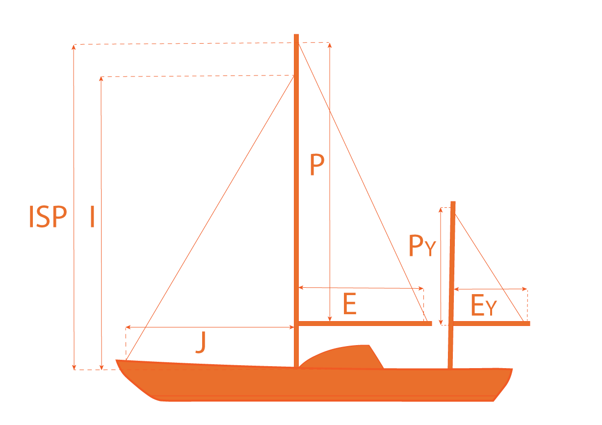

I assume you know that a used furling main is likely sufficiently stretched, which could make it difficult to to furl in and out. Whether you purchase a used or new one you will need your "P" measurement from the main halyard sheave to the main tack fitting, "E" measurement from the main tack fitting to the "black band" at the end of the boom and "Main Leach" measurement from the main halyard sheave to the "black band' at the end of the boom. Might refer to the attached Sail Measure Form also. Below are links to some of the websites that sell used sails.
