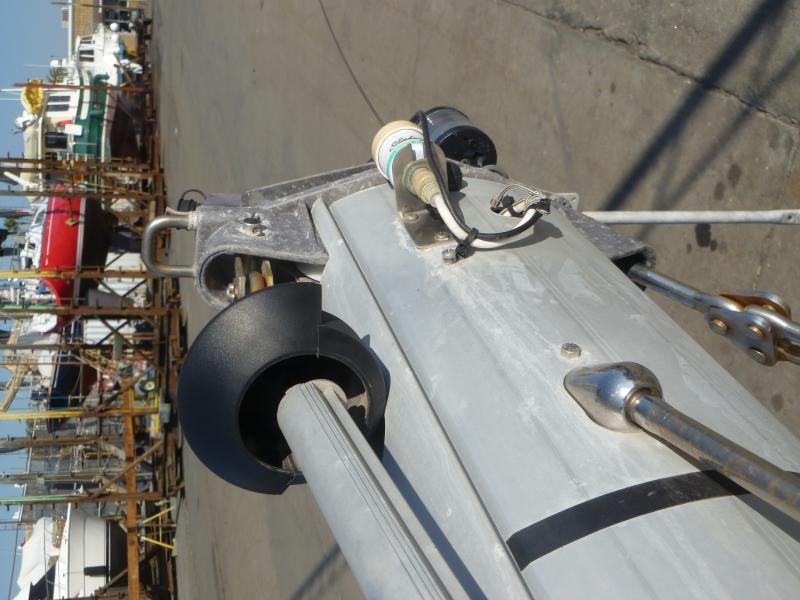

Hi All - I am new to this forum but I need a little help / assistance. My Beneteau 393 was shipped from CA to RI early in 2012 and we just got her back in the water in June 2013. Obviously the mast was totally stripped and wrapped for shipping. When we de-rigged in CA I marked all the shrouds / stays with tape for future reference - I also noted minimal thread engagement on the two fixed back stays and they were pretty taught. When re-stepping the mast in RI recently we could not re-engage the port backstay and barely got the starboard one engaged. Yard owner suggested installing a toggle at masthead on head stay to add some length. I estimate we would add 1 1/2" with toggle. We did and were able to engage backstays. However, I now have much more of a fore and aft bend in the mast when tensioning up backstays for a good head stay tension. Should I move the toggle to backstay or will that have little impact? I am concerned that too much bend (est 9") will effect mast and the main sail furl. Attached is a photo of mast head prior to adding toggle. Advice? Bob
