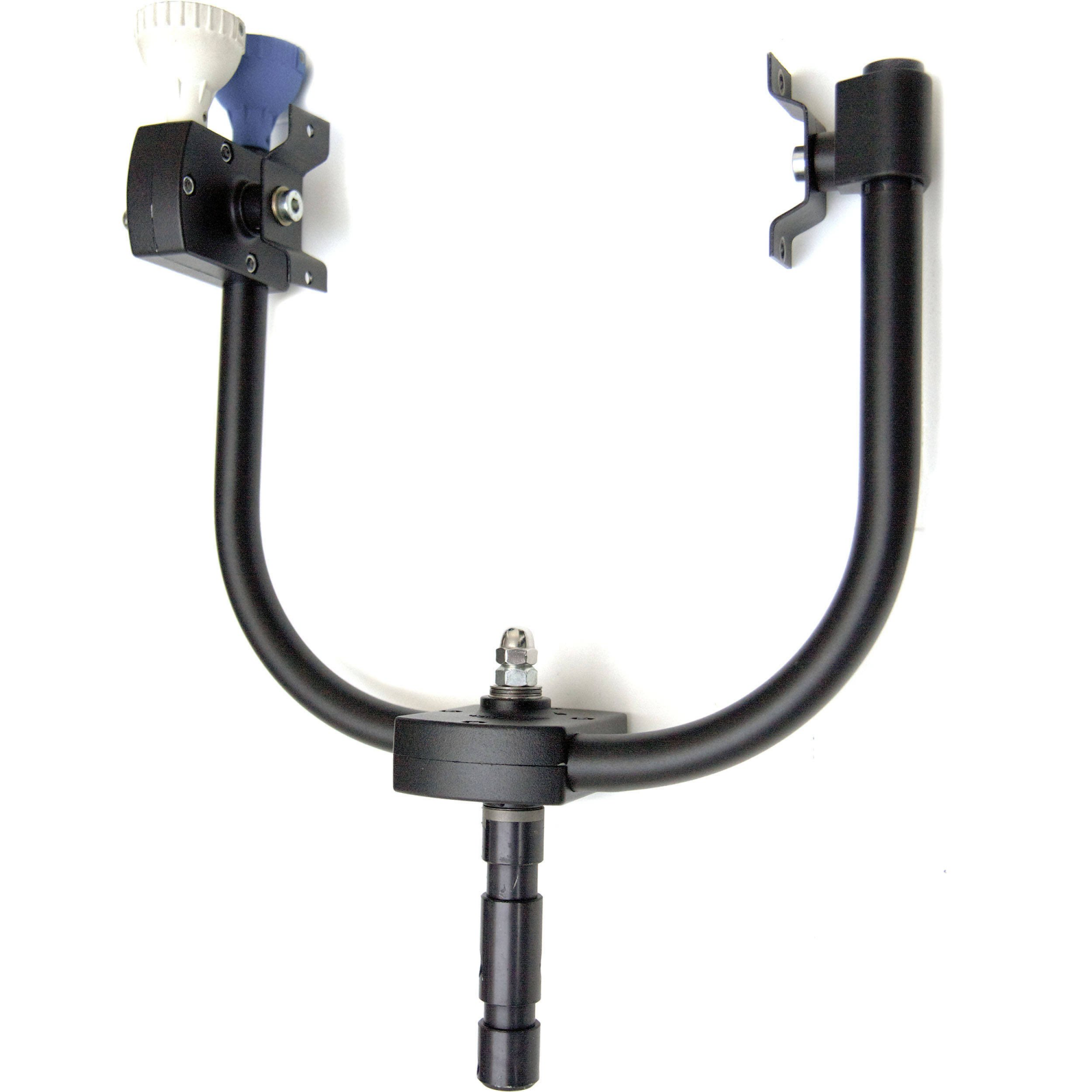

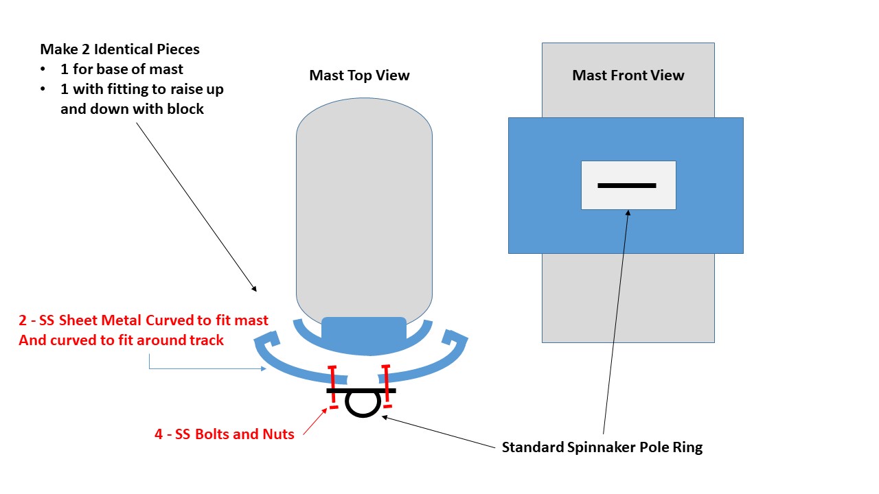

For out of the box thinking, if it is not a racing activity, you can make a yoke on the mast end and attach a strap to hold it in place. It would be a bit low as the strap would need to wrap around the mast, but the sail would be extended which is the goal.
Something like this (in concept) for the yoke. I would want it to be beefier and properly fitted to the pole.

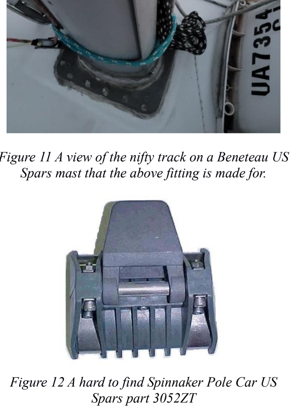

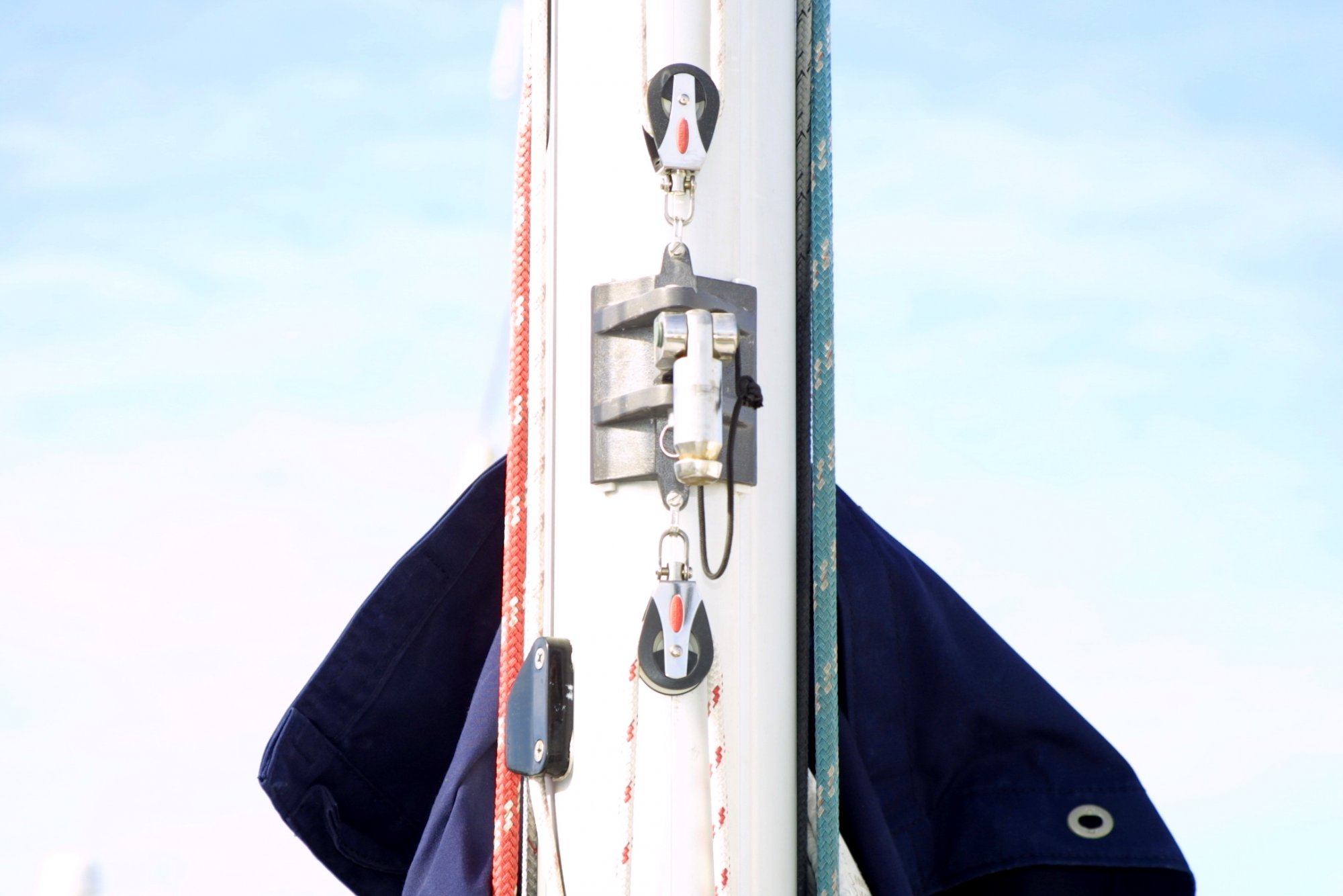

Jeff, a friend of mine has a 381 as well and she has the in-mast furling from US Spars. I attached some pictures of what the attachment should look like, but I could not find it anywhere and US Spars and Beneteau all said no mas. If you find something it would be great to know. I do think you can mount a track on the front of your mast and that should be OK, we just never got to the point of pursuing that on the 381.
