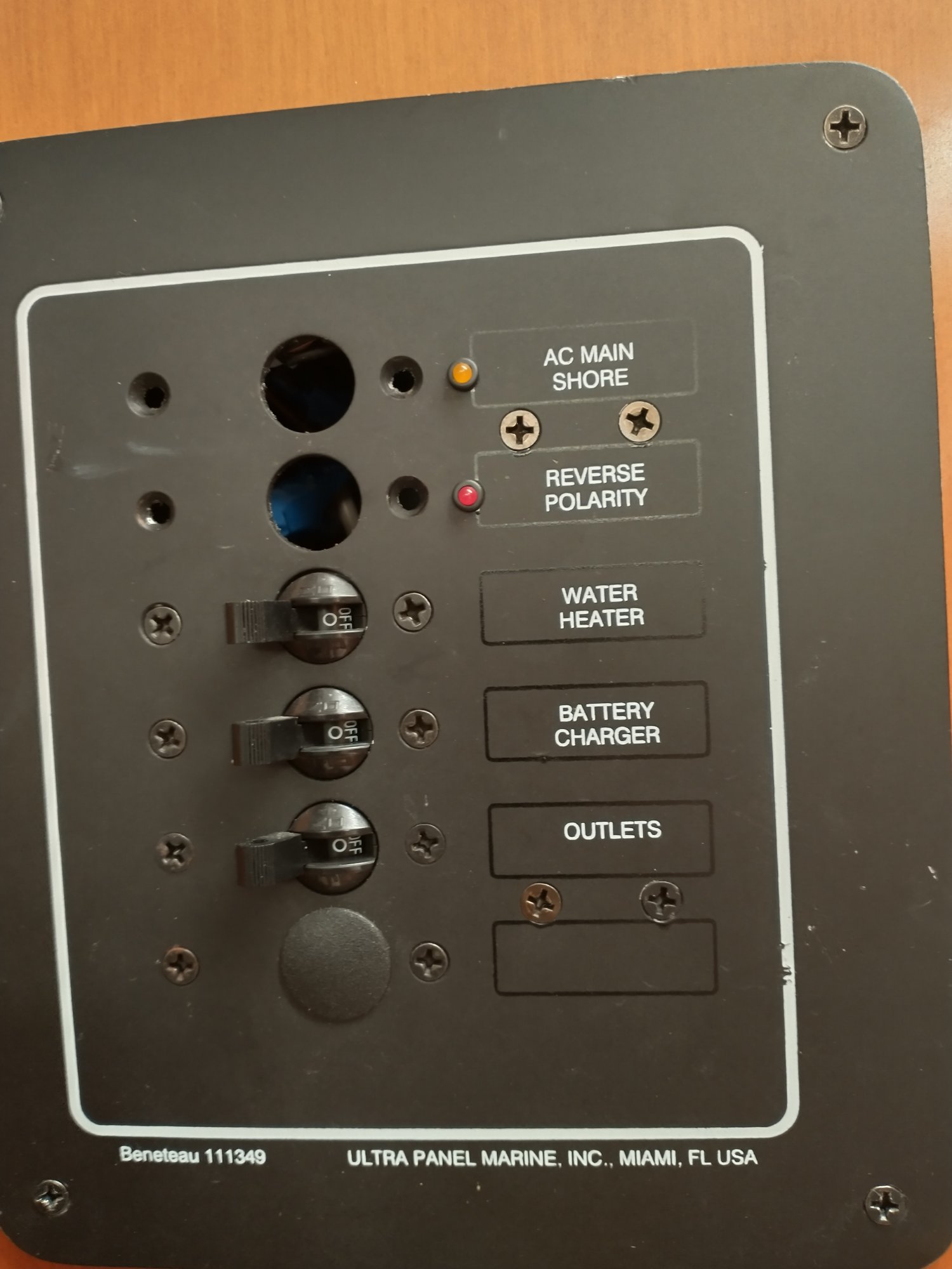

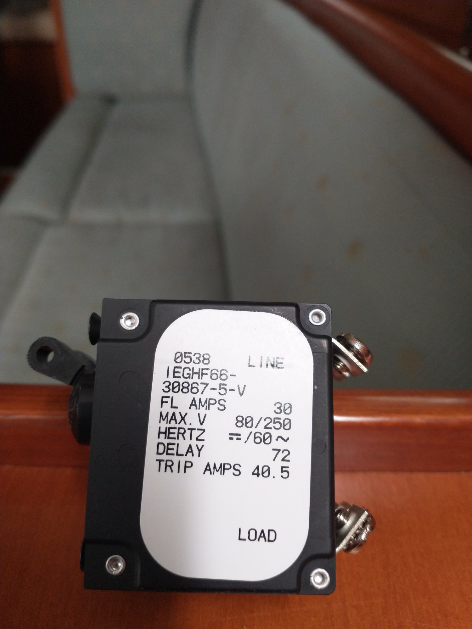

Recently had a power surge from a dock pedestal being smashed into down the dock. My shore power was plugged in when it happened. Since it happened, when I turn the main breaker on the AC distribution panel, the power and reverse polarity light come on very dim. Normally only the power light comes on bright. As soon as I turn any accessories on, the light goes out and there is no power to the outlets, battery charger, etc. Upon accessing the breaker ( which is an Air Pax double pole reverse polarity 30 amp breaker) I have 110v coming to the breaker but less than 50v coming out of the breaker in the on position. I'm thinking the breaker is bad. Any thoughts and or where to get one? Thanks John Beneteau 373
