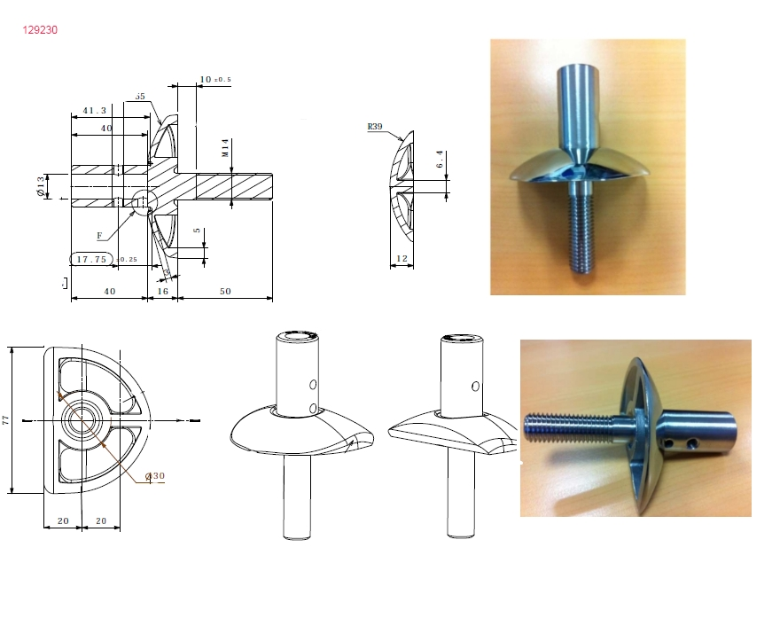

Assuming they are like those on the 331, the stanchion, which is 25mm at the bottom, fits over a post on the base and is secured there with a single horizontal screw. The post on the base continues through the deck and is secured with one very large nut.
Here's a picture of the 331 base from the Beneteau site:

The stanchion bases on my 323 are like those in post #6 above. The bases do loosen up over time and can be tightened from below the deck. Some of them are not easy to access though.
Most of the movement comes from the stanchion tube to base fit and the single allen bolt attachment as the bolt threads into the base and not through it. There is not much support especially is the tube does not seat itself on the base, and the fit over the base post is not snug. Its just not a perfect design.
Probably, the only reliable way to minimize the wobble would be to weld the stanchion tube to the base. The bad news is if the stanchion tube is somehow bent, it could not be easily replaced.

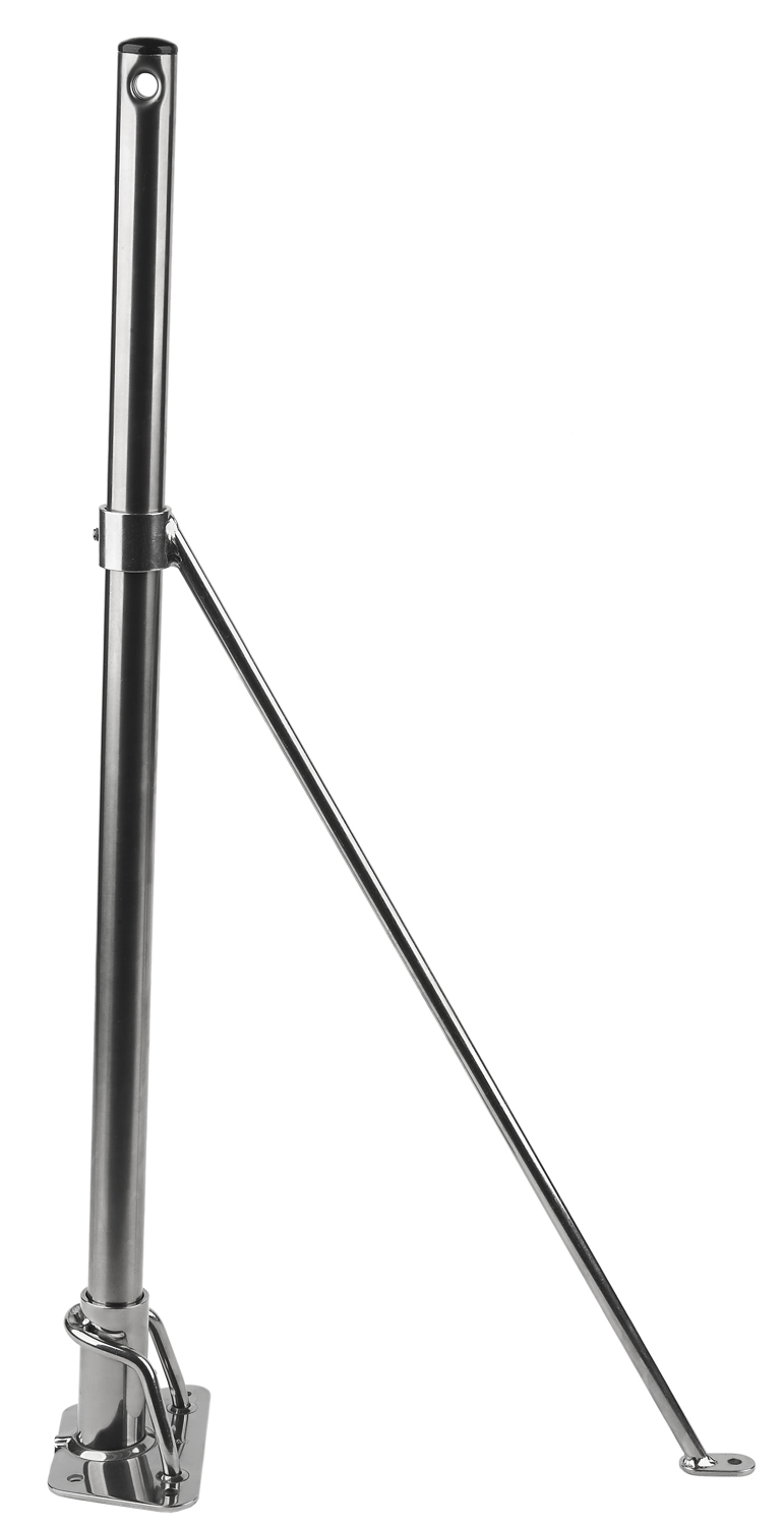

Supported stanchions are standard on ocean boats like Pogos, SunFasts, and the Figaro 3. The Fig3 parts are available on the Beneteau spare parts site.
