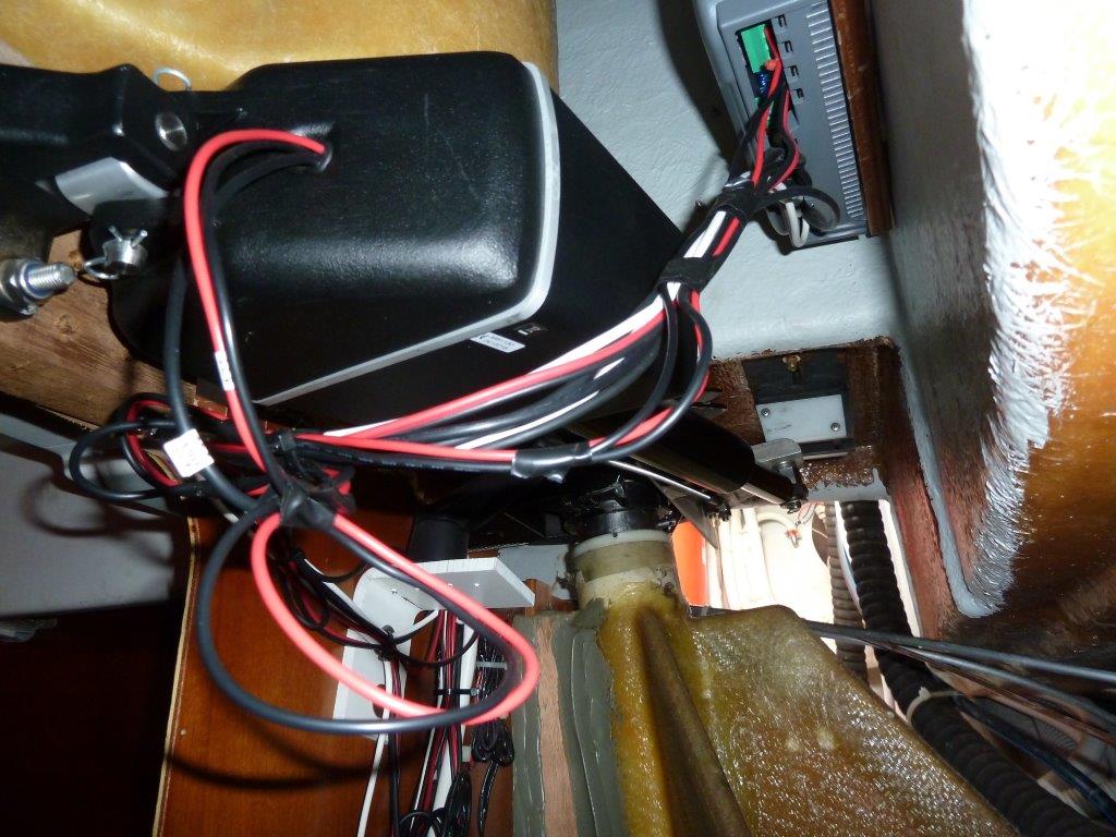

I have the 3 cabin version and I am using a linear type 1 raymarine autopilot. Like you the wheel pilot was very weak unlike the below deck which is great. I am sending some photos of the installation. A plate had to be made that was attached on the quadrant for the drive unit to push/pull. The drive unit was attached (with some wood reinforcement) on the back side of the "wall" of the aft port cabin.

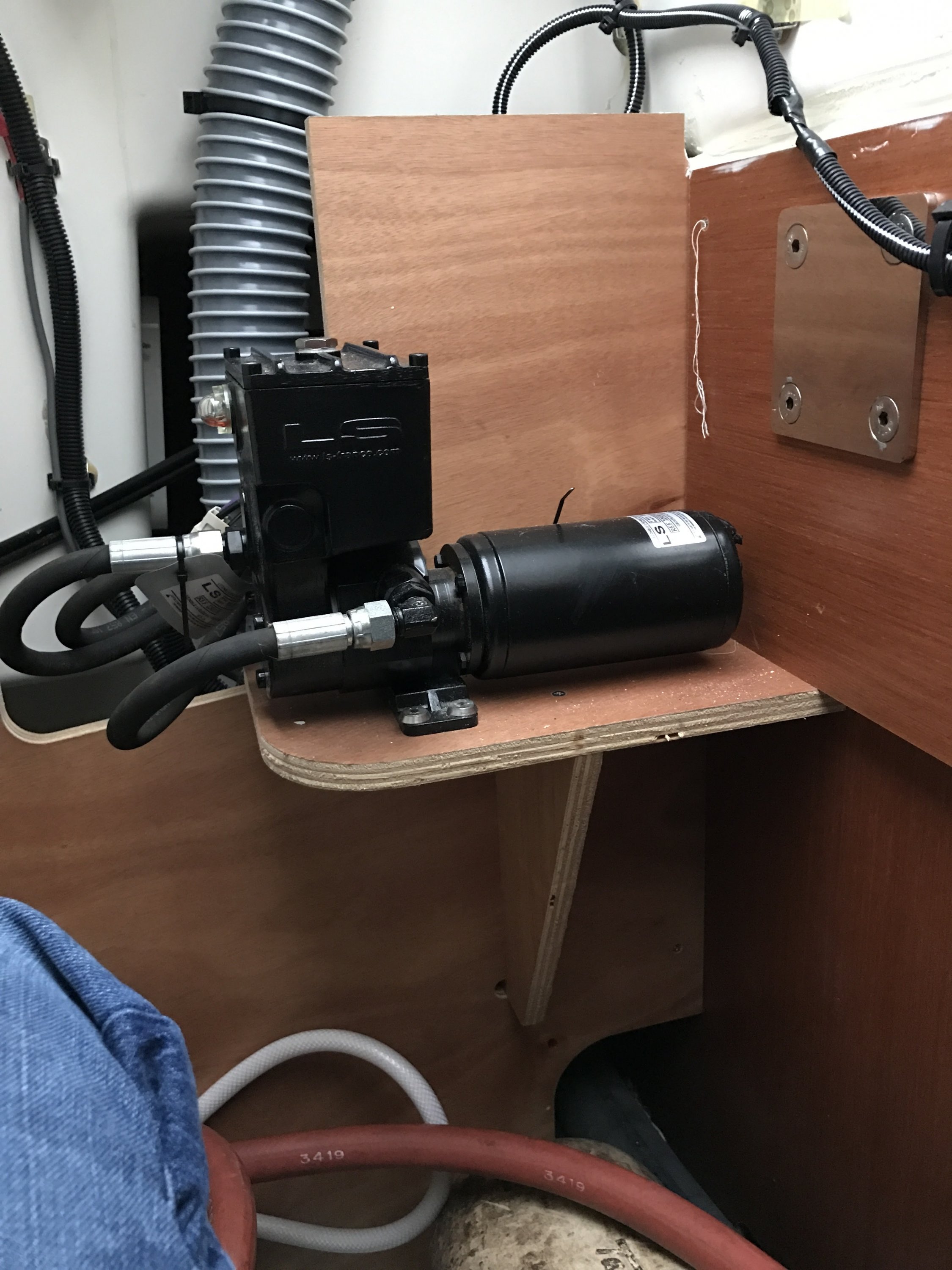

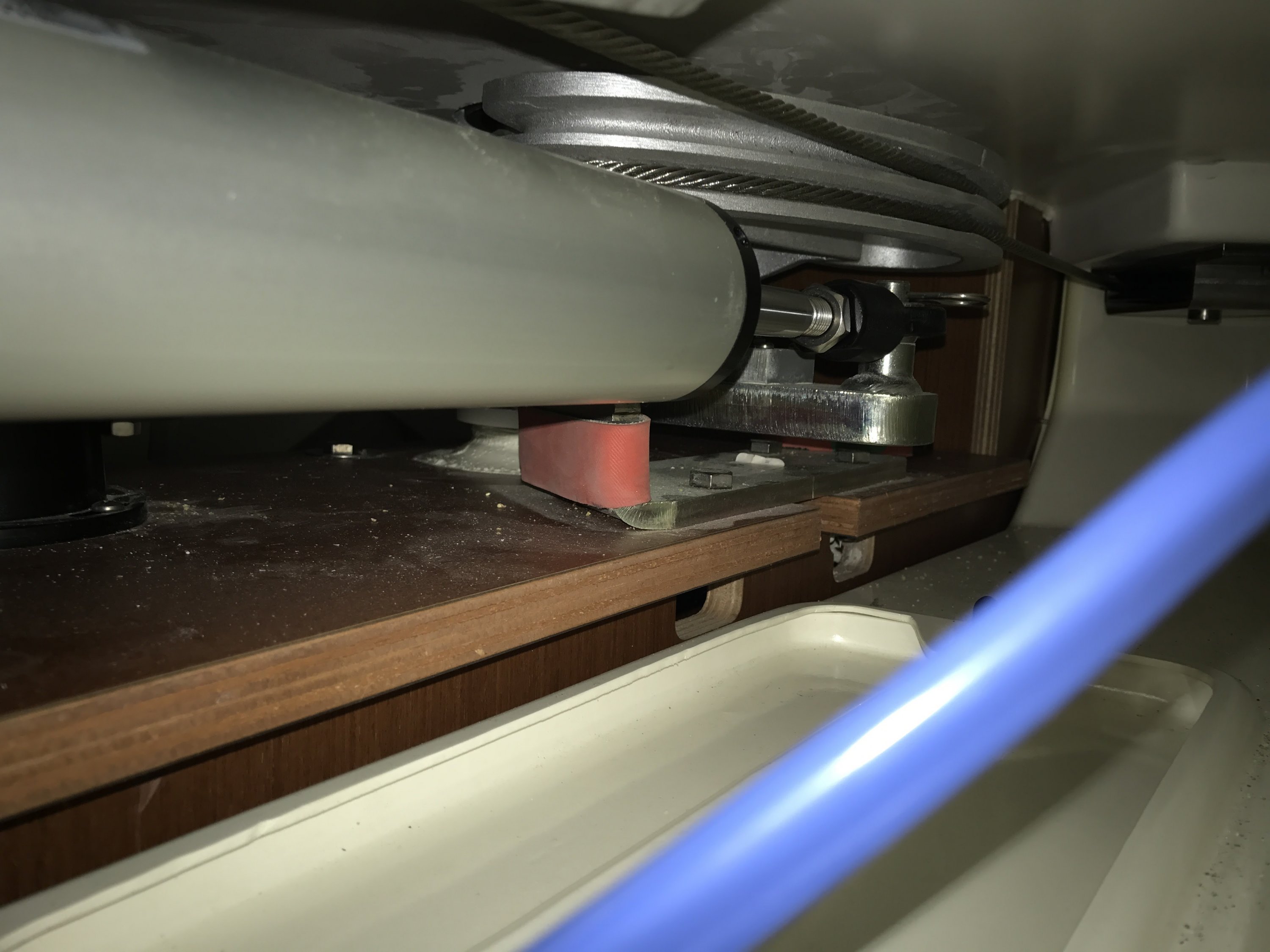

Our 37 came with a hydraulic linear drive.
The pump is in the aft lazarette. The steel backing plate is on the bulkhead where the ram is mounted. Not sure how the design of the 361 compares but this might give you some ideas.
The ram attaches to an arm bolted to the rudder post just below the quadrant.
DougM
