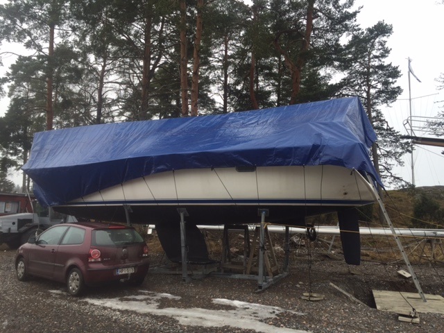

You can use 6 pad cradle without extra support, see pic. That´s my 351 and winter storage has always been done that way with no problems. 351 is a nice boat, easy to handle. But upwind performance could be a bit better.
