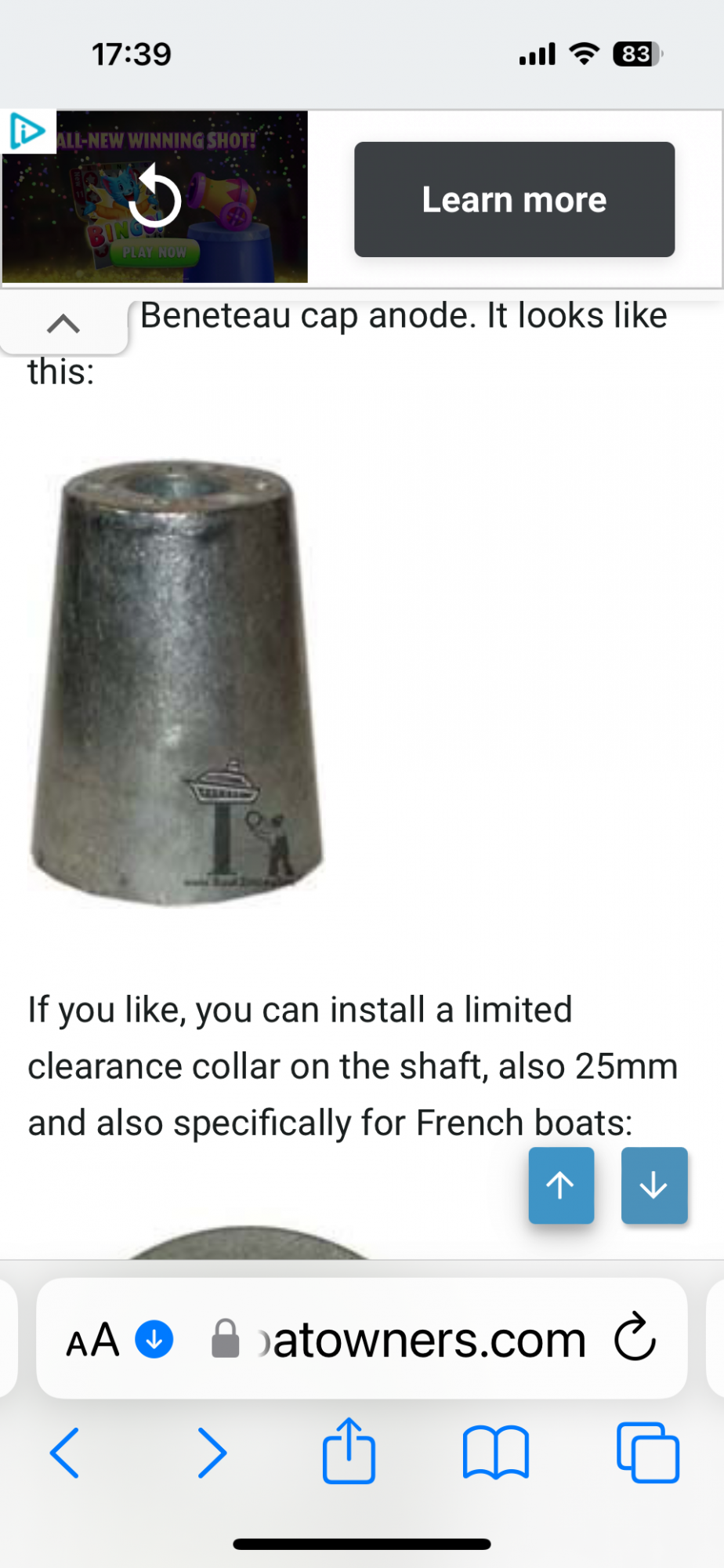

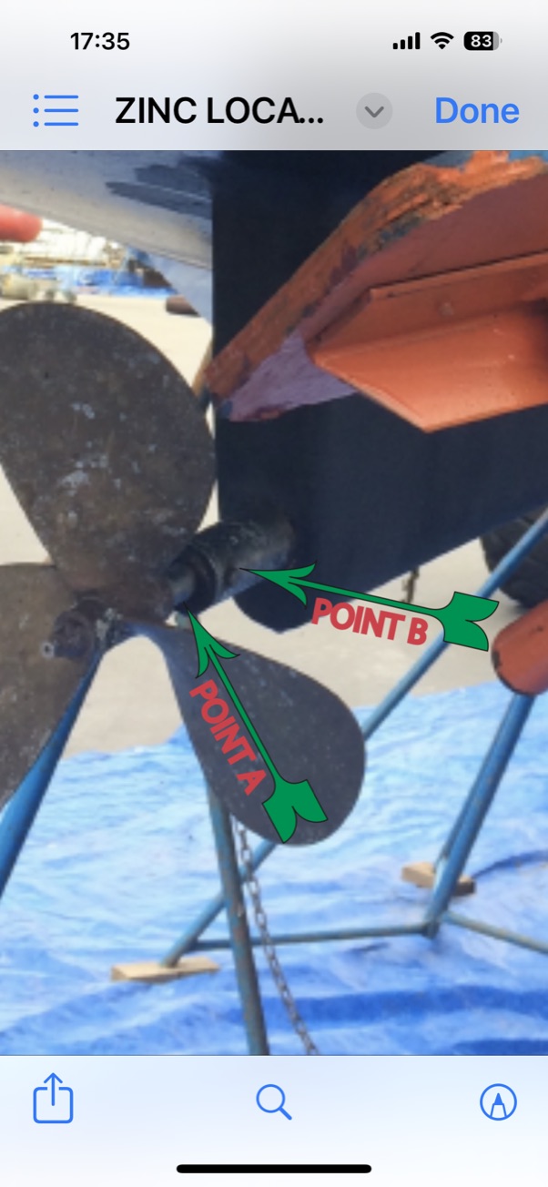

I bought the 25MM collar and the anode..right now my boat doesn't have any zincs. so just replacing it isn't an option. I have fixed 3 blade prop. I found this photo on a forum but it's not clear to me where the anode goes

Agree with @Davidasailor26 advice. You want to place the collar zinc as close as possible to the prop. If you were to place the zinc too close to the cutlass bearing (black piece protruding from the stainless shaft log), the cutlass bearing would be damaged by the rotating collar zinc & water flow from inside the shaft log & cutlass bearing would be restricted that may cause damage. Be aware that sea water is injected into the forward end of the shaft tube by way of a dedicated thru hull fitting, valve assembly, hose, & nipple, just aft of the rubber Volvo shaft seal. Good idea to remove the bronze nipple & inspect it on haulouts. The nipple is prone to corrosion & breakage with resultant flooding. Definitely want to keep that valve closed when not sailing/motoring.

You should not need to remove the prop. The collar should split into two halves. Just clean up the shaft so it’s got a nice mating surface, put the halves on the shaft, then screw them together.
The cap does go aft of the prop. There should be a bolt that goes through it into the hub to hold it in place.

.so every time I replace the zinc on the shaft I have to remove the prop...crazy
also..the cap anode goes aft of the prop I imagine
Shouldn’t have to remove the prop to replace the collar/shaft zinc; the zinc is split in half to allow insertion/removal without removing the prop. Yes, the cap zinc screws on the aft end of the prop shaft.
