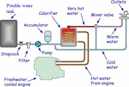

The easiest way (and safest) is to install a thermal mixing valve. I bought mine on Amazon. That way I got the same water temperature regardless if I used the shore power or engine to heat the water. I set it for around 110 F. If you hunt around the forums you should find some posts about how it's done. A pretty easy project.

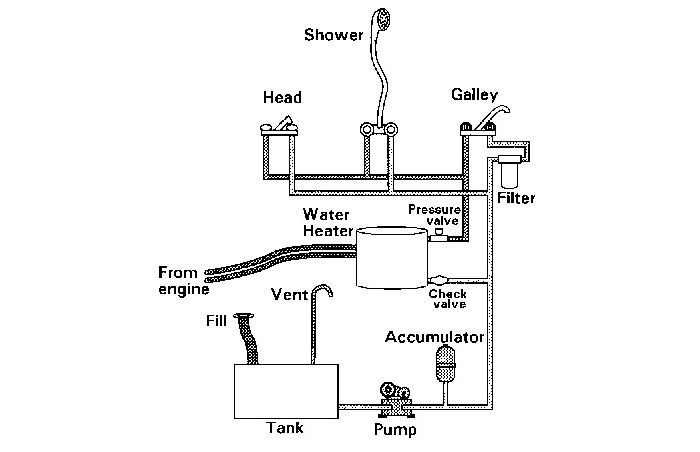

If you have children you'll want to be careful but an easier less expensive way is to go with single lever faucets although the water temperature will be hot & even hotter when the engine is running, mixing valves are good but borderline the DIY skill set. they don't have to be mounted on the water heater and can be near the water heater rather than on it.
This is without
This is with MV

BigEasy, my Beneteau 31 has single lever faucets and it is also very simple to adjust water temperature. However, drawings attached by Denise030 do not show that hot water tanks (pressure vessels) are equipped with pressure relieve valves. It is possible (and this happened to owner of B. O. 37 in my marina) that after long motoring, hot water in the tank will open pressure relieve valve and discharge hot water into the bilge. Most likely this is due to deposits buildup in the engine/heat exchanger of the closed loop fresh water circuit.
New Yanmar engine have optional shutoff valves installed at the engine block for closing water circulation to hot water tanks. In the past few years I’m considering buying and installing this on my engine. Valves also simplify flushing/cleaning of the engine and replacement of anti coolant.
They are piping diagrams why they aren't detailed about the T&P valves
Which I should mention as a reminder, many people don't realize the pressure relief valve is also a temperature relief valve
