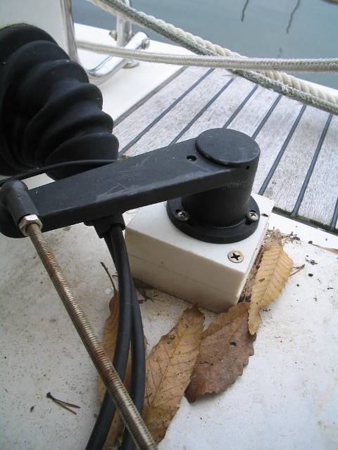

BigEasy, Attached pix is from a Beneteau 381and shows the rudder position sensor mounted forward of the quadrant and the rod attached to the quadrant at about the 3 o'clock position. Disregard the dog hair and leaves, pix was before a heavy cleaning.

Thanks for the photo. Illustrates that there are multiple ways to set this up. From reading the installation instructions, I thought the rudder sensor arm has to be parallel to the tiller or in the case of a wheel steered boat, parallel to the rudder when the rudder is centered. From the looks of your installation, it appears that as long as the rod and tiller pin are 90 degrees to the rudder sensor arm, you are good to go. Again, I appreciate the help.

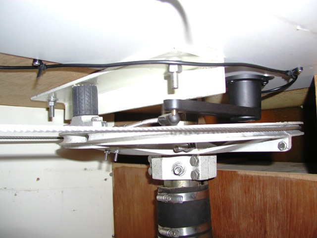

Phil, I know its not Beneteau, but you can mount it upside down too and have it end up being pretty compact. The "sense" wires had to be reversed to make it correctP7160345.JPG

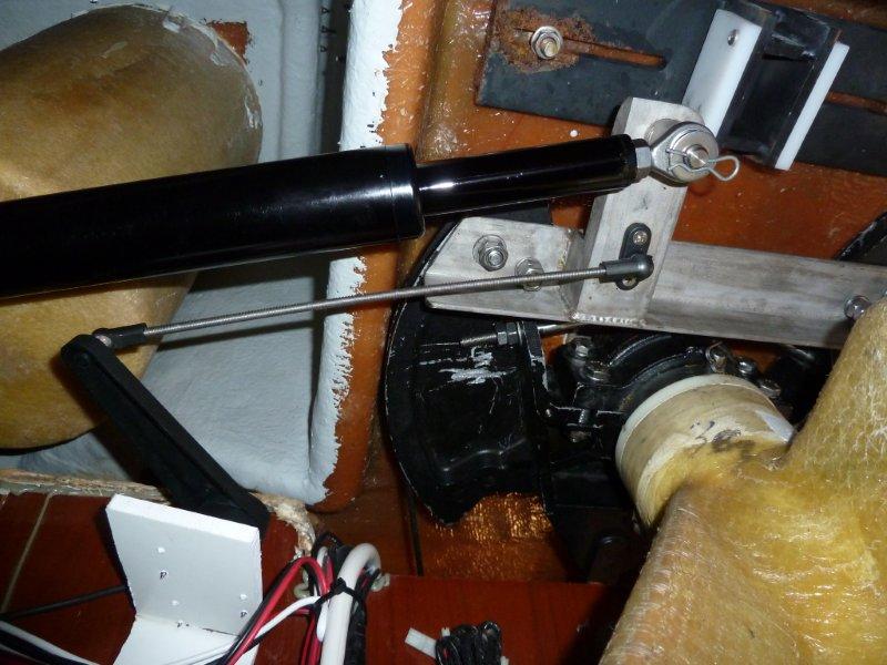

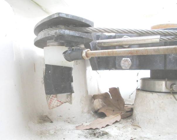

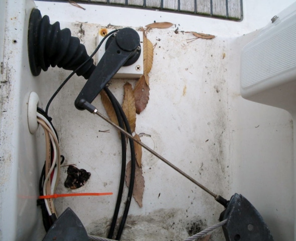

Understood. I was commenting on whomever said the sensor was not needed. On my Ray AP, at the bottom of the AP screen, it will show the rudder postion by little tick-marks. Otherwise, here is how my B323 (2006) was installed- by the dealer , i'm sure. I'd like to see Doug's "upside-down".

Much thanks for posting the photos of the rotary rudder transducer / sensor.
It is truly amazing to see the multitude of mounting configurations; many of which don't resemble the raymarine installation instructions & schematic.
1. with the rudder centered, the reference arm should be 90 degrees to the connecting bar
and the reference arm should be parallel to the rudder.
2. The connecting bar / rod should be a minimum length of 3" and maximum of 12".
3. The tiller (quadrant) toggle pin should be a minimum of 4" from the rudder shaft
and a maximum of 7.5"
(See the attached installation schematic)
With some of the installations that I have seen, makes me wonder what is being measured and is it really doing any good!

I had to brighten up pic 3 to show detail. The original installation allowed the arm to pop off that socket on the quadrant when the wheel went hard over too quickly. You can see in the pic that I put some hose over the quadrant's bumper to increase the bumper size/reduce wheel travel/stop ball and socket separation.
