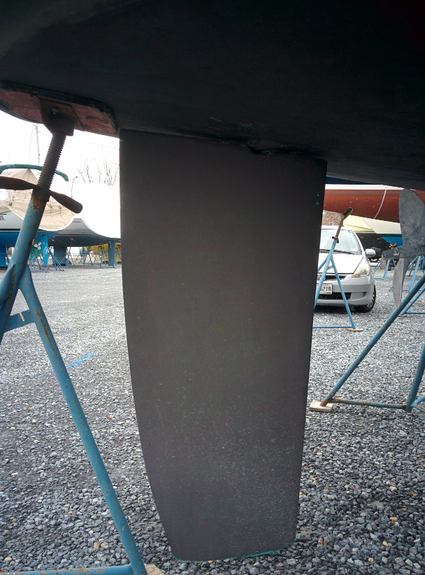

OK, here's what I got:
Height: Between 49 and 49.5"
Width at Top: 23.5"
Width in Middle: 22"
Width at Bottom: 15"
These aren't perfect measurements! Also, while the leading edge is fairly straight, the trailing edge has the curve reflected in the width differences. A picture is attached.
