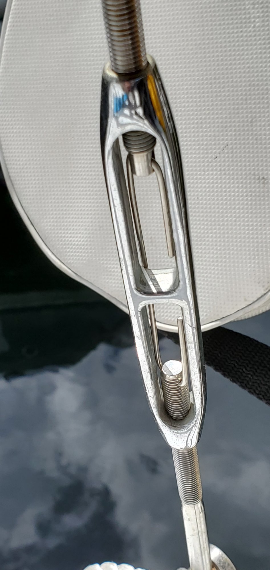

Alfa
Mar 19, 2015
38
Beneteau 31 North Vancouver
I use sst wire, easy to install and remove, reusable. Here, 1/16" dia, 316 sst TIG weldi
ng rod.
