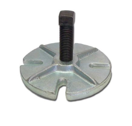

I have just bought a B323 and plan to install a new shaft sealer and therefore I will need to release the coupling from the shaft. I have a coupling pluller but could not find the shaft lock nut size. Does anubody know the nut / wrench size I will need?

My B411 shaft is 30mm diameter. The coupling nut thread is M14-2. Your shaft may be smaller. There isn't a lot of room. The responses I got here indicated that I needed to put the puller on and add tension to the puller. Then add heat. I heated to about 250-300 degrees and one good rap with an aluminum block hit with a hammer loosened it.

I have good puller that requires less room . My only issue is the wrench size.
