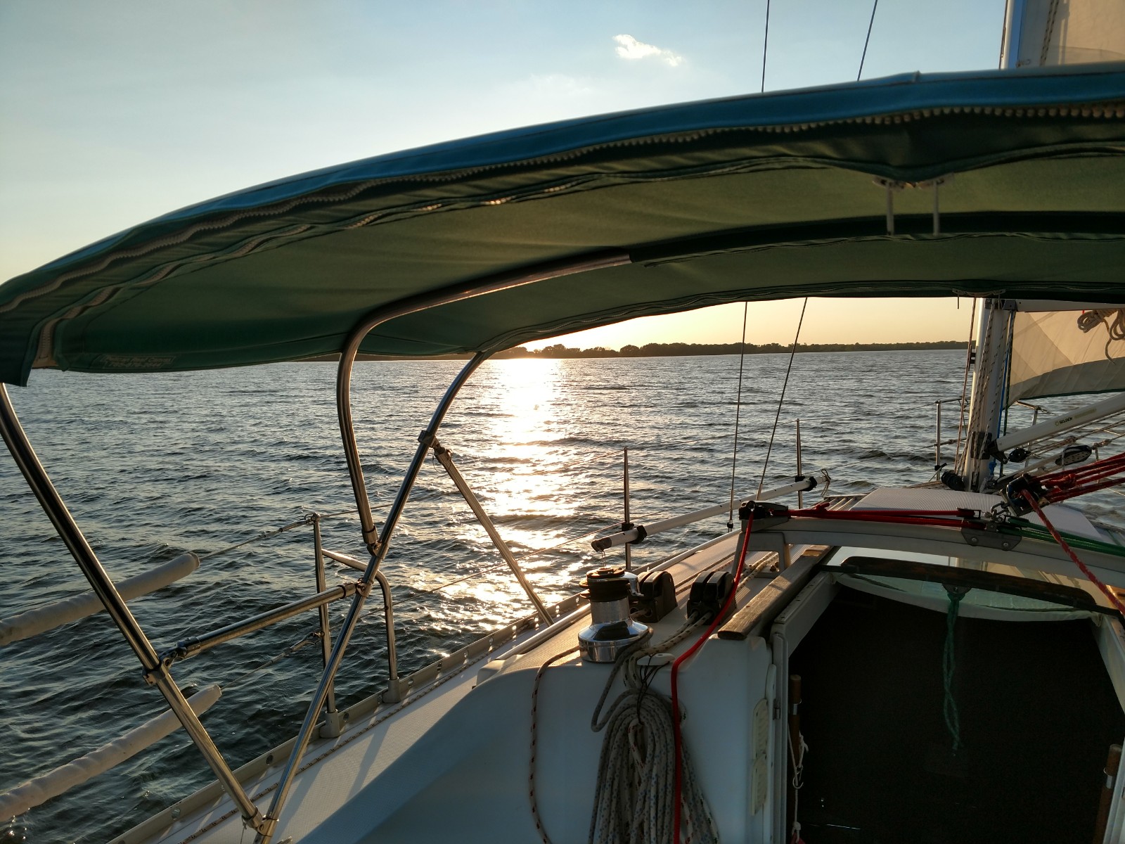

There were 2 concerns I had and I planned the whole bimini and dodger around them::: make the bimini low enough to clear the boom, but only high enough to clear the head of the tallest helmsman. 2nd, make it as wide as you can as the shade will be smaller and smaller as the sun sets. More as the need arises. Oh, Yeah... The rear bow is supported by two poles from the bow down to the top stern rail.

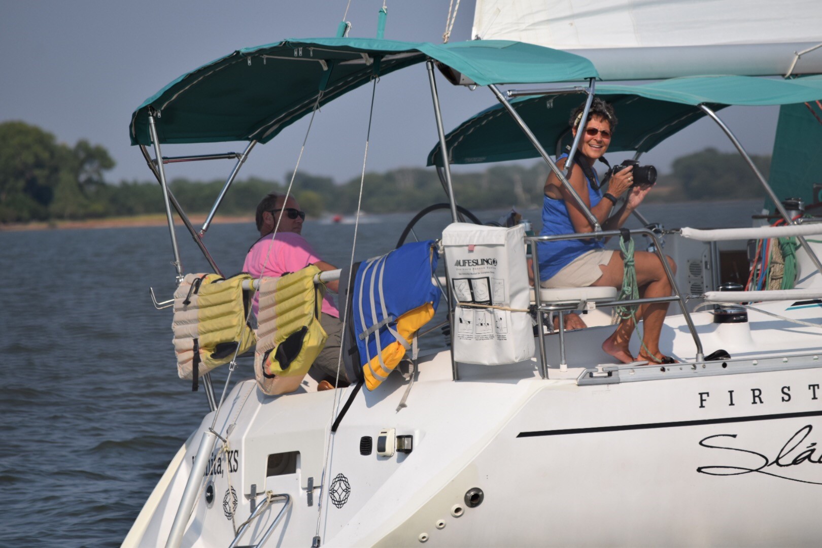

If you do not already have a frame, you might want to look at the configuration of mine. We have two frames. One on the stern rail and one forward. Cloth covers each and a third section of cloth can be zipped in between the two for complete coverage. I have a window in the aft cover so I can look up at the sail/masthead. The cloth sections also have zippers on the edges (sides and aft) so that a perforated piece of material can be zipped to them to provide shade when the sun is low but also allows visibility out (usually only use those at the dock). When racing, we remove the forward frame and cloth. I use quick release pins to hold it in place rather than screws/bolts.
