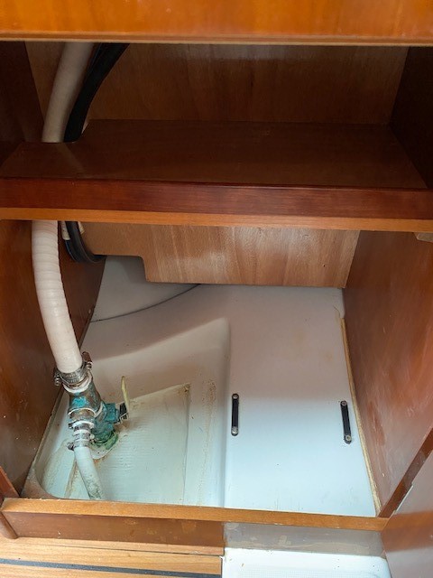

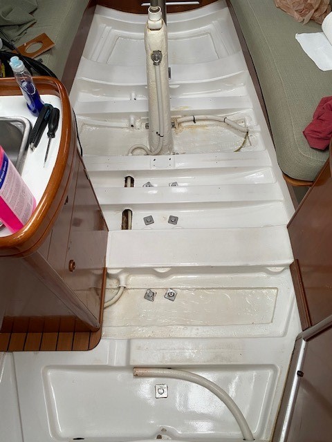

These two pictures will hopefully help you understanding what is going on with the sink drain on a swing keel B311.

It is as arranged above (in Eleven's pics). Pile of stuff on the seacock valve hiding it.Thanks, again for all of your posts.
