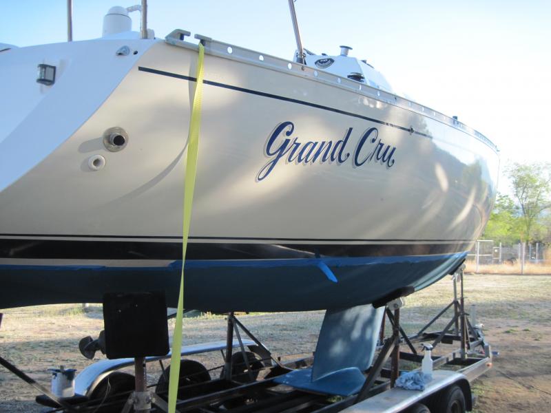

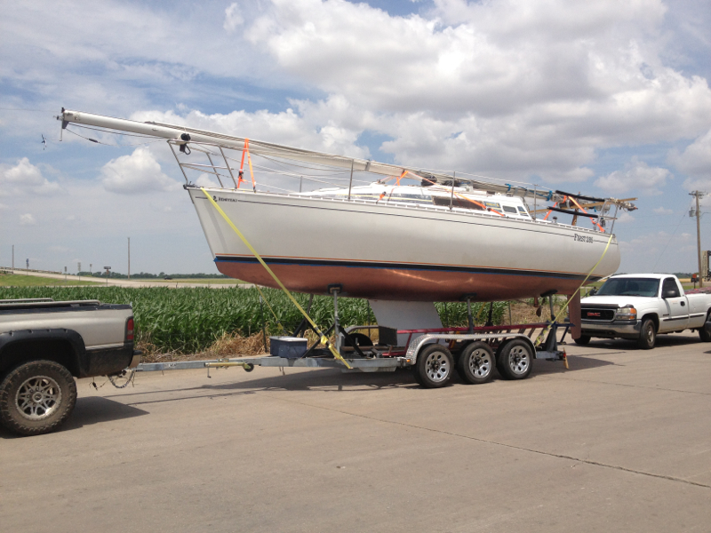

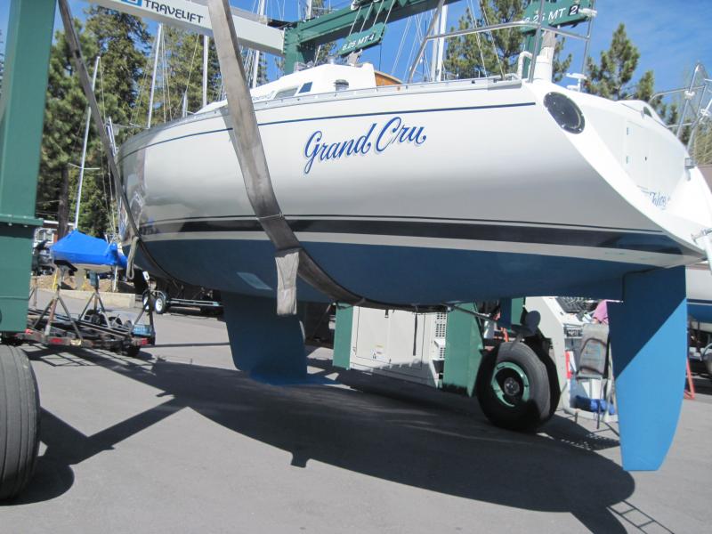

Our Beneteau 285 First plus trailer weigh nearly 10,000lb. I don't think I could possibly use a ramp to launch, much too heavy and cumbersome. We use a large hoist & fork lift to raise the mast, here in Lake Tahoe. The trailer in the photo looks much smaller than our 3 axle behemoth

Tri axle trailers I cannot figure out either, unless it's a stability thing. We have a horse trailer that's rated (with torsion axles mind you) for 16,000lbs, and it only has 2. In fact was looking at the "recommended upgrades" from Triad for their "heavy sailboats" line, and one was torsion axles. They typically put 5200lb axles on trailers this size, but had options for trailers much bigger with still only 2 axles. So Triad was erring on the side of a heavy 28 footer, by providing for roughly 9500lbs or so of load. I appreciate that kind of overkill... but just because the trailer says 10,000lbs, doesn't mean you are at the limit, and if you are even close, then you might wanna consider a bigger trailer.
So what's the scoop, not trying to say you are wrong, but has anyone thrown their rig on a scale, and what do these trailers weigh empty? My catalina Capri 25 trailer is right at 1000lbs, give or take 50. I think it was 940lbs wet when I pulled last year. Funny thing is my Capri 22 trailer weighed in at about 850lbs.
