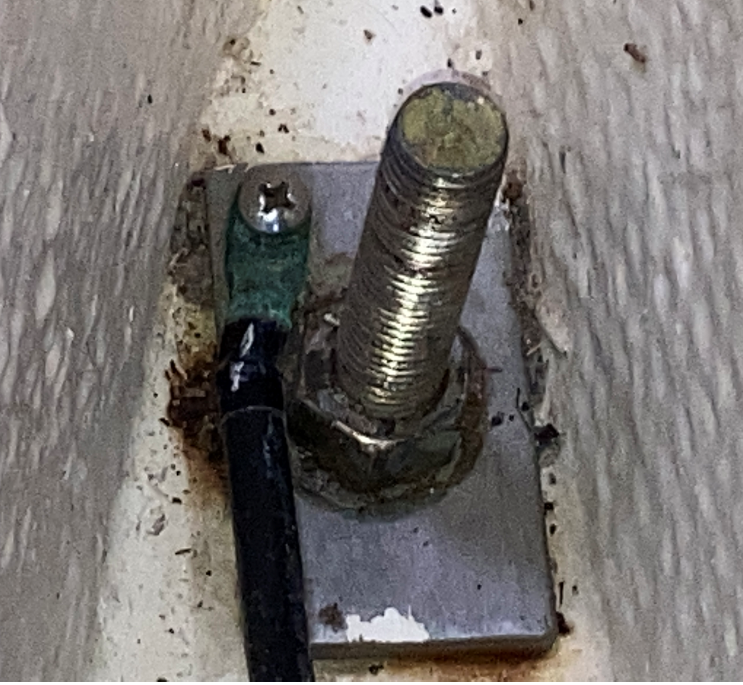

There are bolts instead of nuts, but I guess there is not a big difference.
Are you quite sure you are dealing with bolts rather than SS rods in the shape of a letter "J" which were placed in the molten lead casting?
I'd be concerned that water would have a chance of leaking into the bolt holes and then corroding the bolts in place without them necessarily being tight.

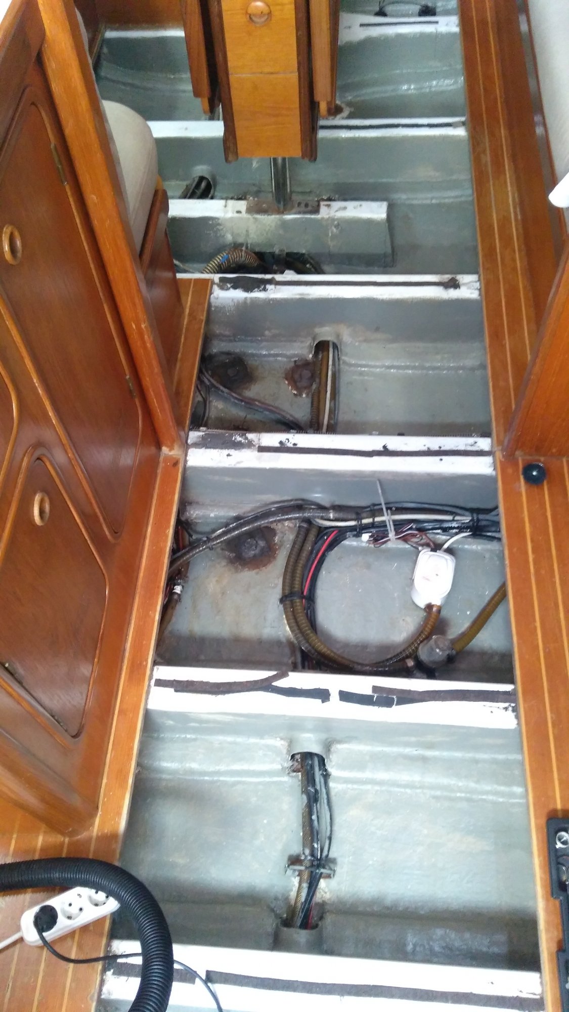

Jan 4, 2006
7,862
Wow ! 16 short bolt as oppose to a fewer number of heavy SS rods that go several feet into the lead keel. Quite likely equal in strength but could be problematic if not thoroughly sealed beneath the hull. These ones seem to have had no problems.

Yes, best to tighten keel bolts while on the hard and weight on the keel.
worst issue with those Bene keel bolts is corroded heads, and then stripping them. If yours were replaced recently, that should help.
