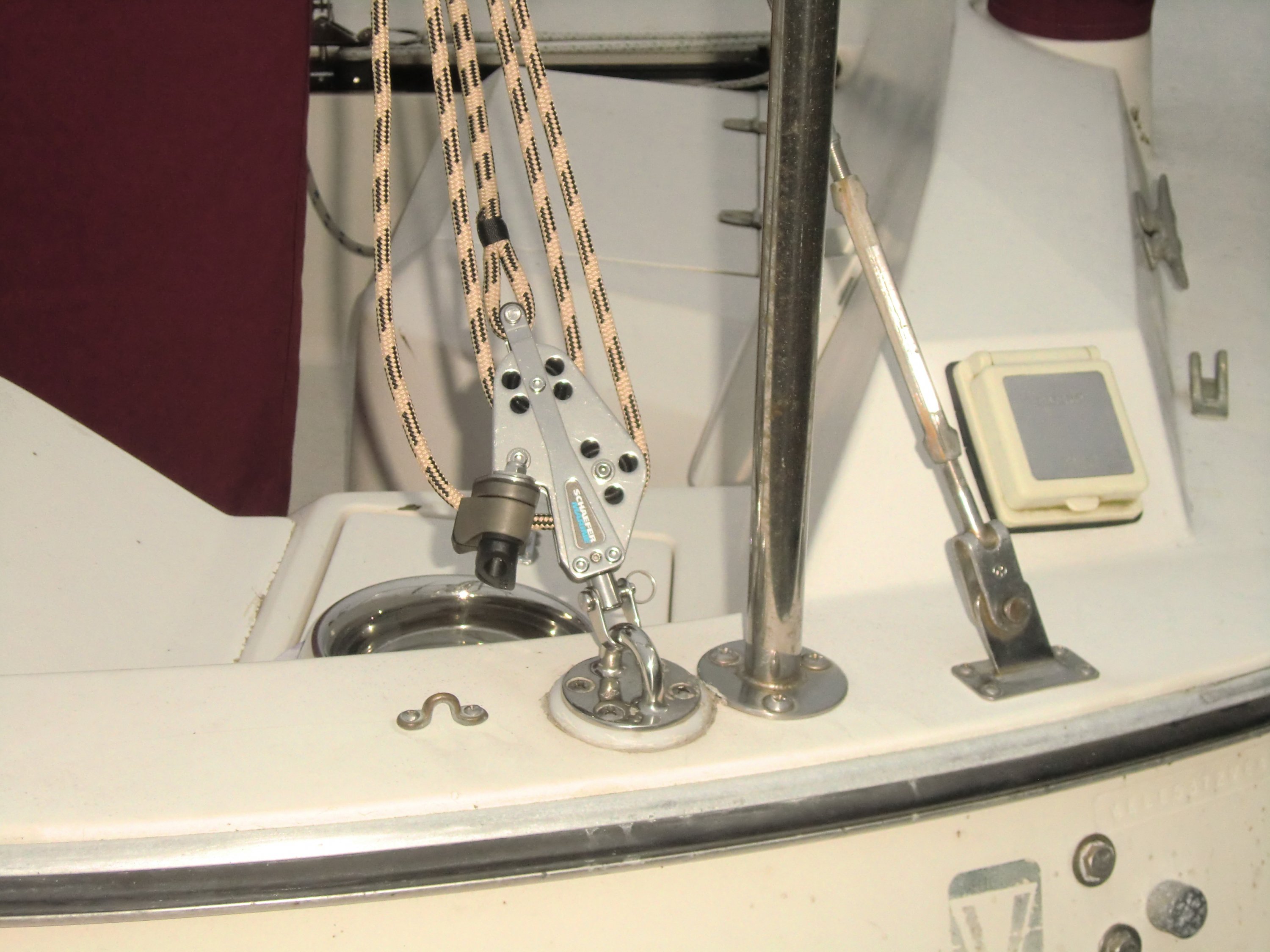

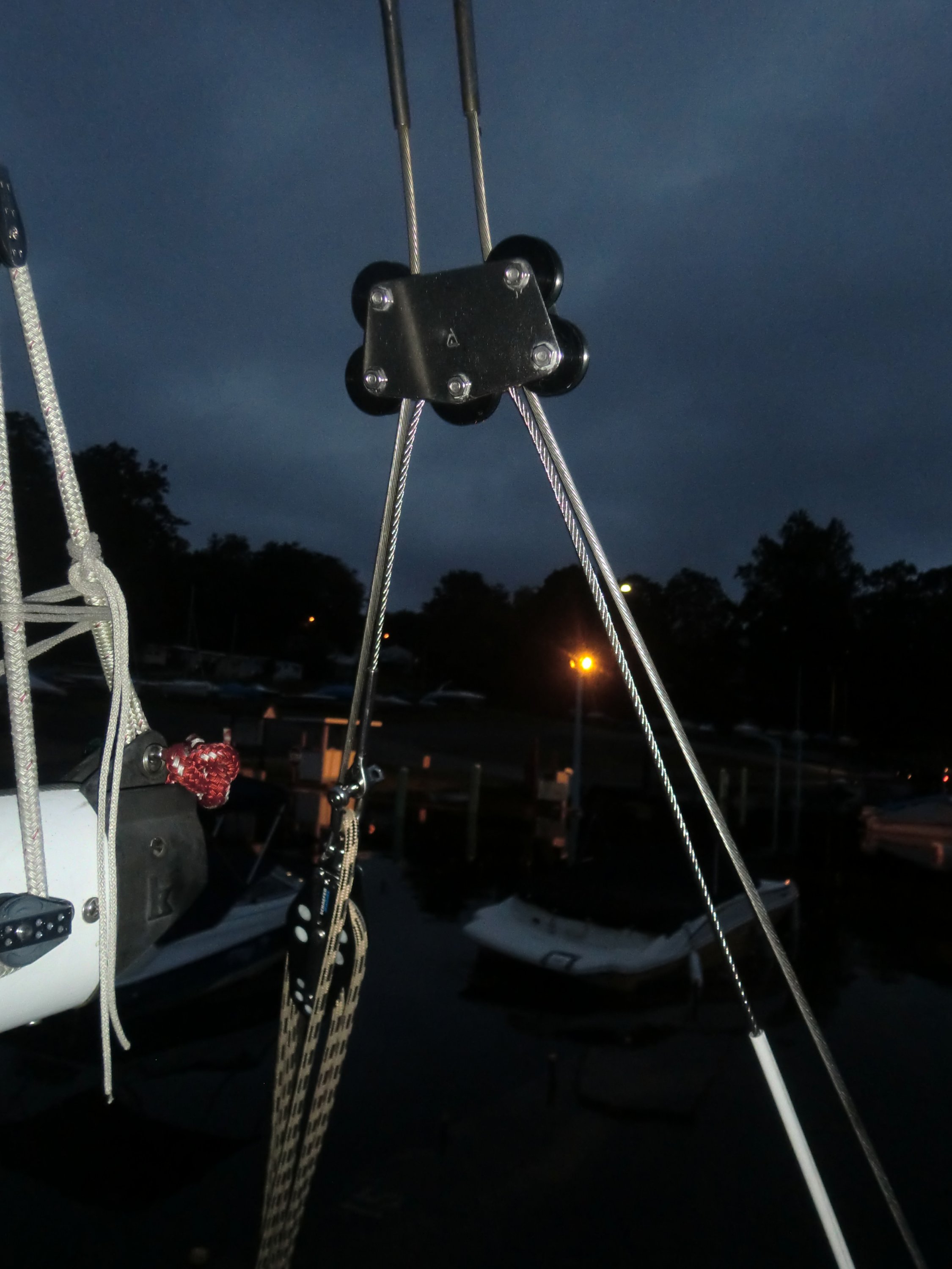

How would I choose a backstay aduster for my 1983 Hunter 31 with masthead B&R rig, and Split Backstay? I have seen other H31s with adjusters.
Oct 26, 2008
6,271
Catalina 320 Barnegat, NJ
Very easy install, just choose the parts you want. I did find that the Johnson split backstay fitting has too much friction. I might replace that part someday. The hardest part was crawling into the back to fit the backing plates for the deck-mounted fixtures.
