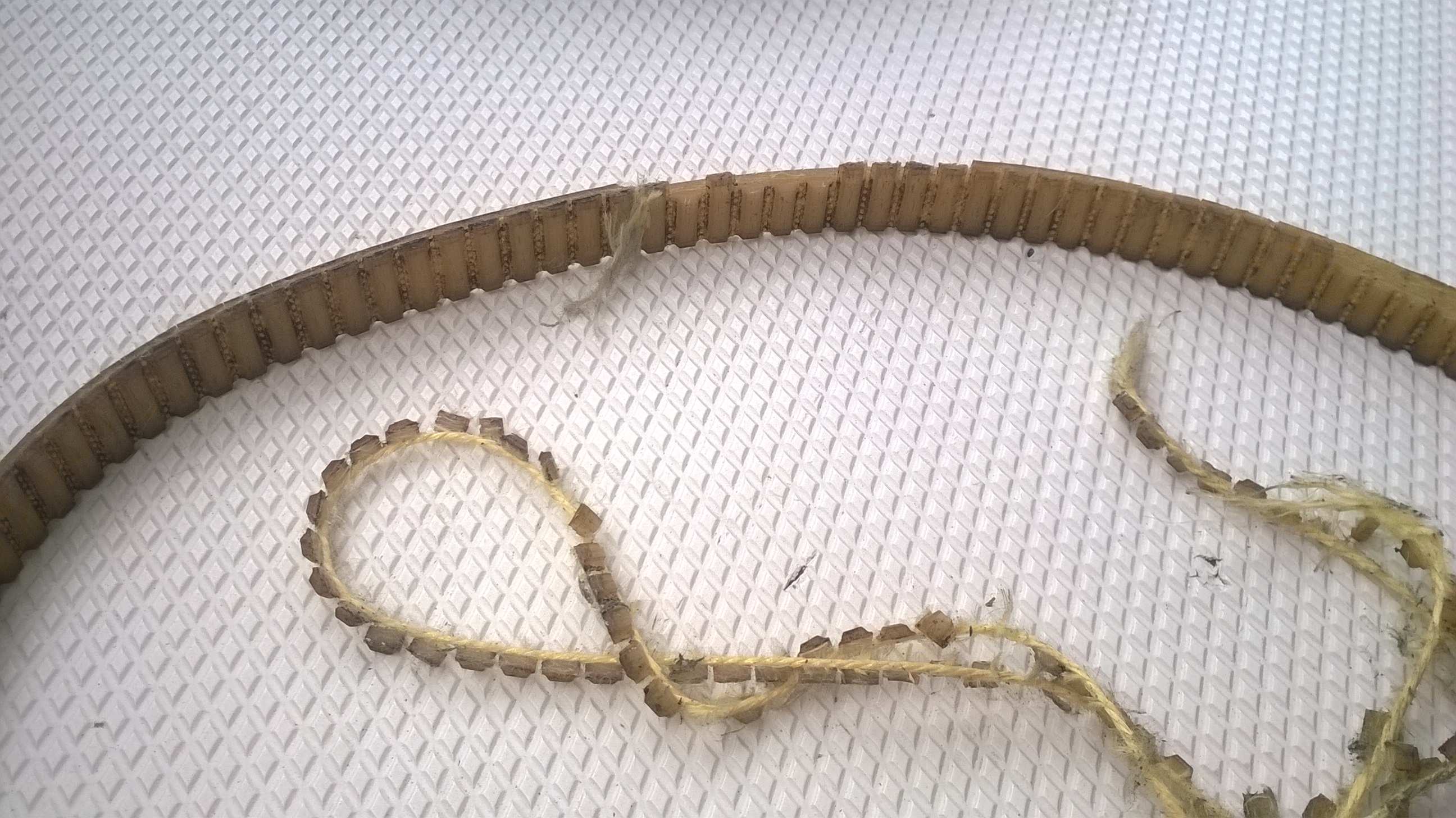

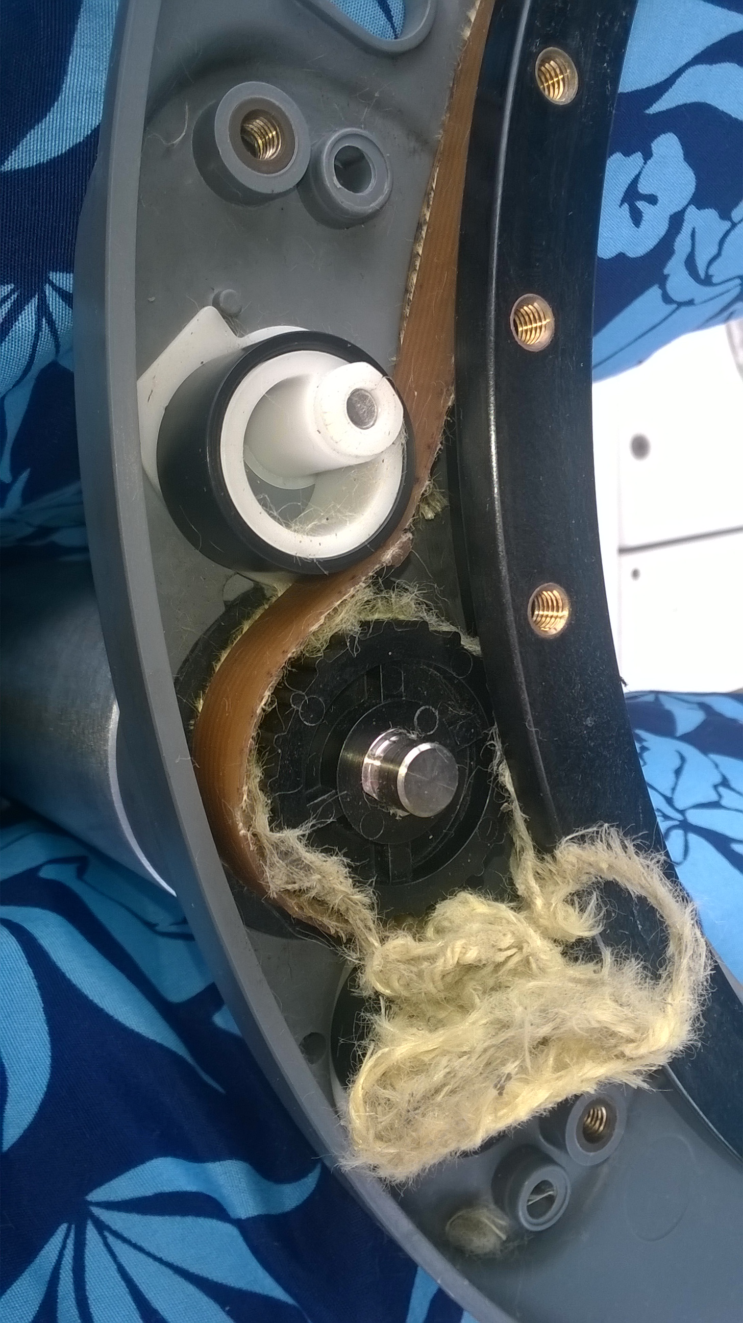

I'm sourcing 3rd party belt for my ST4000+ MK2 drive. Searching this forum reveals someone uses Ametric T5.750.9 750mm length but the original I ordered previously label Brecoflex 12AT5/875 which is supposedly 12mm width and 875mm in length. My boat is currently 500miles away. So could anyone with easy access to this Autopilot belt please measure and advise me the right width and length to use?
Much appreciated for your kind help.
Thank you.

Thanks, I was looking for lower cost alternative. Polybelt and beltingonline I've looked at. I came across synchroflex with embedded steel wire and an all rubber belt. Wonder if any of these will do.

I have a spare belt that I took off my ST4000 (not sure if it was a 4000+ or a 4000). I sold the wheel pilot itself when I replaced the wheel pilot with an internal rotary drive. It measures 750mm long and about 8.5mm to 9.0mm wide (I don't have my calipers with me right now). If your interested and it will fit I'll sell it to you for a song. I sent you a private email.

Looking online it seems the 750 mm belt is for the ST4000 with the black wheel cover. Does your's have a gray or a black cover? Doesn't look like it will work for you. Guess its important to know what color your wheel drive cover is to get the right part. Sorry. Maybe somebody else could use it.
