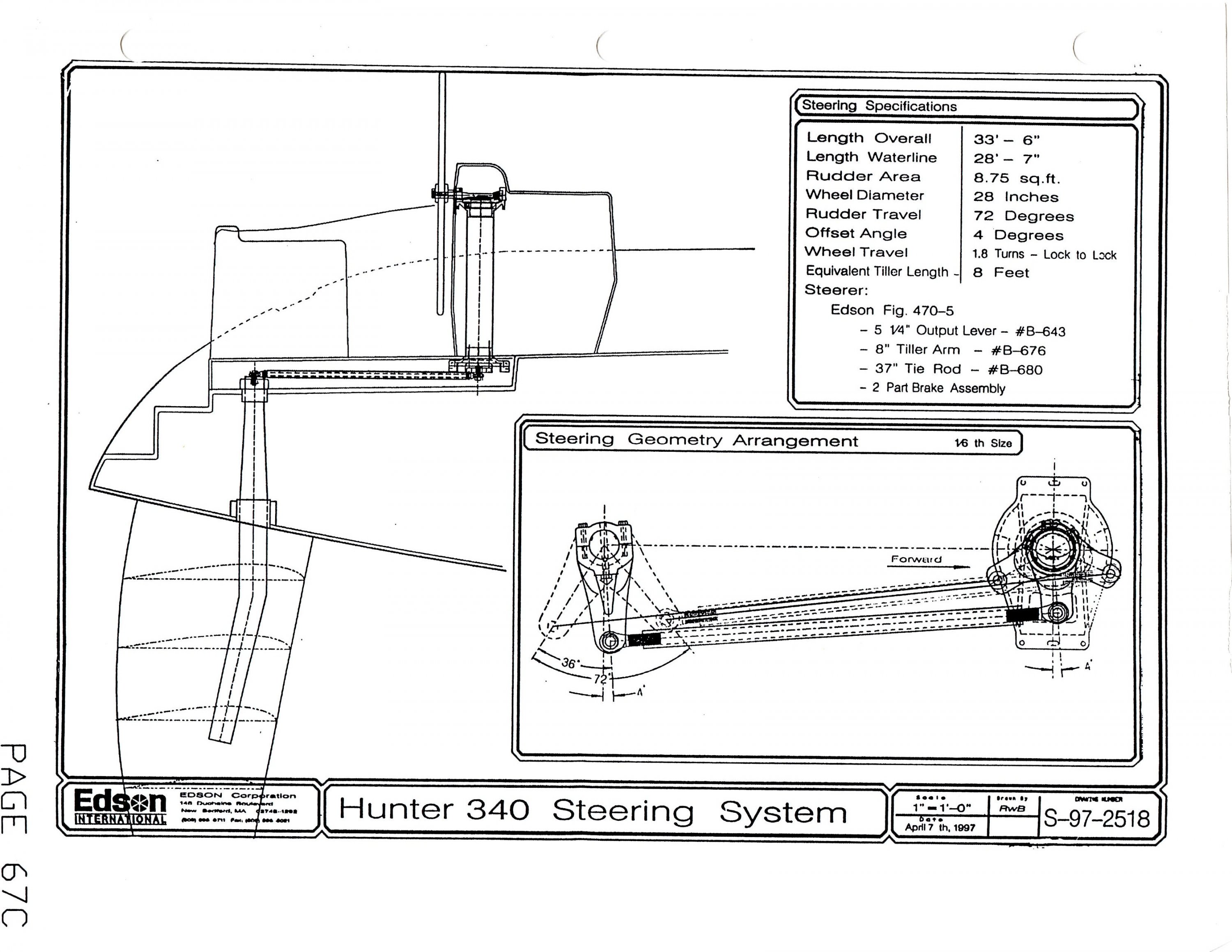

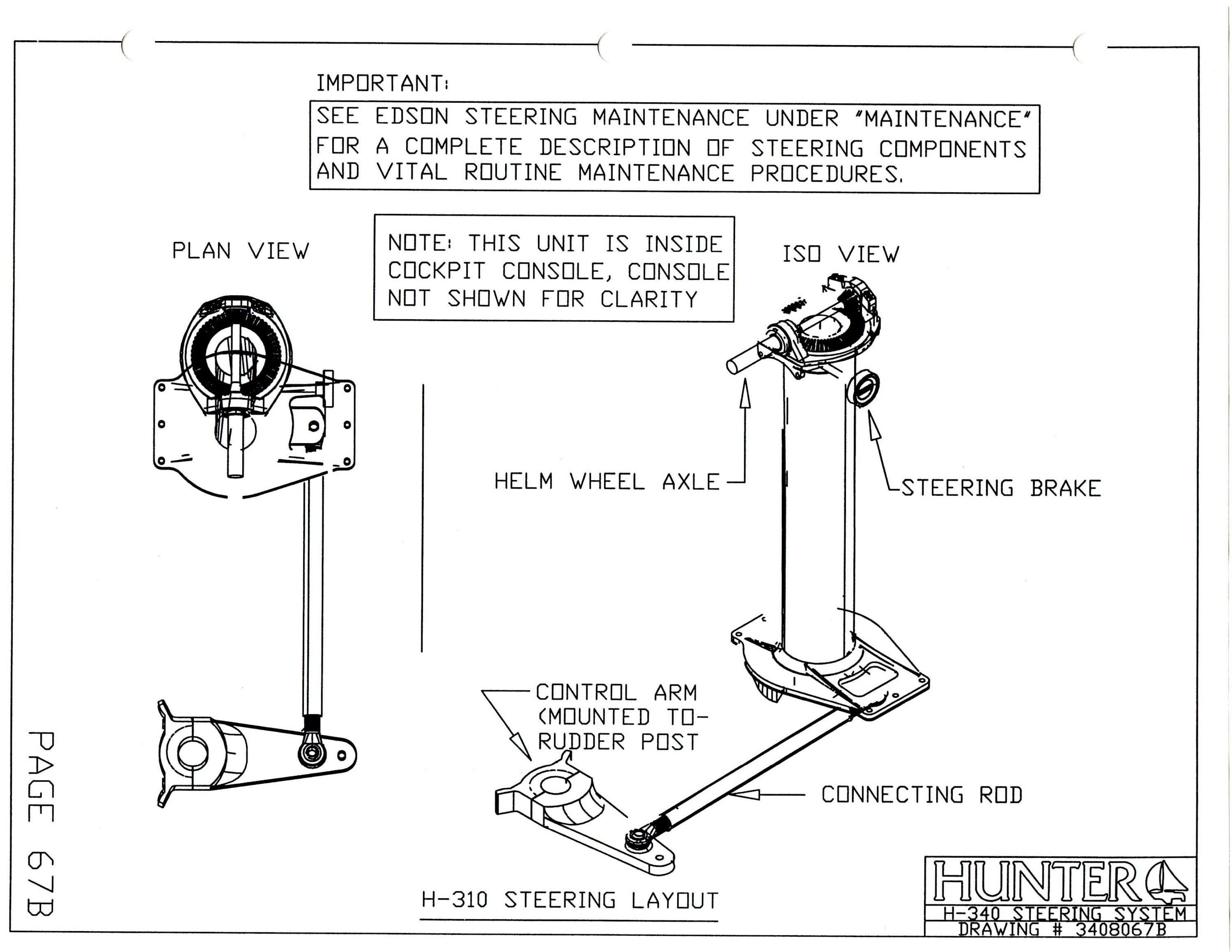

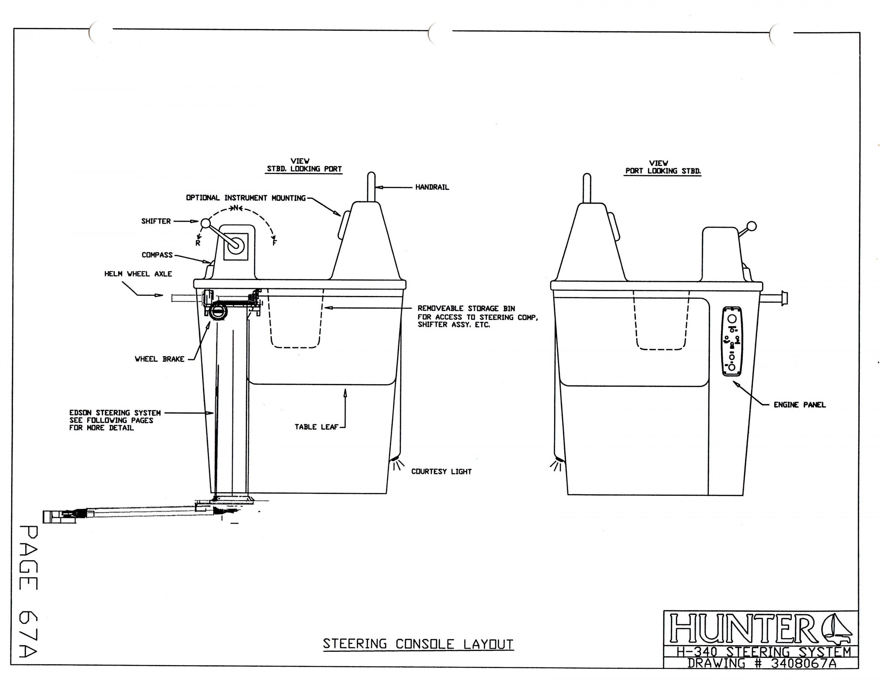

Steve, these pages from the owner's manual may help, but I don't have an autopilot

That looks like a very robust steering system. It looks like the wheel shaft might project though the buried Edson pedestal so that a sprocket can be fitted, and a rotary drive mounted inside the steering console.

That's the Edson rack and pinion system. Will a rotary drive work with that? I don't think the wheel shaft extends past the first gear on the shaft. I think you're going to have to attach a linear drive to the tiller arm. But it doesn't look like there is enough vertical space to do so under the cockpit floor. You may have to get a jefa dual arm tiller (the extra arm set pointing aft) and put a linear drive in one of the lazerettes.
EDIT:
Looking at Kloudies link it seems like there is a shaft extension so rotary would work.

So I have a 2000 Hunter 340 with the wheel pilot and I can say that while it works it isn't a very good solution. Basically the 340 (at least my model year) has a ridiculously oversized rudder which makes the wheel difficult to turn especially when the wind picks up. Wheel pilots don't have much "umph" so to speak so when the wind gets above 12 knots the autopilot becomes pretty useless unless you are going downwind. Needless to say I've also thought about a below decks unit but I know there is no easy way to place one. The boat uses rack and pinion for the steering (no cables) so I think people would normally use a liner drive system for that, but again definitely no room to place one without making a huge hole and likely having the end of the drive stick into the top of the aft cabin.
