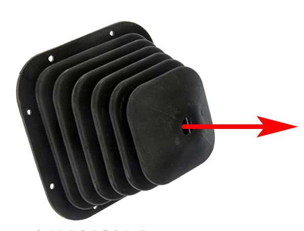

On a Hunter 38, the linear drive passes through the interior to the tiller arm under a deck plate in the cockpit. The interior is sealed from the exterior using a "seal boot". You can see in the Hunter documentation here: Link to manual
This isn't a Raymarine part as best I can tell, I looks kind of like an automotive manual transmission shifter boot.
Link to shifter boot on amazon
The boot stretched around the drive unit allows the drive to articulate but still keeps most of the moisture, spiders, etc from getting into the enclosed spaces.

The boot looks like the perfect solution regardless of where it's mounted as long as the vertical movement is sufficient for the travel of the tiller.
