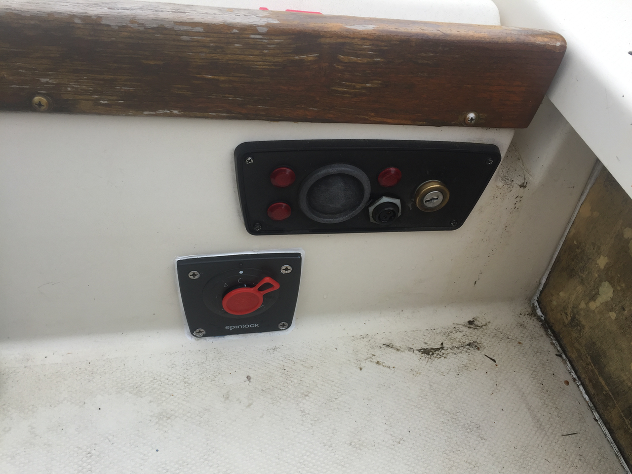

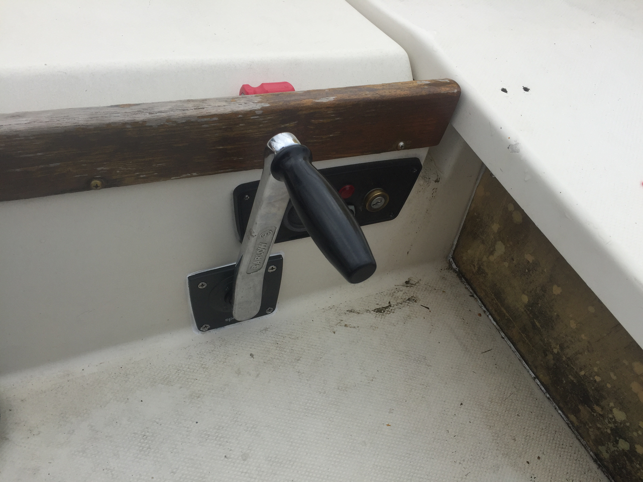

this is the only real modification I've made so far: the boat had dual-lever controls when I bought her, but I had a lot of trouble figuring it out and then the cable failed while approaching the Ballard locks; we had to send someone below and bellow command through the hatch!

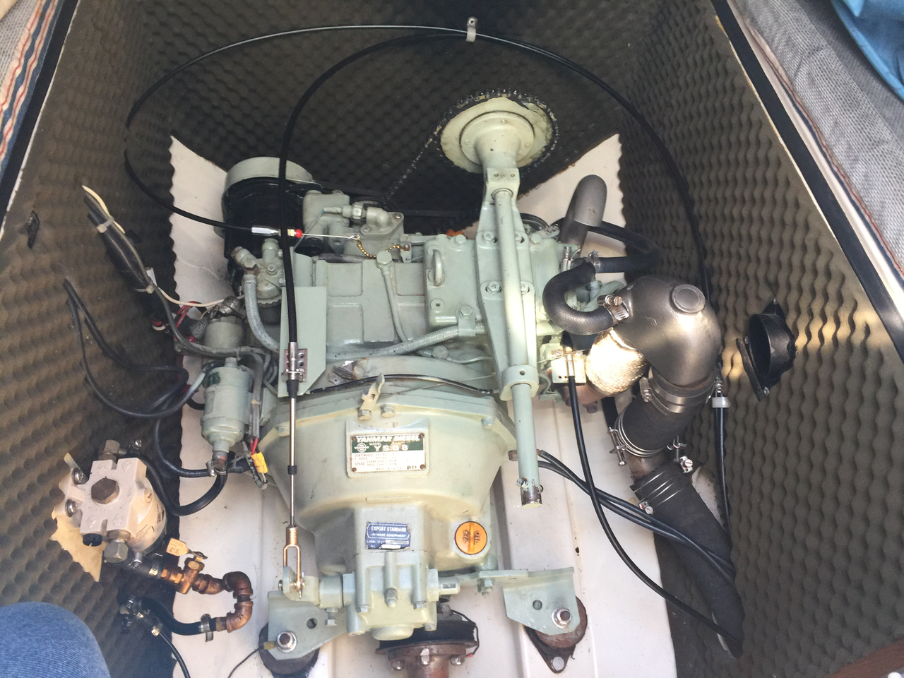

so I replaced the shift and throttle cables, and put a single-lever control with a flush mount adapter that takes a winch handle as a removable handle. i really like that feature - no more tangled mainsheets! the new quadrant & flush mount install was straightforward, but I had to change out the large-diameter shift cable for a small-diameter one as there are no single-lever controls available for the thicker shift cable. by the install manual the cable is overloaded, and shifting takes deliberate effort, but it does work with the small cable size. I had to fabricate a mount for the transmission cable but nothing fancy.
I also had to add a pull-to-stop system as the twin-lever control was previously used to kill the motor. again it's off-the-shelf cables from teleflex, acting on the governor to cut off fuel.
